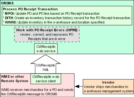

PO Receipt In information flow: This flowchart explains how PO receipt information is uploaded into Order Management System.

Purchase Order Receipt In Process
1.
The warehouse management system receives a partial or full receipt of a PO or PO line.
2.
For each PO line received, the warehouse management system sends a PO Receipt In XML Message (CWReceiptIn) to Order Management System via the CWReceiptIn Web Service.
Note: A separate PO Receipt In XML Message (CWReceiptIn) must be sent to Order Management System for each PO line received.
3.
The CWReceiptIn Web Service determines if the PO Receipt In XML Message (CWReceiptIn) is a valid XML message; see Invalid XML?.
4.
If the PO Receipt In XML Message (CWReceiptIn) is a valid XML message, Order Management System receives the PO Receipt In XML Message (CWReceiptIn) from the warehouse management system, and:
• Determines the PO to receive; see Determining the Purchase Order to Receive.
• Determines the item/SKU to receive; see Determining the Item and SKU to Receive.
• Determines the quantity of the item/SKU to receive; see Determining the Quantity to Receive.
• Determines the location and warehouse where the item/SKU should be placed; see Determining the Receipt Warehouse and Location.
5.
If Order Management System successfully processes the PO Receipt In XML Message (CWReceiptIn), the system updates the PO and the inventory information in the location and warehouse where the item/SKU was placed. See Successful PO Receipts.
If Order Management System cannot successfully process the PO Receipt In XML Message (CWReceiptIn), the system places the message in an error status. See Failed PO Receipts.

The system:
• Updates the PO line:
- Decreases the Quantity due by the receipt quantity.
- Increases the Quantity received by the receipt quantity.
- Updates the status of the PO line to Closed if the entire quantity on the line has been received.
• Updates the status of the PO to Closed if there is no more merchandise to receive.
• Creates an inventory transaction history record for the PO Receipt transaction.
• Increases the on-hand quantity in the receipt item warehouse and item location.
• Decreases the on-order quantity for the warehouse on the PO.
• Recalculates the average cost.

Failed PO Receipts
If the PO Receipt In XML Message (CWReceiptIn) received from the warehouse management system includes invalid or missing data, Order Management System does not process the PO Receipt and does not perform any updates to the PO, item warehouse, or item location.
In addition, the system creates a record in the PO Receipt Error table. You can review, correct, and reprocess PO receipt errors in the Working with PO Receipt Errors (WPRE) menu option. See Failed PO Receipts for a list of errors.
Note: If you do not see the failed PO Receipt in the Working with PO Receipt Errors (WPRE) menu option, it could be that the error occurred before the PO Receipt was received into Order Management System, such as an invalid XML error. See Troubleshooting the Purchase Order Receipt In API.
