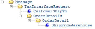

TaxInterfaceRequest

CustomerShipTo

OrderDetail

ShipFromWarehouse
ship_from_warehouse

Tax Request Message: Sample XML
A sample of the Tax Request Message: Sample XML is presented below.
<Message time_created="05:56:37" date_created="2017-09-14" type=" " target="CWIntegrate" source="CWDirect">
<TaxInterfaceRequest sold_to_cust_class="" order_date="2017-09-14" order_shipto_nbr="001" order_nbr="00000270" company="076" request_type="QUOTATION">
<CustomerShipTo ship_to_country="US" ship_to_postal="01581" ship_to_state="MA" ship_to_city="WESTBORO" ship_to_addr1="1800 WEST PARK DRIVE"/>
<OrderDetails>
<OrderDetail odt_extended_price="000002250" odt_tax_override_amt="0000000000" odt_price="0002250" odt_qty="00001" odt_long_SKU_class="0100" odt_long_SKU_dept="0100" odt_arrival_date="2017-09-14" odt_item="GLASSWARE" odt_line_item_type="LM" odt_line_nbr="00001">
<ShipFromWarehouse ship_from_country="US" ship_from_postal="01701" ship_from_state="MA" ship_from_city="FRAMINGHAM" ship_from_addr1="100 MAIN STREET" ship_from_warehouse="001"/>
</OrderDetail>
<OrderDetail odt_extended_price="000001565" odt_tax_override_amt="0000000000" odt_price="0001565" odt_qty="00001" odt_arrival_date="2017-09-14" odt_item="GLASSWARE" odt_line_item_type="LD" odt_line_nbr="00001" odt_item_class="LD">
</OrderDetail>
</OrderDetails>
</TaxInterfaceRequest>
</Message>

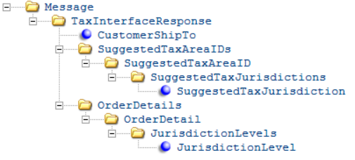

Tax Response Message (CWTaxResponse)
The tax response message contains calculated tax from an external tax system.
Generated when? The system generates this message as a response to a Tax Request Message (CWTaxRequest).
For more information: See:
Generic Tax API for an overview.
Tax Request Message: Sample XML for a sample message.
XML Messages for a sample of the DTD, schema, and generic sample XML of the Tax Request XML message.

TaxInterfaceResponse
request_type
alpha
Identifies the type of tax request.
Until you bill a shipment or credit, the tax totals on an order might change; so, during order entry, order maintenance, and pick slip preparation, the system sends a QUOTATION request. Sending the INVOICE tax interface request indicates that the tax totals in the response message will be billed.
Valid values are:
QUOTATION = tax requested during order creation and pick slip generation.
INVOICE = tax requested during billing. If the Send Tax to Tax Interface as Quote Not Invoice (L11) system control value is selected, the system sends a QUOTATION request type instead of an INVOICE request type.
DISTRIBUTETAX = tax overridden through the Order API. If the Send Tax to Tax Interface as Quote Not Invoice (L11) system control value is selected, the system sends a QUOTATION request type instead of a DISTRIBUTETAX request type.
company
numeric
3
The company code associated with the order.
Corresponds to the Company in the Order Ship To table.
entity
numeric
3
The entity associated with the division defined for the source code on the order.
Corresponds to the Entity Number in the Division table.
order_nbr
numeric
8
The order number requesting tax.
Corresponds to the Order # in the Order Ship To table.
order_shipto_nbr
numeric
3
The ship to number on the order requesting tax.
Corresponds to the Ship To # in the Order Ship To table.
tax_type
alpha
2
The type of charge to which tax is applied.
LM = line merchandise
LH = line handling
LF = line freight (if the order uses a line-level freight method)
OF = order freight (if the order uses an order-level freight method)
AF = additional freight
tax_area_ID
order_addl_charge_seq
numeric
2
The order additional charge sequence number associated with the charge.
Corresponds to the OAC Seq # in the Order Additional Charge table.
lookup_result
CustomerShipTo
ship_to_addr1
alpha
32
The street address for the ship to customer.
Corresponds to the:
• Order ship to: NAM street address in the Order Ship To Address table.
• Permanent ship to: NAM street address in the Customer Ship To table.
• Recipient sold to: NAM street address in the Customer Sold To table.
ship_to_addr2
alpha
32
The second address line on the ship to customer’s address.
Corresponds to the:
• Order ship to: NAM address line 2 in the Order Ship To Address table.
• Permanent ship to: NAM address line 2 in the Customer Ship To table.
• Recipient sold to: NAM address line 2 in the Customer Sold To table.
ship_to_addr3
alpha
32
The third address line on the ship to customer’s address.
Corresponds to the:
• Order ship to: Address line 3 in the Order Ship To Address table.
• Permanent ship to: Address line 3 in the Customer Ship To Extended table.
• Recipient sold to: Address line 3 in the Customer Sold To Extended table.
ship_to_addr4
alpha
32
The fourth address line on the ship to customer’s address.
Corresponds to the:
• Order ship to: Address line 4 in the Order Ship To Address table.
• Permanent ship to: Address line 4 in the Customer Ship To Extended table.
• Recipient sold to: Address line 4 in the Customer Sold To Extended table.
ship_to_city
alpha
25
The city on the ship to customer’s address.
Corresponds to the:
• Order ship to: NAM city in the Order Ship To Address table.
• Permanent ship to: NAM city in the Customer Ship To table.
• Recipient sold to: NAM city in the Customer Sold To table.
ship_to_state
alpha
2
The state on the ship to customer’s address.
Corresponds to the:
• Order ship to: NAM state in the Order Ship To Address table.
• Permanent ship to: NAM state in the Customer Ship To table.
• Recipient sold to: NAM state in the Customer Sold To table.
ship_to_state_name
alpha
25
The name of the state.
Corresponds to the Description in the State table.
ship_to_postal
alpha
10
The postal code on the ship to customer’s address.
Corresponds to the:
• Order ship to: NAM zip in the Order Ship To Address table.
• Permanent ship to: NAM zip in the Customer Ship To table.
• Recipient sold to: NAM zip in the Customer Sold To table.
ship_to_country
alpha
3
The country on the ship to customer’s address.
Corresponds to the:
• Order ship to: RPR country in the Order Ship To Address table.
• Permanent ship to: RPR country in the Customer Ship To table.
• Recipient sold to: RPR country in the Customer Sold To table.
ship_to_country_name
alpha
30
The name of the country.
Corresponds to the Description in the Country table.
SuggestedTaxAreaID
suggested_tax_area_ID
OrderDetail
odt_line_nbr
numeric
3
The order detail line number.
Corresponds to the Line # in the Order Detail table.
odt_line_item_type
alpha
2
LH = line handling
odt_total_tax_amt
numeric
10.5
The total tax amount on the order line.
Corresponds to the Tax in the Order Detail table.
odt_total_tax_rate
numeric
5.2
The tax rate used to calculate tax for the order line.
SuggestedTaxJurisdiction
suggested_tax_jurisdiction
alpha
10
The tax jurisdiction the tax system suggests for the order line.
suggested_tax_jurisdiction_desc
alpha
30
The description of the tax jurisdiction.
suggested_tax_effective_date
numeric
8
The date the suggested tax becomes effective.
suggested_tax_expiration_date
numeric
8
The date the suggested tax expires.
JurisdictionLevel
jurisdiction_level
alpha
The tax jurisdiction level.
Valid values are:
• Country
• Composite
• State
• Country
• City
• Special
jurisdiction_level_desc
alpha
A description of the tax jurisdiction level.
jurisdiction_level_tax_amt
numeric
10.5
The tax amount for the jurisdiction level.
jurisdiction_level_tax_rate
numeric
5.2
The tax rate for the jurisdiction level.
Tax Response Message: Sample XML
<Message date_created="Thu Sep 14 00:00:00 PDT 2017" type="CWTaxResponse" target="OROMS" source="Avalara">
<TaxInterfaceResponse order_addl_charge_seq="" tax_type="SalesOrder" order_shipto_nbr="1" order_nbr="270" entity="" company="76" request_type="QUOTATION">
<OrderDetails>
<OrderDetail odt_total_tax_rate="625" odt_total_tax_amt="141" odt_line_item_type="LM" odt_line_nbr="00001">
<JurisdictionLevels>
<JurisdictionLevel jurisdiction_level_tax_rate="625" jurisdiction_level_tax_amt="141000" jurisdiction_level_desc="MASSACHUSETTS" jurisdiction_level="STATE"/>
</JurisdictionLevels>
</OrderDetail>
<OrderDetail odt_total_tax_rate="625" odt_total_tax_amt="98" odt_line_item_type="LD" odt_line_nbr="00001">
<JurisdictionLevel jurisdiction_level_tax_rate="625" jurisdiction_level_tax_amt="98000" jurisdiction_level_desc="MASSACHUSETTS" jurisdiction_level="STATE"/>
</OrderDetail>
</OrderDetails>
</TaxInterfaceResponse>
</Message>
