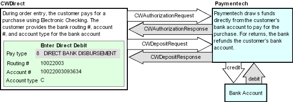

Electronic check processing illustration:
In Regular Order Entry: When you add a direct bank disbursement pay type to an order, the system displays the Enter Direct Debit For Window (Direct Bank Disbursement Payment Type), which requires the routing number and account number of the customer’s bank account.
In addition, if the Require account type field for the direct disbursement pay type is set to Y, the system requires you to define the type of bank account from which the funds are withdrawn. Valid bank account types are:
• C personal checking bank account
• S personal savings bank account
• X corporate checking bank account
A credit card number is not relevant for a direct bank disbursement pay type, so the system defaults the Description of the direct bank disbursement pay type to the Credit card number field.
During Authorizations: During authorization processing (online or batch), the system generates the Authorization Request XML Message (CWAuthorizationRequest) to send to Paymentech.
Paymentech authorizes the electronic check payment against the funds in the customer’s bank account.
During Deposits: During deposits processing, the system generates the Deposit Request XML Message (CWDepositRequest) to send to Paymentech.
When the CWDepositResponse is received from Paymentech and the deposit is confirmed, the system processes the electronic check. When you process deposits for an order containing a direct bank disbursement, the system:
