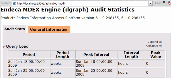

/admin?op=audit
returns the MDEX Engine Auditing
page.
The MDEX Engine Auditing page lets you view the aggregate Dgraph metrics over time. It provides the output of XML reports that track ongoing usage statistics. These statistics persist through process restarts. This data can be used to verify compliance with licensing terms, and is also useful for tracking product usage.
Note
For details about the MDEX Engine Auditing page, see the Performance Tuning Guide.

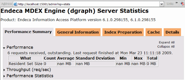

/admin?op=stats
Statistics page.
The MDEX Engine Statistics page provides a detailed breakdown of what the Dgraph is doing, and is a useful source of information about your Endeca implementation’s configuration and performance. It provides information such as startup time, last data indexing time, and indexing data path. This lets you focus your tuning and load-balancing efforts. By examining this page, you can see where the Dgraph is spending its time. Begin your tuning efforts by identifying the features on the Details tab Hotspots section with the highest totals.
Note
For details about the MDEX Engine Statistics page, see the Performance Tuning Guide.
