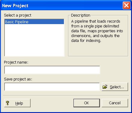

When creating a new project using the Oracle Commerce Developer Studio, you are prompted with the following dialog box:
To create a new project:
In order for a new pipeline to be run properly within the deployment template, the following must be properly specified:

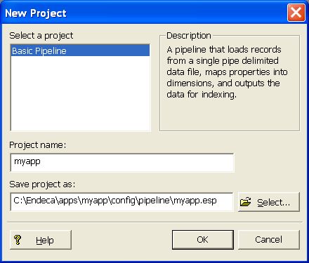

The Project Name field must be the same as the data prefix specified for the "
app" element in<app dir>/config/script/AppConfig.xml. By default, this data prefix will have been set to the name of the application that was specified when runningdeploy.batordeploy.sh.Recall that the
[appname]specified was also used to create the base<app dir>directory. For example, if "myapp" was supplied as the[appname], and "c:\Endeca\apps" was supplied as the Deployment Directory, then<app dir>would bec:\Endeca\apps\myapp. In this example, the Project Name should also be specified as "myapp".
The Save Project As field should be
<app dir>\config\pipeline\[appname].espIn the example above, the Save Project As field would be
c:\Endeca\apps\myapp\config\pipeline\myapp.esp.
