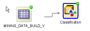

Assume that a workflow is exported from the account DMUSER and contains the Data Source node with data MINING_DATA_BUILD.
If you import the schema into a different account, that is, an account that is not DMUSER, and try to run the workflow, then the Data Source node fails because the workflow looks for DMUSER.MINING_DATA_BUILD_V.
To resolve this issue:
  1. Right-click the Data Source node MINING_DATA_BUILD_V and select Define Data Wizard.
    A message appears indicating that DMUSER.MINING_DATA_BUILD_V does not exist in the available tables or views.
  2. Click OK and select MINING_DATA_BUILD_V in the current account. This resolves the issue.

Link Nodes
Each link connects a source node to a target node.
A workflow is a directional graph. That is, it consists of nodes that are connected in order. To create a workflow, you connect or link nodes. When you connect two nodes, you indicate a relationship between the nodes. For example, to specify the data for a model build, link a Data Source node to a Model Build node.
You can link nodes, delete links, and cancel links using the following options:
Linking Nodes in Components Pane
You can connect two or more nodes by using the Linking nodes option.
To connect two nodes using the Linking Nodes option:
  1. In the Components pane, expand the Linking Nodes section.
  2. Click Link. Move the cursor to the source node and click. From the source node, drag the link that appears to the target node, and click again.
    • If the link is valid, then clicking the target node creates the link.
    • If the link is invalid, then the line does not terminate. To end the link process without completing a link, either press ESC or click in the Components pane.
Node Connection Dialog Box
To link two nodes using the Node Connection dialog box:
  2. Click the Link icon and press ENTER. This opens the Select Source And Destination For A New Link dialog box.
  3. Select the source node in the Source List and the target node in the Destination List.
    The Source List lists all the nodes in the workflow. The Destination List lists the allowed target nodes for the selected node.
  4. Click OK.

To copy and paste nodes:
  1. Select the nodes to copy. To select several nodes, hold down the Ctrl key when you click the nodes.
    The selected node is highlighted. In this example Classification is selected. The other node is not selected.
    copy
  2. Right-click and select Copy from the context menu. Alternately, you can press Ctrl+C to copy the selected nodes.
Copying and pasting nodes do not carry any mining models or results from the original node.
