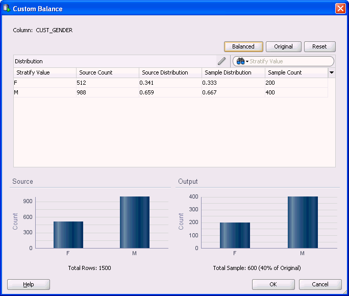

The Custom Balance dialog box enables you to specify exactly how the selected column is balanced.
You must run the node to collect statistics before you create custom balance. After you run the node, edit it, select Custom Distribution, and click View. The Custom Balance dialog opens:
You can either create custom entries for each value of the stratify attribute, or you can click Original or Balanced to provide a starting point. You can click Reset to reset to the original values.
To create a custom value, select the attribute to change and click
Change the value in the Sample Count column to the custom value. Press Enter. The new sample is displayed as output in the lower part of the screen. Change as many values as required. Click OK when you have finished.
