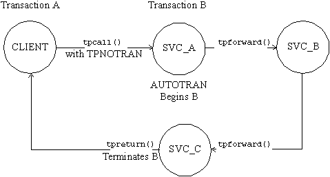

Called Service in Different Transaction with AUTOTRAN Set
If you issue a communication call with the TPNOTRAN flag set and the called service is configured such that a transaction automatically starts when the service is called, the system places both the calling and called processes in transaction mode, but the two constitute different transactions. In this situation, the following facts apply:
tpreturn() plays the initiator’s transaction role: it terminates the transaction in the service in which the transaction was automatically started. Alternatively, if the transaction is automatically started in a service that terminates with tpforward(), the tpreturn() call issued in the last service in the forward chain plays the initiator’s transaction role: it terminates the transaction. (For an example, refer to the figure called “Transaction Roles of tpforward( ) and tpreturn() with AUTOTRAN” on page 11‑39.)
Because it is in transaction mode, tpreturn() is vulnerable to the failure of any participant in the transaction, as well as to transaction timeouts. In this scenario, the system is more likely to return a failed message.
Figure 11‑1 Transaction Roles of tpforward( ) and tpreturn() with AUTOTRAN
