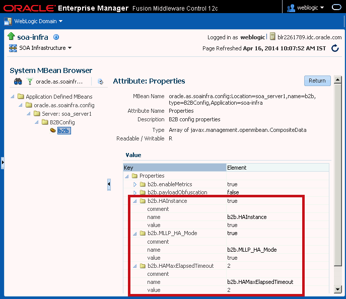

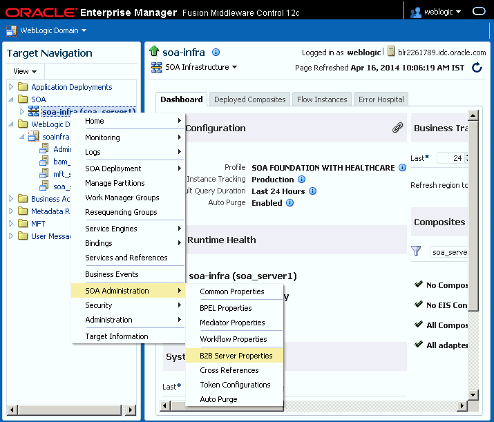

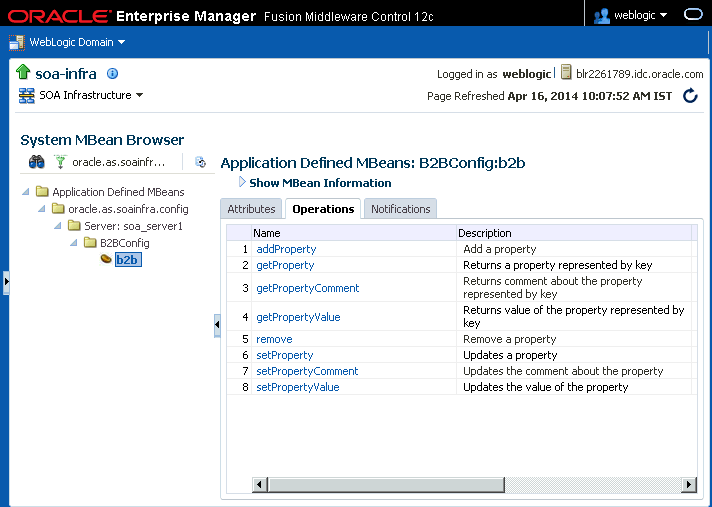

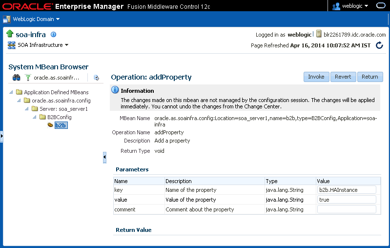

To enable Oracle SOA Suite for healthcare integration, you must define certain B2B properties in Oracle Enterprise Manager. These properties enable high availability for healthcare integration and define time out and ping intervals for the servers.
To enable MLLP high availability for healthcare integration
