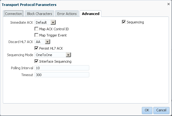

You can configure Interface Sequencing of messages at the endpoint level by selecting the Interface Sequencing check box in the transport protocol configuration.
To configure Interface Sequencing:
Figure E-1 displays the Transport Protocol Parameters dialog box where you configure Interface Sequencing.
This configuration only affects the inbound messages that are received on an endpoint. The endpoint to which the messages are delivered need not be configured for Interface Sequencing.
After you configure Interface Sequencing at the endpoint level, messages received at this endpoint would be marked for Interface Sequencing, and Interface-Sequencing-specific headers would be delivered to the Internal Delivery Channel and the composite.

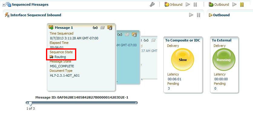

Oracle Healthcare provides you the feature to view the states of the interface sequenced messages by using the Dashboard. Figure E-2 displays the sequence state of the message.
The following sequence states are visible on the Dashboard:
A message with the Routing
sequence state in the Dashboard indicates that the message has been delivered to the back end. In this case, the row for the inbound message in the B2B_SEQUENCE_MANAGER
table displays the value as ROUTING
. The message delivered to the back end has a new header:
