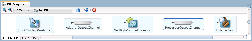

1.1 EPN Diagram
Oracle Stream Explorer application development centers on the Event Processing Network (EPN) application model. The EPN diagram represents how event data flows into, through, and out of an Oracle Stream Explorer application. You assemble the EPN diagram in Oracle JDeveloper by selecting and configuring EPN components and providing logic as needed. In an EPN diagram, event data flows from left to right.
The figure shows the EPN diagram for the TradeReport application. Data enters the EPN through the StockTradeCSV adapter on the left, which handles data in the form of comma-separated values (CSV). The StockTradeCSVadapter logic translates the incoming CSV data into Oracle Stream Explorer events. The AdapterOutputChannel carries the newly generated events to the Oracle CQL processor.
The GetHighVolumeProcessor component queries the events as they stream through and selects stock trades that have a volume greater than 4000. The ProcessorOutputChannel component sends the selected events to the ListenerBean component, which prints their stock symbol and volume information to the command line.
Getting Started with Event Processing for Oracle Stream Explorer describes how to use Oracle JDeveloper to create Oracle Stream Explorer applications. A walkthough of the TradeReport application and a fraud detection application are included.

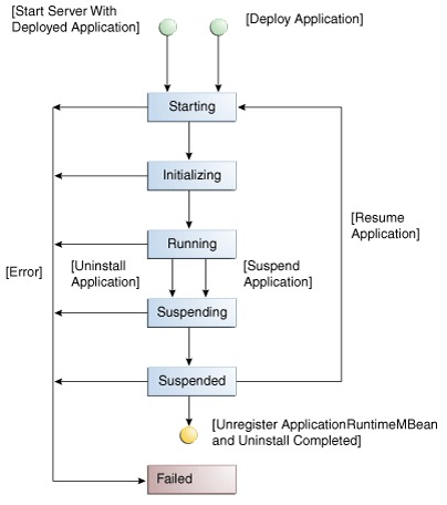

1.5 Application Life Cycle
Figure 1-1 shows a state diagram for the Oracle Stream Explorer application life cycle. In this diagram, the state names (STARTING, INITIALIZING, RUNNING, SUSPENDING, SUSPENDED, and FAILED) correspond to the ApplicationRuntimeMBean method getState return values. These states are specific to Oracle Stream Explorer. They are not OSGi bundle states.
Figure 1-1 Oracle Stream Explorer Application Life Cycle State Diagram
Description of
Description of "Figure 1-1 Oracle Stream Explorer Application Life Cycle State Diagram"
For information on Oracle Stream Explorer server life cycle, see Administering Oracle Stream Explorer.
This section describes the life cycle of an application deployed to the Oracle Stream Explorer server and the sequence of com.bea.wlevs.ede.api API callbacks. The information explains how Oracle Stream Explorer manages an application's life cycle so that you can better use the life cycle APIs in your application. For a description of these life cycle APIs (such as RunnableBean and SuspendableBean), see:
The life cycle description is broken down into actions that a user performs, including those described in the following sections.
Install an Application or Start the Server with the Application Deployed
Oracle Stream Explorer performs the following actions:
  1. Oracle Stream Explorer installs the application as an OSGI bundle. OSGI resolves the imports and exports, and publishes the service.
  2. Oracle Stream Explorer creates beans (for both standard Spring beans and those that correspond to the Oracle Stream Explorer tags in the EPN assembly file). For each bean, Oracle Stream Explorer:
    • Sets the properties on the Spring beans. The <wlevs:instance-property> values are set on adapters and event-beans.
    • Injects appropriate dependencies into services specified by @Service or @ServiceReference annotations.
    • Injects appropriate dependencies into static configuration properties.
    • Calls the InitializingBean.afterPropertiesSet method.
    • Calls configuration callbacks (@Prepare,@Activate) on Spring beans as well as factory-created stages.
      For more information, see Resource Access Configuration.
  3. Application state is now INITIALIZING.
  4. Oracle Stream Explorer registers the MBeans.
  5. Oracle Stream Explorer calls the ActivatableBean.afterConfigurationActive method on all ActivatableBeans.
  6. Oracle Stream Explorer calls the ResumableBean.beforeResume method on all ResumableBeans.
  7. For each bean that implements RunnableBean, Oracle Stream Explorer starts it running in a thread.
  8. Application state is now RUNNING.
Suspend the Application
  1. Oracle Stream Explorer calls the SuspendableBean.suspend method on all SuspendableBeans.
  2. Application state is now SUSPENDED.
Resume the Application
  1. Oracle Stream Explorer calls the ResumableBean.beforeResume method on all ResumableBeans
  2. For each bean that implements RunnableBean, starts it running in a thread.
  3. Application state is now RUNNING.
Uninstall the Application
  2. Oracle Stream Explorer unregisters MBeans.
  3. calls the DisposableBean.dispose method on all DisposableBeans.
  4. Oracle Stream Explorer uninstalls application bundle from OSGI.
Updating the application
This is equivalent to first uninstalling an application and then installing it again.
See those user actions in this list.
