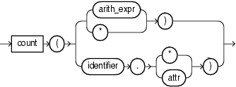

count
returns the number of tuples returned by the query as an int
value.
The return value depends on the argument as Table 9-2 shows.
Table 9-2 Return Values for COUNT Aggregate Function
count
never returns null.
Example
Consider the query q2
and the data stream S2
. Stream S2
has schema (c1 integer, c2 integer)
. The query returns the relation.
<query id="q2"><![CDATA[ SELECT COUNT(c2), COUNT(*) FROM S2 [RANGE 10] ]]></query>
Timestamp Tuple 1000 1,2 2000 1, 3000 1,4 6000 1,6
Timestamp Tuple Kind Tuple -9223372036854775808: + 0,0 1000: - 0,0 1000: + 1,1 2000: - 1,1 2000: + 1,2 3000: - 1,2 3000: + 2,3 6000: - 2,3 6000: + 3,4

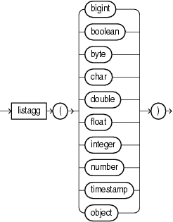

listagg
returns a java.util.List
containing the Java equivalent of the function's argument.
Note that when a user-defined class is used as the function argument, the class must implement the equals
method.
Examples
<view id="v1"><![CDATA[ ISTREAM(select c1, listAgg(c3) as l1, java.util.LinkedHashSet(listAgg(c3)) as set1 from S1 group by c1) ]]></view> <query id="q1"><![CDATA[ select v1.l1.size(), v1.set1.size() from v1 ]]></query>
Timestamp Tuple 1000 orcl, 1, 15, 400 1000 msft, 1, 15, 400 2000 orcl, 2, 20, 300 2000 msft, 2, 20, 300 5000 orcl, 4, 5, 200 5000 msft, 4, 5, 200 7000 orcl, 3, 10, 100 7000 msft, 3, 20, 100 h 20000000
Timestamp Tuple Kind Tuple 1000: + 1,1 1000: + 1,1 2000: + 2,2 2000: + 2,2 5000: + 3,3 5000: + 3,3 7000: + 4,4 7000: + 4,3
