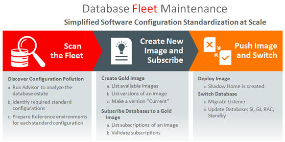

Fleet maintenance involves the following steps:
Identifying configuration pollution using the Software Standardization Advisor.
Creating reference environments.
Creating gold images using reference environments and versioning them for additional changes.
Subscribing databases and clusters to a gold image on which the appropriate patches have been applied.
Deploying the image and switch associated targets from the old Oracle Home to the new Oracle Home.
This maintenance activity can be performed as and when a new version of the gold image is available.
From the 12.2 release, classic patching using Lifecycle Management Graphical User Interface is deprecated. You must use the Database Fleet Maintenance feature to patch 12.2 databases and GI environments.The following figure lists the steps required to perform database fleet maintenance. It covers various configurations such as RAC and Single Instance databases with or without Data Guard, Oracle Restart, RAC One-Node, and Grid Infrastructure Homes.
Figure 45-1 Database Fleet Maintenance Steps

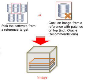

The following figure shows how a gold image can be created.
Figure 45-2 Creating a Gold Image
You can create an image for a database or grid infrastructure home using the emcli command shown below. This image is stored in the Enterprise Manager Software Library and used for provisioning.
