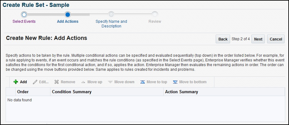

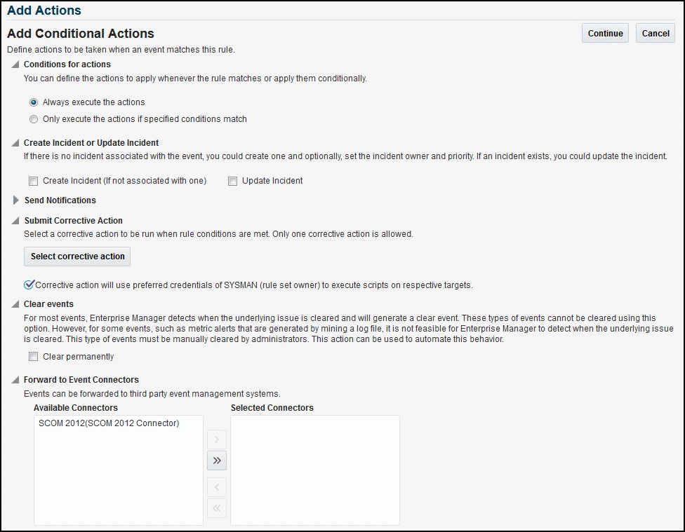

The following section describes procedures that explain how to set up rules to create events and update events in SCOM based on events in Enterprise Manager:
Unless otherwise noted, these instructions apply to the SCOM 2012 connector and to the SCOM 2007 connectors. Instructions specific to the SCOM 2007 connectors are available in Microsoft SCOM 2007 Connector.
A request is sent to the SCOM connector when an event is created per the criteria mentioned in the rule.

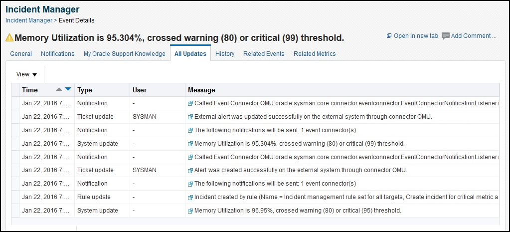

The alert is created or updated on the SCOM console.
In Enterprise Manager, the event is annotated with a comment on the All Updates tab to indicate that an event in SCOM has been created or updated as seen in Figure 4-3.
Figure 4-3 Incident Manager All Updates Tab
