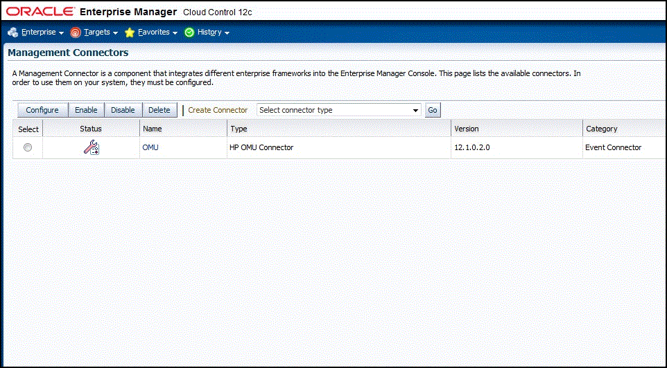

The connector instance appears as unconfigured in the Connector Setup page. Figure 3-1 shows an unconfigured OMU connector instance.
Figure 3-1 Unconfigured HP OMU Connector
