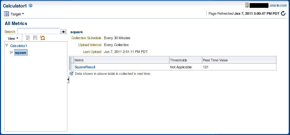

==> Enter the index [1-1] of metric to display: 1
==> Enter the name for this metric [arg0]: SquareResult
==> Enter the label for this metric [SquareResult]:
==> Is this a key metric <y/n>? [n] :
==> Do you want to create threshold for this item <y/n>? [n] :

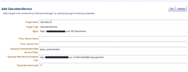

コマンドライン・ツールは、次の例に示すように、CalculatorServiceターゲット・タイプの監視に必要なメタデータを生成します。
例: CalculatorServiceのターゲット・メタデータ・ファイル
<!DOCTYPE TargetMetadata SYSTEM "../dtds/TargetMetadata.dtd">
<TargetMetadata META_VER="1.0" TYPE="CalculatorService">
  <Display>
    <Label NLSID="NLSID_CALCULATOR_SERVICE">CalculatorService</Label>
    <ShortName NLSID="NLSID_CALCULATOR_SERVICE">CalculatorService</ShortName>
    <Description NLSID="NLSID_CALCULATOR_SERVICE">CalculatorService</Description>
  </Display>
  <Metric NAME="square" TYPE="TABLE">
    <Display>
      <Label NLSID="NLSID_SQUARE">square</Label>
    </Display>
    <TableDescriptor>
      <ColumnDescriptor IS_KEY="FALSE" NAME="SquareResult" TYPE="STRING">
        <Display>
          <Label NLSID="COL_SQUARE_RESULT">SquareResult</Label>
        </Display>
      </ColumnDescriptor>
    </TableDescriptor>
    <QueryDescriptor FETCHLET_ID="WSF">
      <Property NAME="ProxyHost" SCOPE="INSTANCE" OPTIONAL="TRUE">ProxyHost</Property>
      <Property NAME="ProxyPort" SCOPE="INSTANCE" OPTIONAL="TRUE">ProxyPort</Property>
      <Property NAME="SecurityPolicy" SCOPE="INSTANCE" OPTIONAL="FALSE">square.SecurityPolicy</Property>
      <Property NAME="ServiceEndpoint" SCOPE="INSTANCE" OPTIONAL="FALSE">square.ServiceEndpoint</Property>
      <Property NAME="ServiceName" SCOPE="GLOBAL" OPTIONAL="FALSE">ns0:CalculatorService</Property>
      <Property NAME="PortName" SCOPE="GLOBAL" OPTIONAL="FALSE">ns0:CalculatorPort</Property>
      <Property NAME="OperationName" SCOPE="GLOBAL" OPTIONAL="FALSE">square</Property>      <Property NAME="MessageType" SCOPE="GLOBAL" OPTIONAL="FALSE">SOAP</Property>
      <Property NAME="SOAPBindingStyle" SCOPE="GLOBAL" OPTIONAL="FALSE">DOCUMENT</Property>
      <Property NAME="SOAPBindingUse" SCOPE="GLOBAL" OPTIONAL="FALSE">LITERAL</Property>
      <Property NAME="ParameterStyle" SCOPE="GLOBAL" OPTIONAL="FALSE">WRAPPED</Property>
      <Property NAME="SOAPVersion" SCOPE="GLOBAL" OPTIONAL="FALSE">SOAP_1_1</Property>
      <Property NAME="Namespace" SCOPE="GLOBAL" OPTIONAL="FALSE"><![CDATA[[ns0="http://tests.jaxws.oracle.com/"]]]></Property>
      <Property NAME="RowType" SCOPE="GLOBAL" OPTIONAL="FALSE">//ns0:squareResponse/arg0</Property>
      <Property NAME="ColType" SCOPE="GLOBAL" OPTIONAL="FALSE">SquareResult:STRING</Property>
      <Property NAME="Payload" SCOPE="GLOBAL" OPTIONAL="FALSE"><![CDATA[<soap:Envelope xmlns:soap="http://schemas.xmlsoap.org/soap/envelope/">
            <soap:Body xmlns:ns1="http://tests.jaxws.oracle.com/">
              <ns1:square>
                <arg0>%square.arg00001%</arg0>
              </ns1:square>
            </soap:Body>
          </soap:Envelope>]]></Property>
      <Property NAME="UserCredential" SCOPE="GLOBAL" OPTIONAL="FALSE">UserCredentialSet01</Property>
      <CredentialRef NAME="UserCredentialSet01">UserCredentialSet01</CredentialRef>
    </QueryDescriptor>
  </Metric>
  <CredentialInfo>
    <CredentialType NAME="CSFKeyCredential">
      <Display>
        <Label NLSID="CRED_TYPE">CSF-Key Credential Type</Label>
      </Display>
      <CredentialTypeColumn NAME="CSFKey">
        <Display>
          <Label NLSID="CRED_C_S_F_KEY">Alias CSF Key</Label>
        </Display>
      </CredentialTypeColumn>
    </CredentialType>
    <CredentialType NAME="AliasCredential">
      <Display>
        <Label NLSID="CRED_TYPE">Alias Credential Type</Label>
      </Display>
      <CredentialTypeColumn NAME="Alias">
        <Display>
          <Label NLSID="CRED_ALIAS">Alias (i.e. username, encryption key, signature key, etc)</Label>
        </Display>
      <CredentialTypeColumn NAME="Password">
        <Display>
          <Label NLSID="CRED_PASSWORD">Password for the alias</Label>
        </Display>
    </CredentialType>
    <CredentialSet NAME="UserCredentialSet01" USAGE="MONITORING">
      <AllowedCredType TYPE="CSFKeyCredential"/>
      <AllowedCredType TYPE="AliasCredential"/>
    </CredentialSet>
  </CredentialInfo>
  <InstanceProperties>
    <InstanceProperty NAME="ProxyHost" CREDENTIAL="FALSE" OPTIONAL="TRUE">
      <Display>
        <Label NLSID="PROP_PROXY_HOST">Proxy Server Name</Label>
      </Display>
    </InstanceProperty>
    <InstanceProperty NAME="ProxyPort" CREDENTIAL="FALSE" OPTIONAL="TRUE">
      <Display>
        <Label NLSID="PROP_PROXY_PORT">Proxy Server Port</Label>
      </Display>
    </InstanceProperty>
    <InstanceProperty NAME="square.SecurityPolicy" CREDENTIAL="FALSE" OPTIONAL="FALSE">
      <Display>
        <Label NLSID="PROP_SQUARE_SECURITY_POLICY">[square] Authentication/Web Service Policy</Label>
      </Display>
    </InstanceProperty>
    <InstanceProperty NAME="square.ServiceEndpoint" CREDENTIAL="FALSE" OPTIONAL="FALSE">
      <Display>
        <Label NLSID="PROP_SQUARE_SERVICE_ENDPOINT">[square] Web Service Endpoint URL</Label>
      </Display>
    </InstanceProperty>
    <InstanceProperty NAME="square.arg00001" CREDENTIAL="FALSE" OPTIONAL="FALSE">
      <Display>
        <Label NLSID="PROP_SQUARE_ARG00001">[square] square.arg0</Label>
      </Display>    </InstanceProperty>  </InstanceProperties></TargetMetadata>

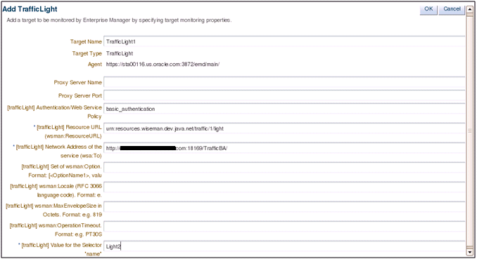

==> Enter the name for this target type: TrafficLight
==> Enter the metadata file name [/tmp/target/metadata/TrafficLight.xml] :
Define new metric group name:
==> Enter the name for this metric group: trafficLight
WS-Addressing namespaces:
[1]   http://www.w3.org/2005/08/addressing
[2]   http://schemas.xmlsoap.org/ws/2004/08/addressing
==> Enter the index [1-2] to select: 1
SOAP Envelope namespaces:
[1]   http://www.w3.org/2003/05/soap-envelope
[2]   http://schemas.xmlsoap.org/soap/envelope/
Resource properties:
[1]   trafficlight:color
[2]   trafficlight:name
[3]   trafficlight:x
[4]   trafficlight:y
==> Enter the index [1-4] of property to display: 2
==> Enter the name for this metric [name]:
==> Enter the label for this metric [name]:
==> Is this a key metric <y/n>? [n] : y
==> Do you want to add another metric <y/n>? [n] : y
[2]   trafficlight:x
[3]   trafficlight:y
==> Enter the index [1-3] of property to display: 1
==> Enter the name for this metric [color]:
==> Enter the label for this metric [color]:
[1]   trafficlight:x
[2]   trafficlight:y
==> Enter the index [1-2] of property to display: 1
==> Enter the name for this metric [x]:
==> Enter the label for this metric [x]:
[1]   trafficlight:y
==> Enter the index [1-1] of property to display: 1
==> Enter the name for this metric [y]:
==> Enter the label for this metric [y]:
==> Enter comma-separated list of Selector elements: name
==> Do you want to add User/Password Credential <y/n>? [n] : y
==> Enter the name for User/Password credential set [UserCredentialSet01] :
==> Is this metric group for periodic collection <y/n>? [y] :
The following units are for collection frequency:
[1]   Min
[2]   Hr
[3]   Day
==> Enter the index [1-3] of unit for this collection: 1
==> Enter the frequency of collection in Min: 30
==> Do you want to add another metric group <y/n>? [n] :
Files Generated:
- Target Metadata file: /tmp/target/metadata/TrafficLight.xml
- Target Collection file: /tmp/target/metadata/TrafficLightCollection.xml

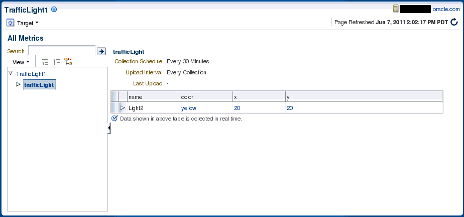

コマンドライン・ツールは、次の例に示すように、ターゲット・タイプTrafficLightの監視に必要なメタデータを生成します。
例: TrafficLightターゲットのメタデータ・ファイル
<TargetMetadata META_VER="1.0" TYPE="TrafficLight">
  <Display>
    <Label NLSID="NLSID_TRAFFIC_LIGHT">TrafficLight</Label>
    <ShortName NLSID="NLSID_TRAFFIC_LIGHT">TrafficLight</ShortName>
    <Description NLSID="NLSID_TRAFFIC_LIGHT">TrafficLight</Description>
  </Display>
  <Metric NAME="trafficLight" TYPE="TABLE">
    <Display>
      <Label NLSID="NLSID_TRAFFIC_LIGHT">trafficLight</Label>
    </Display>
    <TableDescriptor>
      <ColumnDescriptor IS_KEY="TRUE" NAME="name" TYPE="STRING">
        <Display>
          <Label NLSID="COL_NAME">name</Label>
        </Display>
      </ColumnDescriptor>
      <ColumnDescriptor IS_KEY="FALSE" NAME="color" TYPE="STRING">
        <Display>
          <Label NLSID="COL_COLOR">color</Label>
        </Display>
      </ColumnDescriptor>
      <ColumnDescriptor IS_KEY="FALSE" NAME="x" TYPE="STRING">
        <Display>
          <Label NLSID="COL_X">x</Label>
        </Display>
      </ColumnDescriptor>
      <ColumnDescriptor IS_KEY="FALSE" NAME="y" TYPE="STRING">
        <Display>
          <Label NLSID="COL_Y">y</Label>
        </Display>
      </ColumnDescriptor>
    </TableDescriptor>
    <QueryDescriptor FETCHLET_ID="WSManagementFetchlet">
      <Display>
      </Display>
    </InstanceProperty>
      <Display>
      </Display>
    </InstanceProperty>
    <InstanceProperty NAME="trafficLight.SecurityPolicy"
      <Display>
        <Label NLSID="PROP_TRAFFIC_LIGHT_SECURITY_POLICY">[trafficLight] Authentication/Web Service Policy</Label>
      </Display>
    </InstanceProperty>
    <InstanceProperty NAME="trafficLight.ResourceURL" CREDENTIAL="FALSE" OPTIONAL="FALSE">
      <Display>
        <Label NLSID="PROP_TRAFFIC_LIGHT_RESOURCE_U_R_L">[trafficLight] Resource URL (wsman:ResourceURL)</Label>
      </Display>
    </InstanceProperty>
    <InstanceProperty NAME="trafficLight.To" CREDENTIAL="FALSE" OPTIONAL="FALSE">
      <Display>
        <Label NLSID="PROP_TRAFFIC_LIGHT_TO">[trafficLight] Network Address of the service (wsa:To)</Label>
      </Display>
    </InstanceProperty>
    <InstanceProperty NAME="trafficLight.OptionSet" CREDENTIAL="FALSE" OPTIONAL="TRUE">
      <Display>
        <Label NLSID="PROP_TRAFFIC_LIGHT_OPTION_SET">[trafficLight] Set of wsman:Option. Format: [&lt;OptionName1&gt;, value:&lt;value1&gt;, type:&lt;type1&gt;, mustComply:&lt;true|false&gt;][&lt;OptionName2&gt;, value:&lt;value2&gt;, type:&lt;type&gt;, mustComply:&lt;true|false&gt;][...]</Label>
      </Display>
    </InstanceProperty>
    <InstanceProperty NAME="trafficLight.Locale" CREDENTIAL="FALSE" OPTIONAL="TRUE">
      <Display>
        <Label NLSID="PROP_TRAFFIC_LIGHT_LOCALE">[trafficLight] wsman:Locale (RFC 3066 language code). Format: e.g. en-US</Label>
      </Display>
    </InstanceProperty>
    <InstanceProperty NAME="trafficLight.MaxEnvelopeSize"
      <Display>
        <Label NLSID="PROP_TRAFFIC_LIGHT_MAX_ENVELOPE_SIZE">[trafficLight] wsman:MaxEnvelopeSize in Octets. Format: e.g. 8192</Label>
      </Display>
    </InstanceProperty>
    <InstanceProperty NAME="trafficLight.OperationTimeout"
      <Display>
        <Label NLSID="PROP_TRAFFIC_LIGHT_OPERATION_TIMEOUT">[trafficLight] wsman:OperationTimeout. Format: e.g. PT30S</Label>
      </Display>
    </InstanceProperty>
    <InstanceProperty NAME="trafficLight.name" CREDENTIAL="FALSE" OPTIONAL="FALSE">
      <Display>
        <Label NLSID="PROP_TRAFFIC_LIGHT_NAME">[trafficLight] Value for the Selector "name"</Label>
      </Display>
    </InstanceProperty>

コマンドライン・ツールは、次の例に示すように、必要な収集ファイルも生成します。
例: TrafficLightのデフォルトの収集ファイル
<!DOCTYPE TargetCollection SYSTEM "../dtds/TargetCollection.dtd">
<TargetCollection TYPE="TrafficLight">
  <CollectionItem NAME="trafficLight">
    <Schedule>
      <IntervalSchedule TIME_UNIT="Min" INTERVAL="30"/>
    </Schedule>
  </CollectionItem>
</TargetCollection>

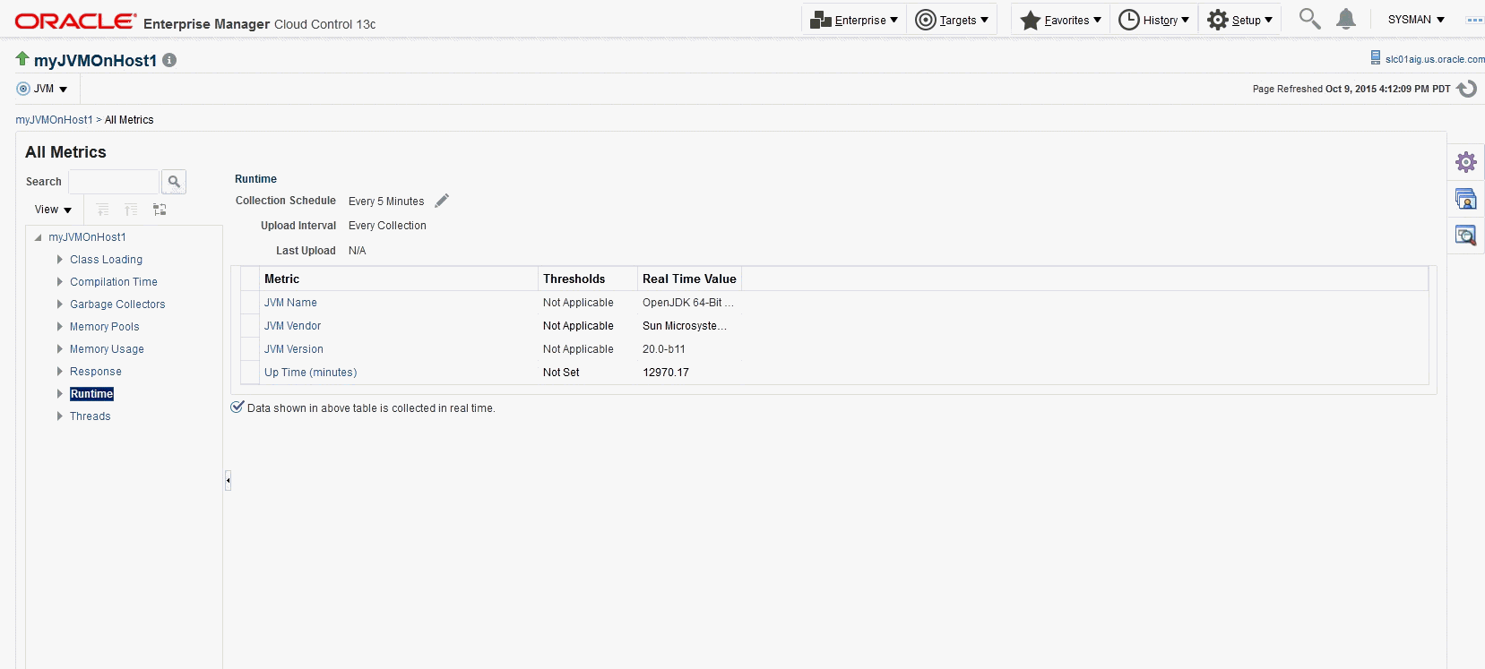

4: sun.management.RuntimeImpl        (java.lang:type=Runtime)
5: sun.management.ClassLoadingImpl        (java.lang:type=ClassLoading)
6: sun.management.MemoryPoolImpl        (java.lang:name=Survivor Space,type=MemoryPool)
7: sun.management.ThreadImpl        (java.lang:type=Threading)
8: sun.management.GarbageCollectorImpl        (java.lang:name=MarkSweepCompact,type=GarbageCollector)
9: com.sun.management.UnixOperatingSystem        (java.lang:type=OperatingSystem)
10: sun.management.MemoryImpl        (java.lang:type=Memory)
11: sun.management.MemoryPoolImpl        (java.lang:name=Code Cache,type=MemoryPool)
12: sun.management.MemoryPoolImpl        (java.lang:name=Tenured Gen,type=MemoryPool)
13: sun.management.MemoryPoolImpl        (java.lang:name=Perm Gen,type=MemoryPool)
Enter the index of target/MBean you wish to monitor or press <Ctrl-C> to quit: 4
Following metric source types are available for selected target(s):
        0: JMX Attributes
Enter the index of your choice or press <Ctrl-C> to quit: 0
Attributes are:
        0: BootClassPath         Return Value: java.lang.String
        1: BootClassPathSupported        Return Value: boolean
        2: ClassPath     Return Value: java.lang.String
        3: InputArguments        Return Value: [Ljava.lang.String;
        4: LibraryPath   Return Value: java.lang.String
        5: ManagementSpecVersion         Return Value: java.lang.String
        6: Name  Return Value: java.lang.String
        7: SpecName      Return Value: java.lang.String
        8: SpecVendor    Return Value: java.lang.String
        9: SpecVersion   Return Value: java.lang.String
        10: StartTime    Return Value: long
        11: SystemProperties     Return Value:
javax.management.openmbean.TabularData
        12: Uptime       Return Value: long
        13: VmName       Return Value: java.lang.String
        14: VmVendor     Return Value: java.lang.String
        15: VmVersion    Return Value: java.lang.String
Select one or more items as comma-separated indices: 6,7,8
Number of possible columns in the resultant metric are 3.
Enter the name for this metric column at index=0 : [Name]
Is this column a KEY Column <y/n>? [n] y
Is this column for SUMMARY_UI <y/n>? [n]
Enter the label for column: [Name]
Enter the NLSID for column: [Name]
Enter the UNIT for column "Name": [millisec, kb etc.. ]
Enter the name for this metric column at index=1 : [SpecName]
Enter the label for column: [SpecName]
Enter the NLSID for column: [SpecName]
Enter the UNIT for column "SpecName": [millisec, kb etc.. ]
Do you want to create a threshold for this column <y/n>? [n]
Enter the name for this metric column at index=2 : [SpecVendor]
Enter the label for column: [SpecVendor]
Enter the NLSID for column: [SpecVendor]
Enter the UNIT for column "SpecVendor": [millisec, kb etc.. ]
Enter the name of this metric: RuntimeMetric
Enter the label for this metric: [RuntimeMetric]
Do you want periodic collection for this metric <y/n>? [n] y
Enter the collection interval in seconds: 300
Periodic collection interval is: 300 seconds.
Do you want to create another metric <y/n>? [n]
Written the metadata xml file: ./metadata/myJavaApp.xml.
Creating new file: ./default_collection/myJavaApp.xml.
Updated the default collection file for myJavaApp at location
Exiting...

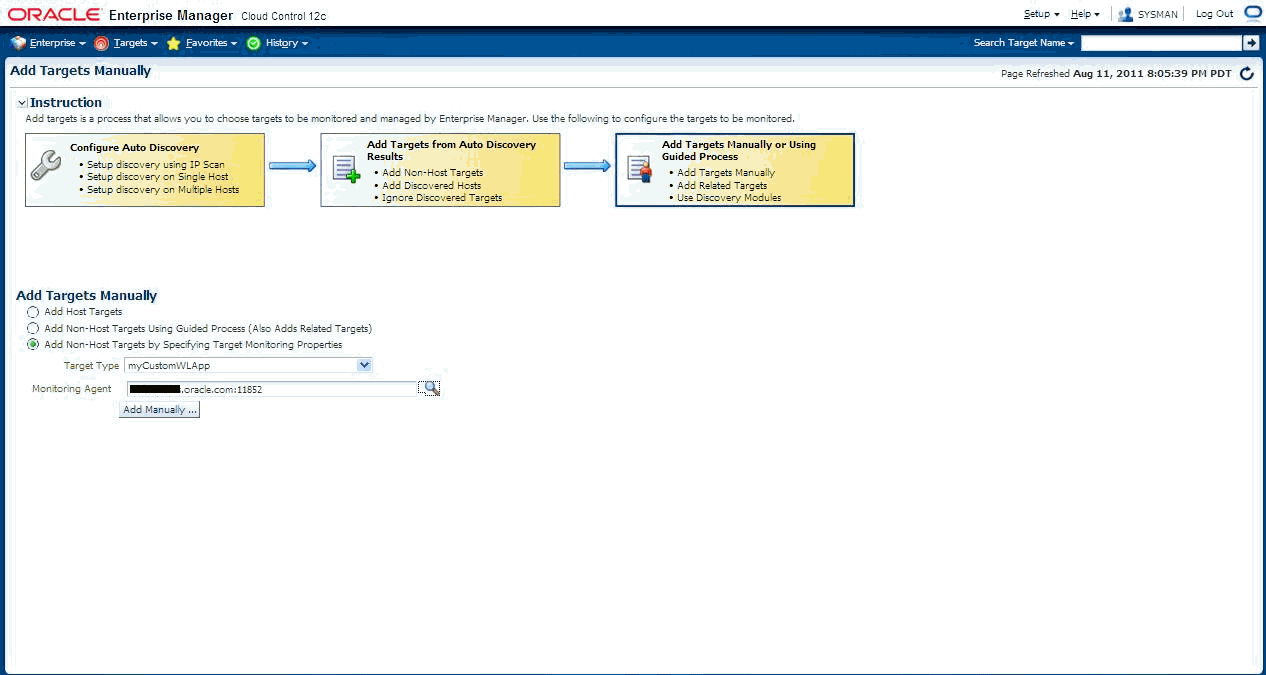

18.5.1.3 ターゲット・ステータス情報の表示
ターゲットのステータス情報がEnterprise Managerコンソールに正しく表示されるためには、クリティカルしきい値が設定された「ステータス」という名前の列を持つ 「レスポンス」というメトリックを定義する必要があります。メトリック値がクリティカルしきい値を下回っている場合、このタイプのターゲット・インスタンスのステータスはコンソールに「稼働中」(使用可能)として表示されます。しきい値を超えている場合、ターゲット・ステータスはコンソールに「停止中」として表示されます。
「レスポンス」メトリックは別のjmxcliセッションで作成できます(以前のセッションで作成されたメタデータ・ファイルおよび収集ファイルにメトリックを追加します)。

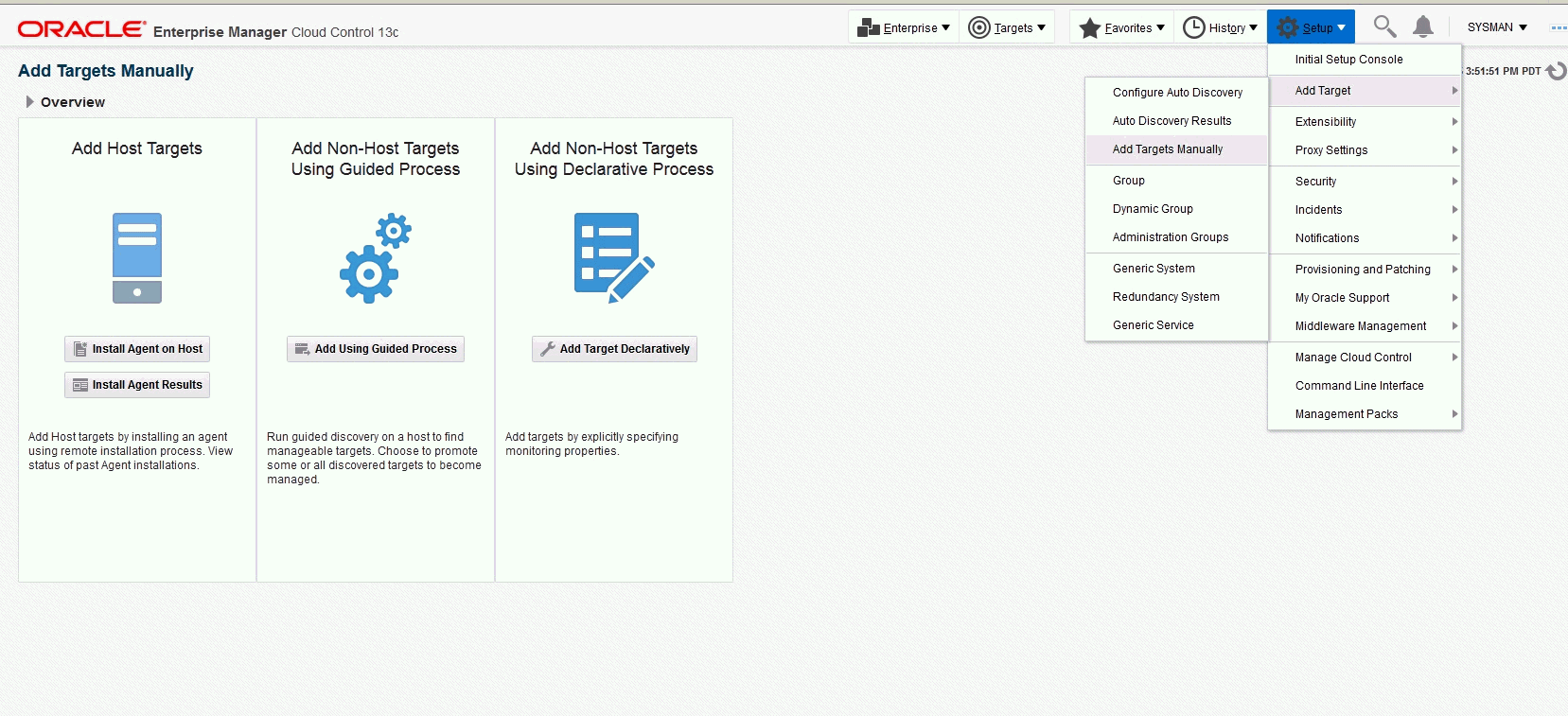

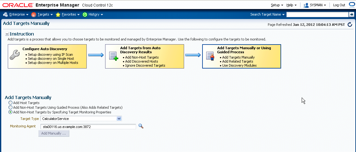

  1. 「設定」メニューから、「ターゲットの追加」、「ターゲットの手動追加」の順に選択します。
  2. 「ターゲット監視プロパティを指定して非ホスト・ターゲットを追加」を選択します。
  3. 「ターゲット・タイプ」メニューからCalculatorServiceを選択します。
  4. 「監視エージェント」メニューから、必要な監視管理エージェントを選択します。
    画像は、手動によるターゲットの追加を示しています。
  5. 「手動追加」をクリックして続けます。
  6. 監視するターゲットのプロパティ値を入力します。
    画像は、calculatorサービスの追加を示しています。
  7. 「OK」をクリックして、プロセスを完了します。確認ウィンドウに、新しく追加されたターゲットの情報が表示されます。

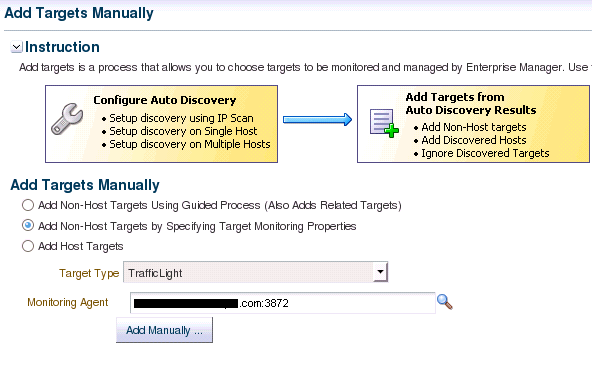

18.6.2 WS-Managementターゲットの追加: TrafficLight
TrafficLightターゲットを追加するには、次の手順を実行します。
  3. 「ターゲット・タイプ」ドロップダウン・メニューで、TrafficLightを選択します。
  4. 「監視エージェント」ドロップダウン・メニューで、目的のエージェントを選択します。
    ターゲットの手動追加
    TrafficLightターゲットの追加

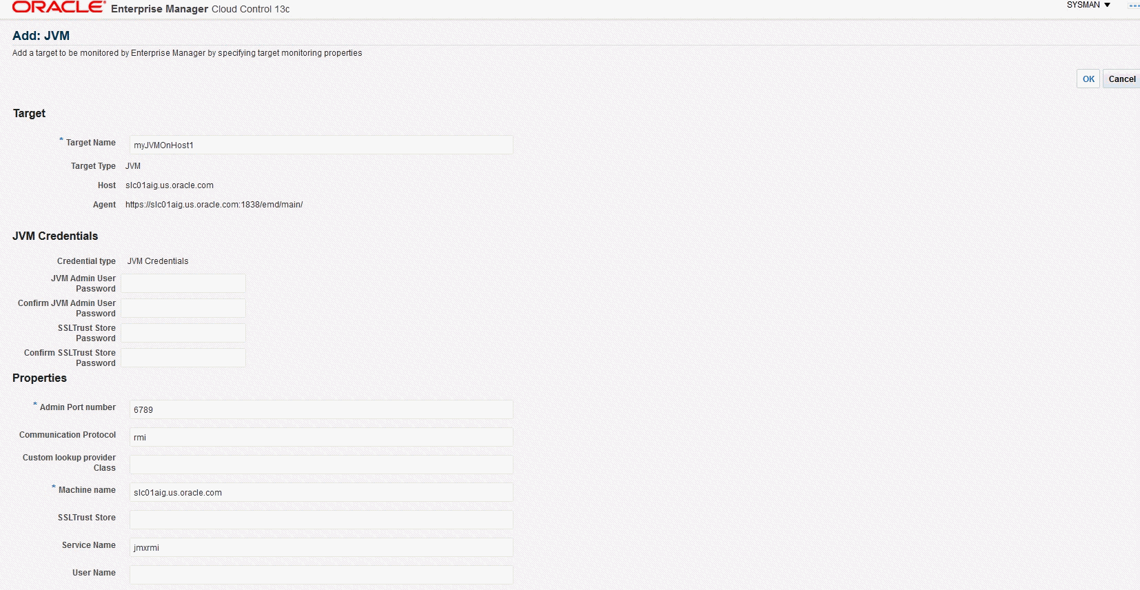

18.6.3 スタンドアロンJavaアプリケーションまたはJVMターゲットの構成
スタンドアロンJavaアプリケーションを定義するプラグインをデプロイした場合や、組込みJVMターゲット・タイプを使用する場合は、これらのターゲットのメトリックをEnterprise Manager Grid Controlで収集できるように、JVMまたはJMX対応のJavaアプリケーション・ターゲットの構成を開始できます。
JVMを実行するシステムに、バージョン10.2.0.3以降のEnterprise Managerエージェントをインストールします。これは推奨される手順ですが、JVMおよびスタンドアロンJavaアプリケーションのターゲットに必要な手順ではありません。監視エージェントがターゲットJVMに対してローカルである必要はありません。
JVMターゲット・インスタンスを追加するには、次の手順を実行します。

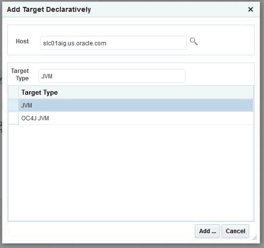

  1. Enterprise Managerコンソールの「設定」メニュー(右上)から、「ターゲットの追加」、「ターゲットの手動追加」の順に選択します。
  3. 「ターゲット・タイプ」メニューから「JVM」を選択します。
  4. 「監視エージェント」リストから、必要な管理エージェント(できれば、監視するJVMにローカルの管理エージェント)を選択します。
    画像は、エージェントを選択するためのメニューの選択内容を示しています。
    ターゲットを宣言的に追加
  5. このJVMまたは管理エージェントで監視する必要のあるJavaアプリケーション・インスタンスのインスタンス・プロパティを入力して、「OK」をクリックします。
    画像は、インスタンス・プロパティの追加を示しています。
    表18-1に、インスタンス・プロパティの定義を示します。
    表18-1 JVMインスタンス・プロパティ
    プロパティ 定義
    名前
    このJVMインスタンスのターゲット名。
    MachineName
    このJVMが稼働するホストの名前。
    管理ポート番号
    JSR-160クライアントがJVMへの接続に使用できるポート番号(リモート・オプションを使用する場合のjconsoleなど)。(これは、リモート管理を有効化するためにJVMが起動されたときに-Dcom.sun.management.jmxremote.portプロパティに対して指定されたポート番号です。)
    ユーザー名
    パスワードおよびアクセス・ファイルを使用し、Dcom.sun.management.jmxremote.authenticate=true
    の設定を使用してJVMを起動した場合は必須です。
    JVM Adminユーザー・パスワード
    前述のユーザー名プロパティを参照してください。
    通信プロトコル
    ターゲットJVM上のMBeanServerへの接続を確立します。これは、ターゲットMBeanServerへのJMX接続を確立するのに必要なJMXサービスURLのプロパティに対応します。デフォルト値であるrmiを保持してください。
    サービス名
    ターゲットJVM上のMBeanServerへの接続を確立します。これは、ターゲットMBeanServerへのJMX接続を確立するのに必要なJMXサービスURLのプロパティに対応します。デフォルト値であるjmxrmiを保持してください。
    SSLTrustストア
    SSL Trustストアの場所。ターゲットJVMの起動時にcom.sun.management.jmxremote.ssl=trueの設定を使用してSSLが有効化されている場合に必要です。
    SSLTrustストアのパスワード
    SSL Trustストアのパスにアクセスするためのパスワード。
    カスタムのルックアップ・プロバイダ・クラス
    Enterprise Managerクライアントに統合し、LDAPまたは他のルックアップ・プロトコルを介してMBeanServerのカスタム・ルックアップを実行するのに使用できる、ユーザー実装Javaルックアップ・クラスの完全なパッケージ名。

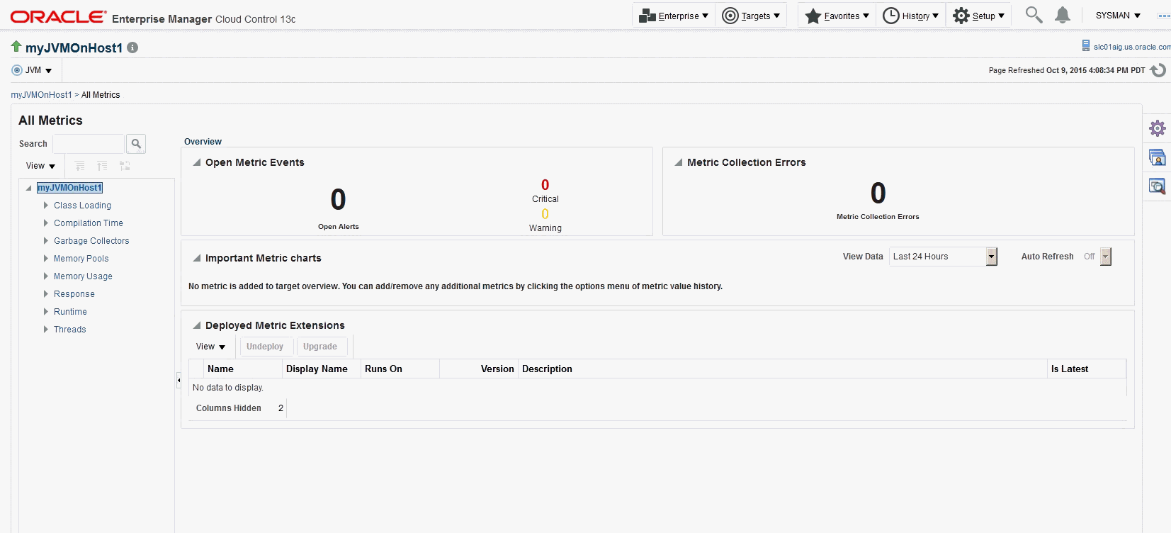

  6. 追加したJVM(Javaアプリケーション)ターゲットの「すべてのメトリック」ページにナビゲートして、JVM(Javaアプリケーション)からEnterprise Managerに収集されたメトリックを確認します。これらのメトリックは、JDK1.5以上で使用できるプラットフォームMBeanによって公開されるか、Javaアプリケーションのアプリケーション定義のMBeanから公開されます。
    「ターゲット」メニューからJVMターゲットのホームページにナビゲートするには、「すべてのターゲット」を選択してから、JVMターゲット・インスタンスを選択します。
    「すべてのメトリック」ページにナビゲートするには、「ターゲット」メニューから「監視」を選択して、JVMターゲットのホームページのメニューから「すべてのメトリック」を選択します。
    jvm_metrics_collect.gifの説明が続きます
    図「jvm_metrics_collect.gif」の説明
    次の画像は、収集されたメトリックの詳細を示しています。
    coll_metric_details.gifの説明が続きます
    図「coll_metric_details.gif」の説明

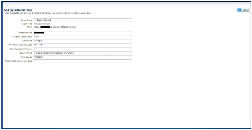

18.6.4 Weblogic上のカスタムJ2EEアプリケーションのターゲット・インスタンスの追加
WebLogicにはカスタムJ2EEアプリケーションがあり、JMX MBeanで公開されるカスタム・メトリックをEnterprise Managerに収集する必要があります。カスタム・ターゲット・タイプを定義するプラグインを一度定義してデプロイすると、プラグインのデプロイ対象の様々な管理エージェントでJMX対応のJ2EEアプリケーション・ターゲット・インスタンスの構成を開始できます。これにより、これらのターゲット・インスタンスのメトリックをEnterprise Managerで収集できるようになります。
  1. 「設定」メニューから、「ターゲットの追加」、「ターゲットの手動追加」の順に選択します。「ターゲット監視プロパティを指定して非ホスト・ターゲットを追加」オプションを選択します。
  2. 以前に作成されてOMSにデプロイされたカスタム・ターゲット・タイプを選択します。
  3. このターゲット・タイプのインスタンスを作成する監視管理エージェントを選択します(できれば、ターゲットにローカルなEMエージェントにします)。
    JMXターゲット・タイプの選択
  4. 「手動追加」をクリックします。
  5. 次の画像に示すように、必要なターゲット・プロパティを入力して、「OK」をクリックします。新規に追加したターゲットがエージェントの「すべてのターゲット」リストに表示されます。
    注意:
    jmxcliが-l <serviceURL>オプションで起動されている場合、次の画面でJMXServiceURLプロパティの入力を要求されます。これは次のように入力できます。
    service:jmx:t3://<host>:<port>/jndi/weblogic.management.mbeanservers.runtime
    「マシン名」、「管理ポート番号」および「サービス名」を3つの個別のターゲット・インスタンス・プロパティとして入力するかわりになります。
    JVMターゲットのプロパティ。

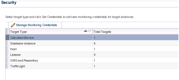

18.7 資格証明設定の監視

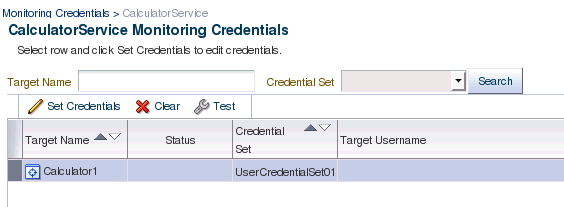

一部のターゲット・タイプでは、ターゲット・インスタンスに設定される資格証明を監視する必要があります。デモ・プラグインでは、CalculatorServiceとTrafficLightのどちらも資格証明の監視が必要です。次の手順で、資格証明の設定方法を示します。
  1. 「設定」メニューから、「セキュリティ」、「監視資格証明」の順に選択します。
  2. CalculatorServiceを選択して、「監視資格証明の管理」をクリックします。
    画像は、選択されたCalculatorServiceを示しています。
  3. Calculator1を選択して、「資格証明の設定」をクリックします。
    画像は、Calculator1に設定された資格証明を示しています。

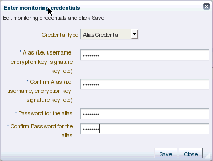

  4. 「資格証明のタイプ」からAliasCredentialを選択します。「別名」と「パスワード」の値を入力します。
    画像は、監視資格証明のダイアログを示しています。
  5. 「保存」をクリックして終了します。

18.8 監視対象メトリックの表示
監視のために管理エージェントにターゲット・インスタンスが追加されたため、ターゲット・タイプに対して定義されたメトリックを表示できます。前回と同様に、サンプル・ターゲットを使用して手順を示します。
  1. 「すべてのターゲット」ページから、以前の手順で追加したターゲットをクリックします。Enterprise Managerにより、ターゲットのホームページが表示されます。
  2. 「ターゲット」メニューから、「監視」、「すべてのメトリック」の順に選択します。「すべてのメトリック」ページが監視対象のターゲットに対して表示されます。各メトリックの展開可能なツリー・リストにより、次に示すようにドリルダウンして特定のメトリック・パラメータを表示できます。
calculator1ターゲットのメトリック
trafficlight1のメトリック

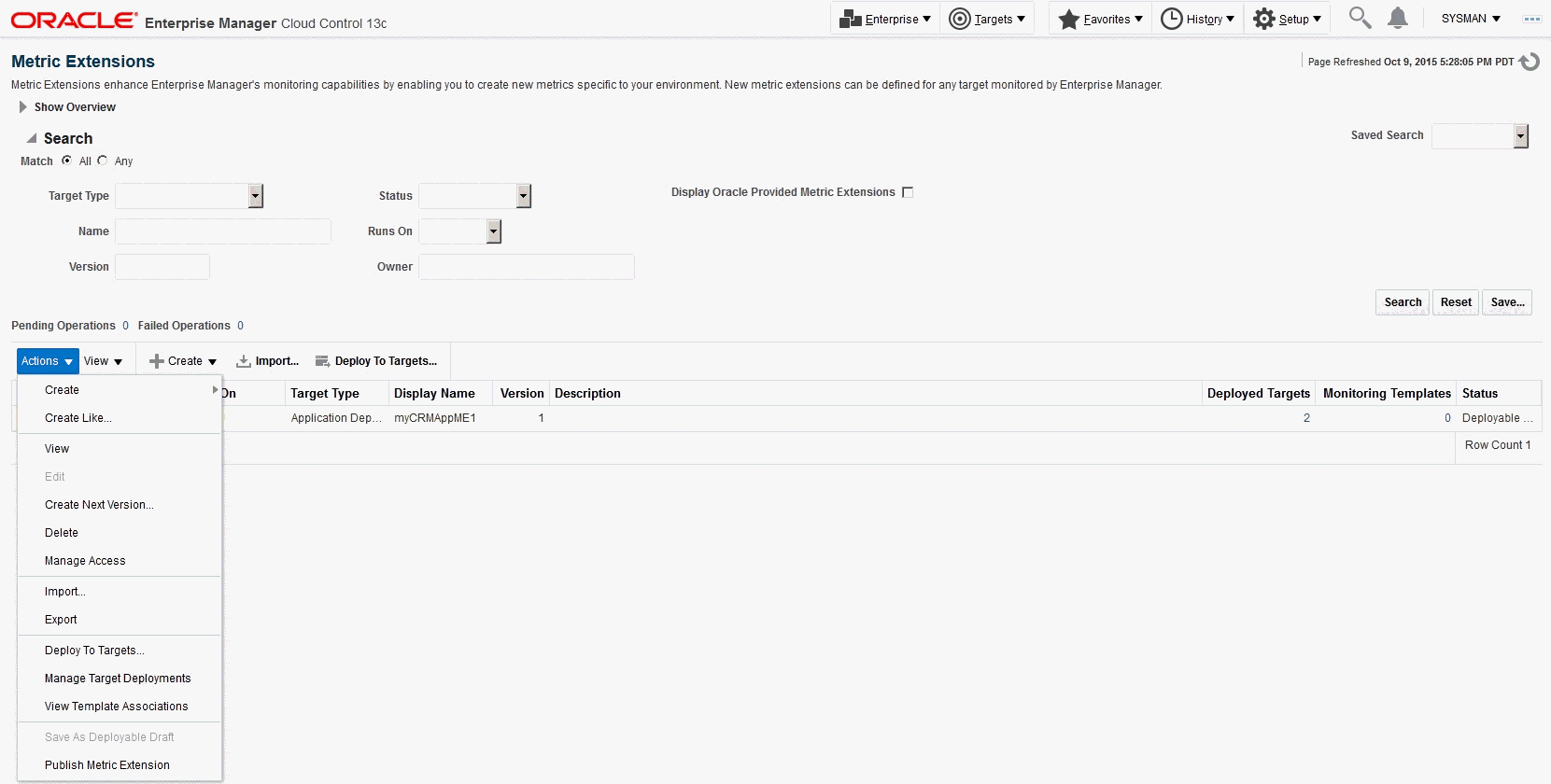

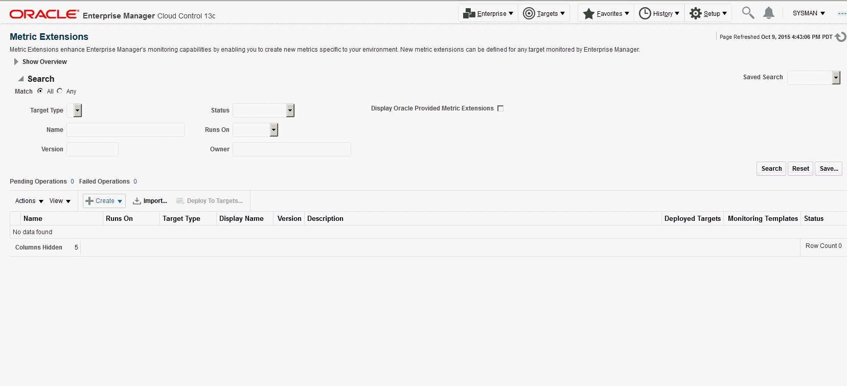

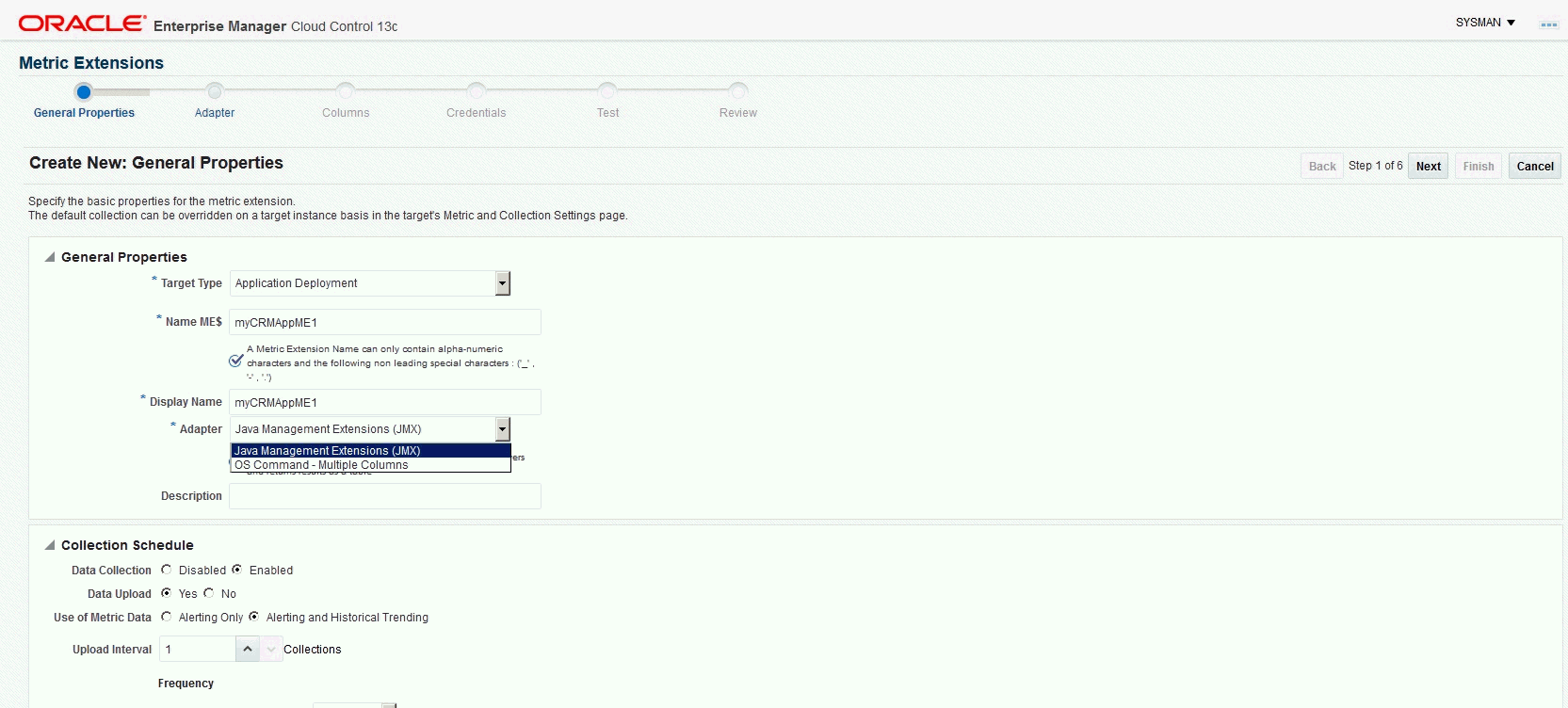

  1. 「エンタープライズ」メニューから、「監視」、「メトリック拡張」の順に選択します。「メトリック拡張」ページが表示されます。
  2. 「作成」をクリックして、メトリック拡張を作成します。
    画像は、開始されたメトリック拡張プロセスの作成プロセスを示しています。
  3. 「アプリケーション・デプロイメント」ターゲット・タイプ(またはこのメトリックを定義する必要がある他の適切なEnterprise Managerターゲット)を選択して、メトリック拡張に意味のある名前を指定します。このアプリケーションと他のカスタム・アプリケーションの両方について、「アプリケーション・デプロイメント」ターゲット・タイプで追加のメトリック拡張の作成を最終的に終了することを念頭に置いてください。可能なかぎり、メトリック拡張名にはメトリック名とアプリケーション名の両方を取得することをお薦めします。
    さらに、アダプタのJMXを選択します。
    「一般プロパティ」セクションの下にある「収集スケジュール」に注意してください。ここでは、このメトリックの収集頻度や、このメトリックがリアルタイム専用であるかどうかを定義します(この場合、「無効」ボタンを選択する必要があります)。
    「アラートおよび履歴の傾向」を選択する場合、「アップロード間隔」を選択することもできます。これは、履歴の傾向にどのサンプル(その頻度が「繰返し間隔」フィールドに指定される)がEnterprise Managerリポジトリにアップロードされるかを示します。たとえば、収集頻度を15分に指定して、「アップロード間隔」を3にした場合、サンプルが3つおきにリポジトリにアップロードされ(45分ごと)、履歴の傾向に利用できます。ただし、しきい値の違反が原因でトリガーされる可能性のある「アラート」は、収集のたびに(15分ごとに)利用できます。
    画像は、メトリック拡張の一般プロパティ・ページを示しています。

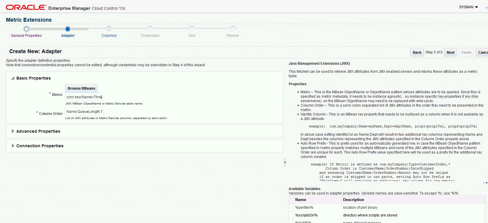

  4. 「次へ」をクリックして、JMXベースのメトリックに必要な必須プロパティを指定します。これらは、「基本プロパティ」セクションで定義され、次のようなプロパティになります。
    • メトリック: Mbeanのオブジェクト名またはパターン
    • 列の順序: 前述のMbeanのセミコロン区切りのJMX属性のリスト(JMX操作でメトリックを定義する必要がある場合、次の項に示すようにjmxcliを使用します)。
    前述の定義されたMbeanオブジェクト名またはパターンに、サーバー固有のキー・プロパティは定義できないことに注意してください。これらのプロパティは、ワイルドカード(*)で置き換えることができます。
    たとえば、Mbeanオブジェクト名がcom.bea:Type=foo,Location=Server1,Name=abcの場合、前述の「メトリック」プロパティでcom.bea:Type=foo,*と定義することが適しています。また、Mbeanオブジェクト名がパターンの場合、このメトリックを複数行の表にして複数のMbeanが返されます(各行は、ObjectNameパターンに一致するMbeanのJMX属性を表します)。この場合、各行が結果のメトリックで一意になるように、少なくとも1つ以上の列をキー列として定義する必要があります。
    画像は、アダプタの選択を示しています。
    前述の手順では、「MBeanの参照」ボタンがあり、これら2つのプロパティの構成が容易になります。このボタンでは、MbeanServerを参照でき、メトリック拡張で定義される該当メトリックで表す必要があるMbeanとそのJMX属性を選択します。
    「MBeanの参照」をクリックする場合、次の操作を順に行う必要があります。
    • ターゲットの選択: このメトリックの定義に使用する必要があるターゲット・タイプのインスタンスを選択します。このターゲット・インスタンスは、メトリックの構成に役立ちます。メトリックが最終的に定義されるターゲット・インスタンスである必要はありません。
    • MBeanパターンの入力: ここでは、監視に関連するMbeanのオブジェクト名とパターンを入力します。
    • 「MBeanをリスト」をクリック: 「MBeanと属性の選択」の下の表に表示されます。Mbeanパターンに一致するMbean、またはテキスト「MBeanがリストされていないか、MBeanパターンと一致するMBeanがありません」(一致がない場合)が表示されます。前述の「MBeanパターンの入力」フィールドを繰り返し更新し、「MBeanをリスト」をクリックして、表示されるMbeanのリストを絞り込むことができます。
      画像は、MBean属性の選択を示しています。
    • 関連するMbeanの選択: 選択したMbeanのJMX属性を含む次の表が自動的に表示されます。
      画像は、MBeanの選択と属性を示しています。
      [Crtl]をクリックしながら複数の属性を選択できます。選択内容を受け入れるには、「選択」をクリックします。
      画像は、複数のMBean属性の選択を示しています。
  5. JMXベースのメトリック拡張の定義に必要なパラメータ「メトリック」と「列の順序」を指定する必要があります。
    前述のMBeanの参照ウィザードを使用してメトリック拡張を構成する際に選択または使用されたサーバーの他に複数のサーバーにこのメトリック拡張を適用できる場合、「メトリック」フィールドに表示されるMbean名のキー・プロパティにインスタンス固有の情報を含めないようにしてください(Location=Server1やServerName=fooなど)。これを有効なMbean ObjectNameパターンにするには、これらのインスタンス固有のキー・プロパティをワイルドカード「*」で適宜置き換えることができます。
    画像は、MBeanのアダプタ作成を示しています。
    指定可能なプロパティの説明
    必須プロパティ:
    • metric: 属性を問い合せるMBean ObjectNameまたはObjectNameパターン。これはメトリックのメタデータとして指定されるため、インスタンスにとらわれないようにする必要があります。そのため、MBean ObjectNameのインスタンス固有のキー・プロパティ(servernameなど)がある場合は、そのプロパティをワイルドカードで置き換える必要があります。
    • columnOrder : これは、メトリック内に存在する必要のある順序で並べられたJMX属性のセミコロン区切りリストです。
    拡張プロパティ:
    • identityCol: JMX属性として使用可能でない場合に列として公開する必要のあるMBeanキー・プロパティ。例: com.myCompany:Name=myName,Dept=deptName, prop1=prop1Val, prop2=prop2Val。この例では、identityColをName;Dept(セパレータはセミコロン)として設定すると、columnOrderプロパティで指定したJMX属性を表す列の他にNameとDeptを表す2つの追加キー列が生成されます。
    • autoRowId: メトリック・プロパティで指定されたMBean ObjectNameパターンが複数のMBeanに一致し、columnOrderで指定されたJMX属性のいずれもそれぞれ一意でない場合は、行が自動的に生成されます。この場合に使用される接頭辞です。ここで指定した autoRowId は、作成される追加のキー列の接頭辞として使用されます。たとえば、メトリックがcom.myCompany:Type=CustomerOrder,*と定義される場合、columnOrderはCustomerName;OrderNumber;DateShippedになります(注文が2つに分けて出荷された場合、customerName;OrderNumber;DateShippedは一意ではないと仮定します)。
      autoRowIdを「ShipItem-」に設定すると、各行のメトリックの追加キー列にShipItem-0、ShipItem-1が表示されます。

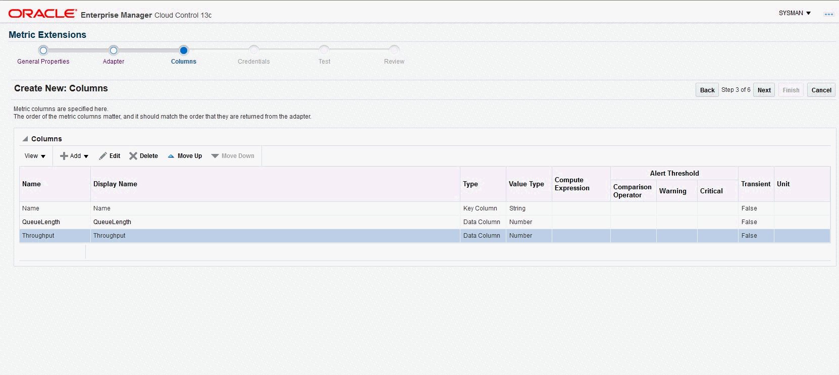

  6. このメトリックの列を指定します(以前に「MBeanの参照」手順を使用している場合、これらの列は自動的にインポートされます)。キー列である列を指定するには、MBeanの参照ウィザードで、これらのあらかじめ作成されている列を編集する必要があります。これは、「メトリック」プロパティの以前の手順でMbeanパターンが指定された場合に行います。このメトリック拡張が適用されるターゲット・インスタンスでは、複数のMbeanがこのMbeanパターンに一致する可能性があります。
    (「上に移動」と「下に移動」ボタンを使用して)列の順序を変更する場合、以前の手順の「列の順序」プロパティのセミコロン区切り列の対応する順序も適宜更新する必要があります(「戻る」を使用)。
    画像は、列の指定示しています。

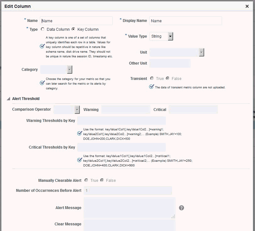

    次の図に示すように、必要に応じて、これらをキー列にするように列を編集します。
    画像は、キー列の作成を示しています。
    列にラベルを付けて編集したら、「次へ」をクリックします。これで、メトリック拡張をテストする準備ができました。

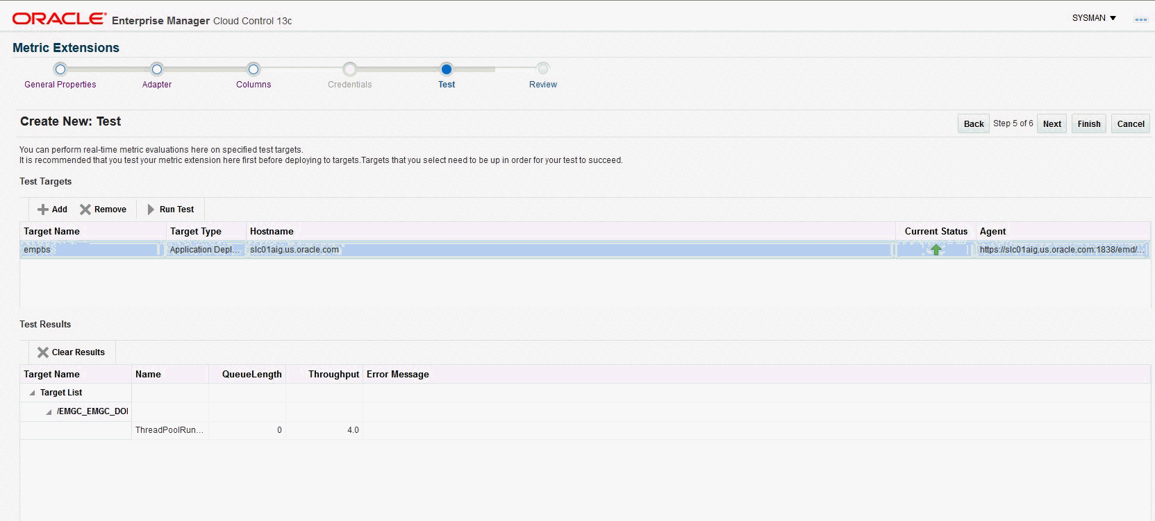

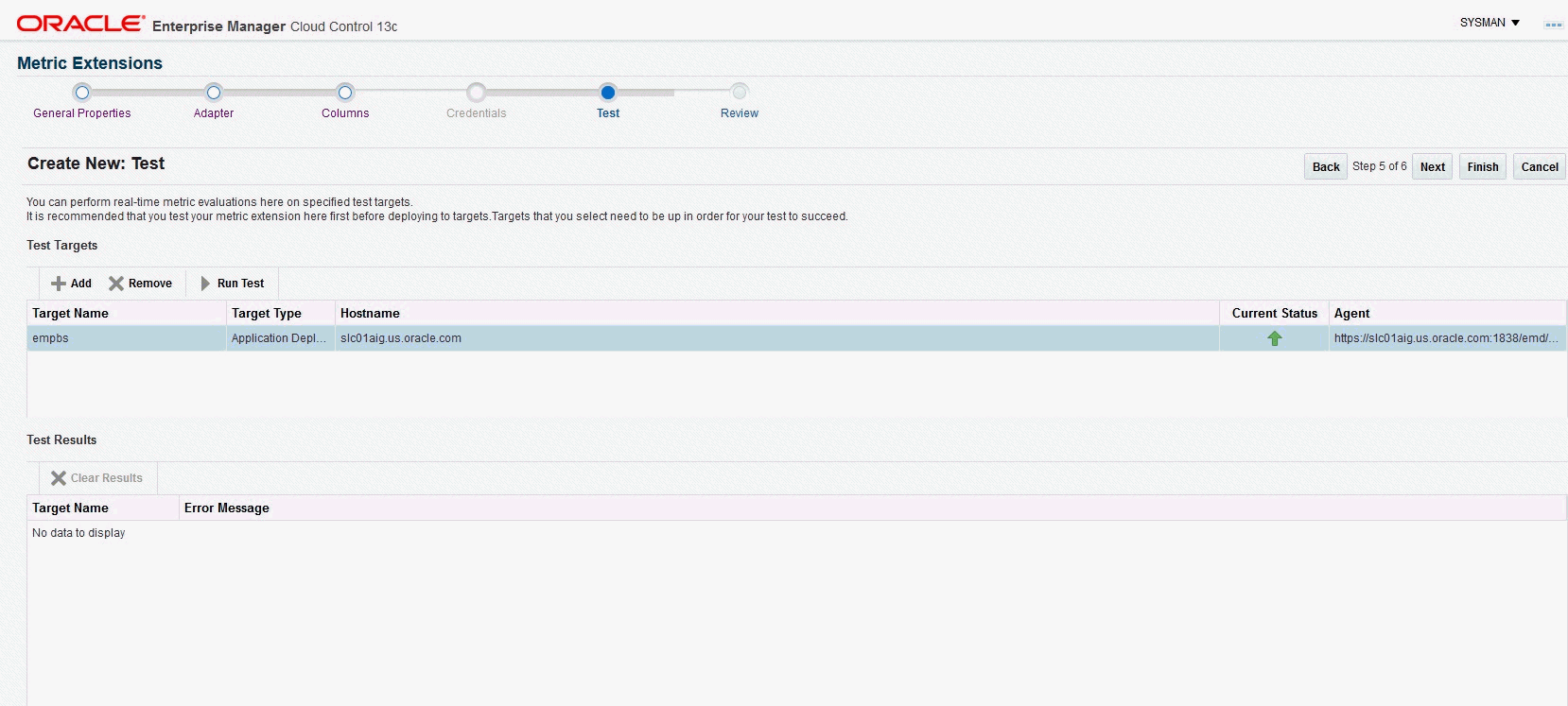

  7. 「追加」をクリックして、このメトリック拡張をテストするターゲット・インスタンスを選択します。これは、できればメトリック拡張の定義に使用されたものとは別のターゲット・インスタンスにします(以前にメトリック拡張の定義に「MBeanの参照」ボタンを使用した場合)。
    画像には、ターゲットのテストが表示されています。
    「ターゲットのテスト」表でターゲット・インスタンスを選択して、この表の上にある「テストの実行」をクリックします。
    「テストの実行」表にメトリック値が表示されます(エラーがある場合はエラーも表示されます)。
    エラーがある場合は、「戻る」をクリックしてエラーを修正し、テストを再実行します。
    画像には、成功したテストが表示されています。

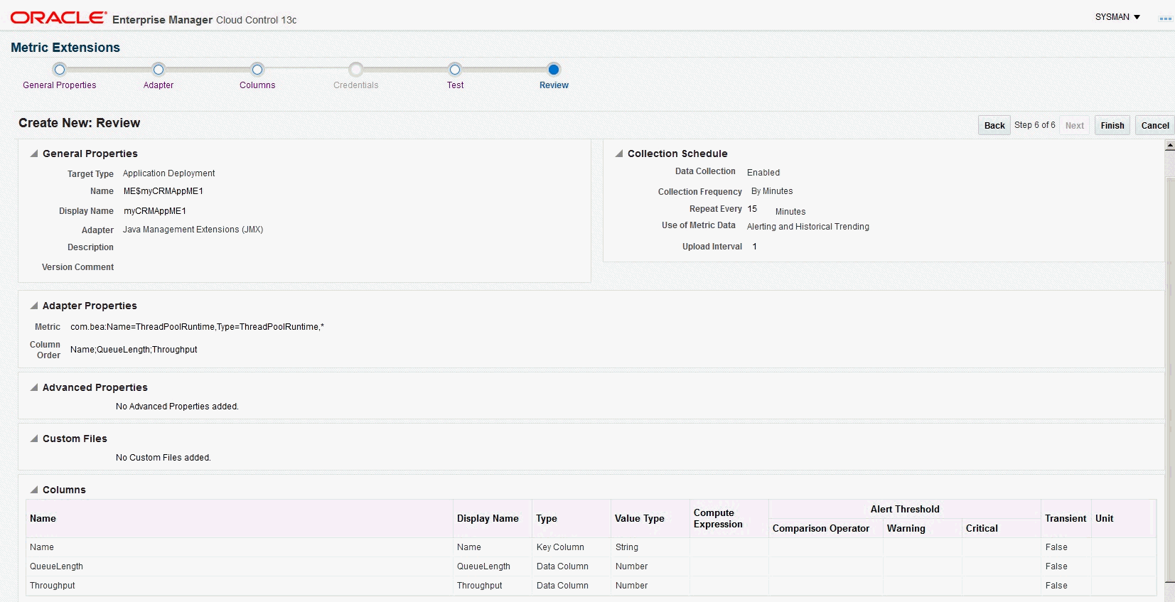

  8. テストが成功したら、「次へ」をクリックしてメトリック拡張のサマリーを表示し、「終了」をクリックしてメトリック拡張を定義します。
    画像は、メトリック拡張の確認を示しています。

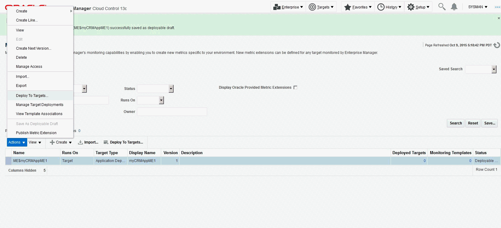

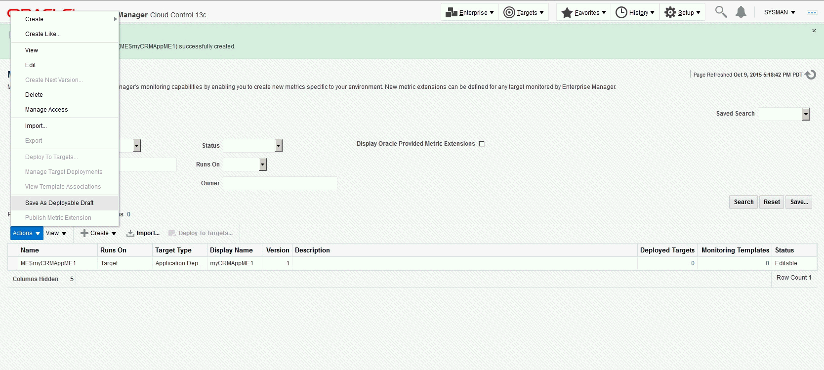

  9. 選択したターゲット・インスタンスにメトリック拡張をデプロイする前に、「デプロイ可能な下書き」にメトリック拡張を保存する必要があります。これにより、メトリック拡張のデザイナは、選択したターゲット・インスタンスにメトリック拡張をデプロイして、メトリック収集を検証できます。ただし、メトリック拡張がテストされてデザイナが満足する結果になるまで他の管理者がこのメトリック拡張をデプロイすることはできません。
    画像は、デプロイ可能な下書きへのメトリック拡張の保存を示しています。
  10. 作成されてデプロイ可能な下書きに保存されたメトリック拡張を選択します。「アクション」メニューから、「ターゲットにデプロイ」を選択します。
    画像は、ターゲットにデプロイする下書きを示しています。

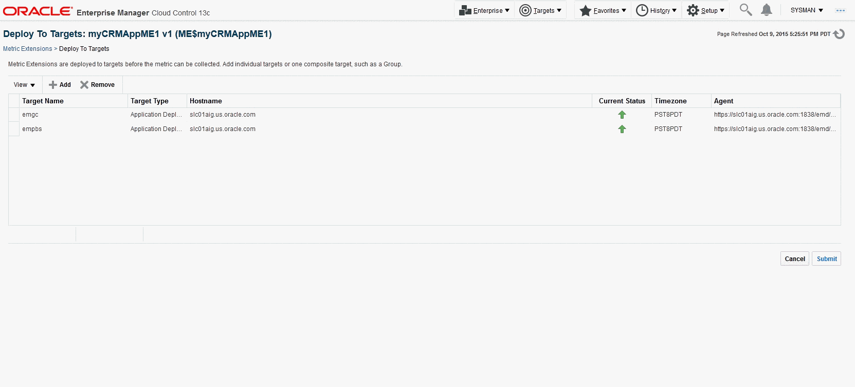

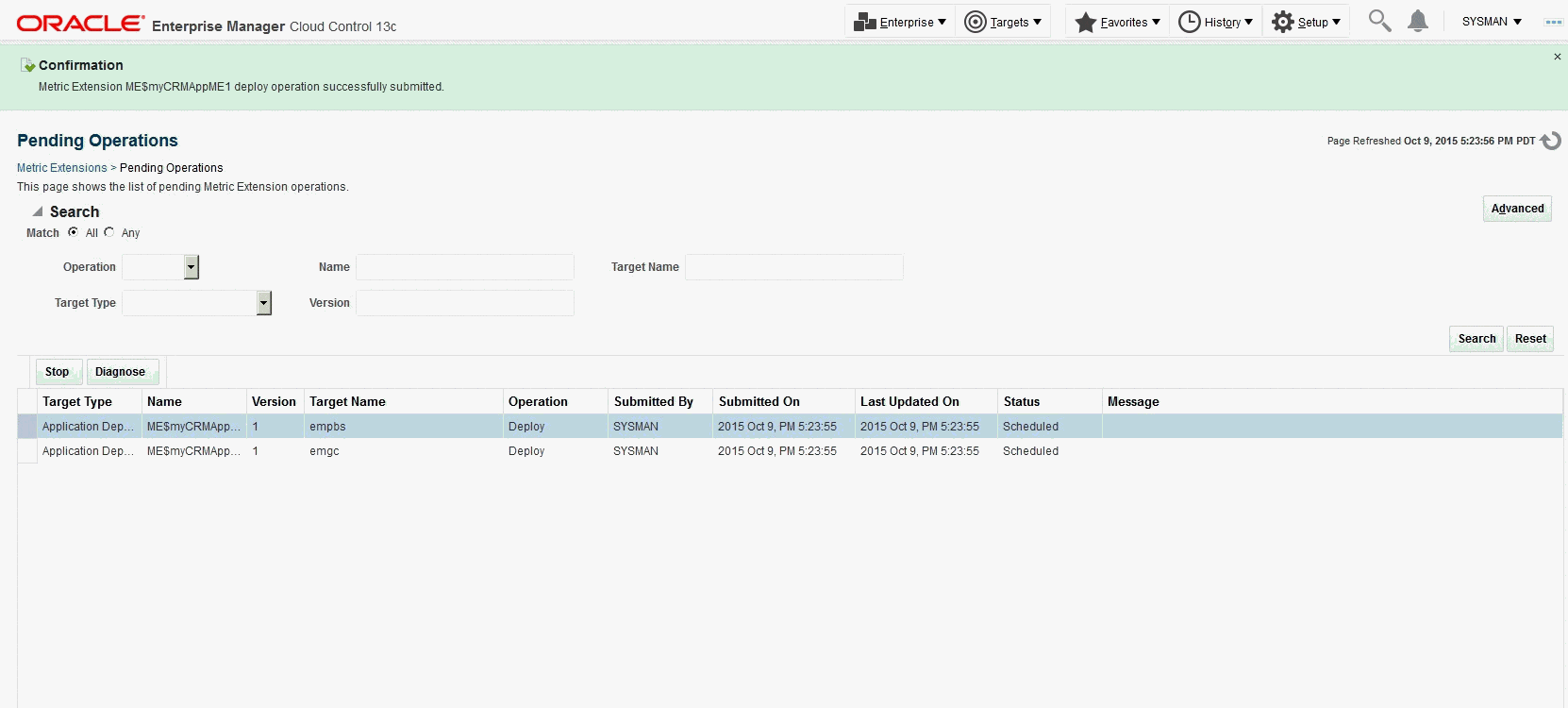

  11. このメトリック拡張をテストする必要があるターゲット・インスタンスを選択して、「発行」をクリックします。たとえば、メトリック拡張が「アプリケーション・デプロイメント」ターゲット・タイプで定義され、カスタムJ2EEアプリケーションで登録されるカスタムMbeanのメトリックを表す場合、そのカスタム・アプリケーションのインスタンスを選択できます。これにより、選択したターゲットを監視する管理エージェントにメトリック拡張を非同期にデプロイするジョブがスケジュールされます。
    画像は、ターゲットのデプロイメントを示しています。
  12. このページを定期的にリフレッシュすることで、選択したターゲットへのメトリック拡張のデプロイが保留になっている操作のステータスを監視し、デプロイメントで発生する可能性のあるエラーについて「ステータス」列と「失敗したデプロイ操作」表を監視します。
    画像は、保留中のデプロイ操作ページを示しています。

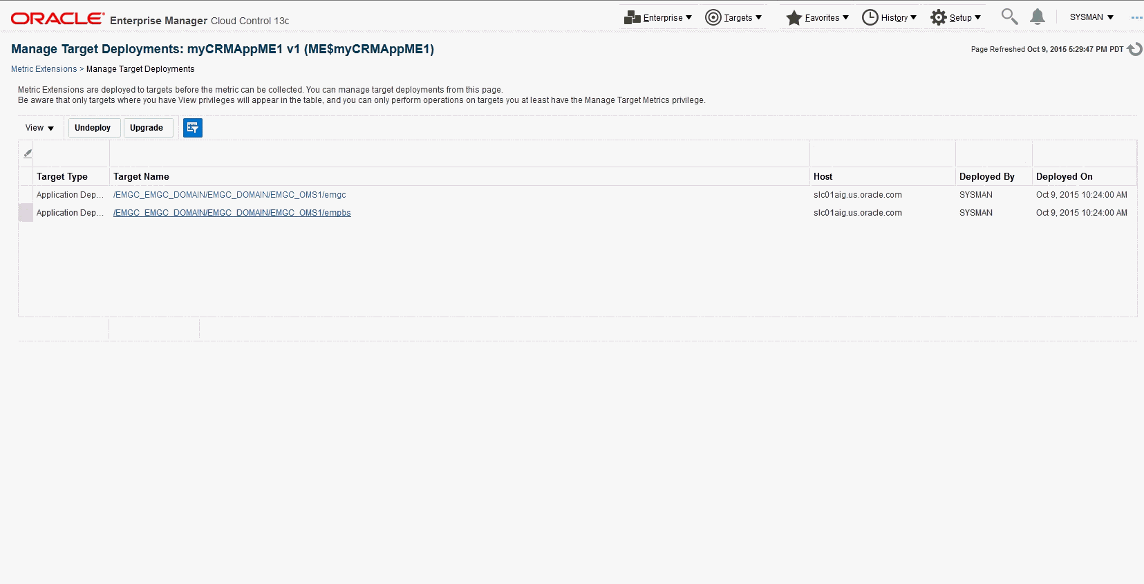

  13. 「エンタープライズ」メニューから、「監視」、「メトリック拡張」の順に選択します。「メトリック拡張」ホームページには、メトリック拡張が表の行として表示されます。この表の「デプロイされたターゲット」列は、このメトリック拡張がデプロイされるターゲットの数を表します。
    「アクション」メニューで、目的のメトリック拡張の選択後に表から「ターゲット・デプロイメントの管理」を選択します。これにより、このメトリック拡張がデプロイされるターゲット・インスタンスが表示されます。
    画像は、MEページの新しいメトリック拡張を示しています。

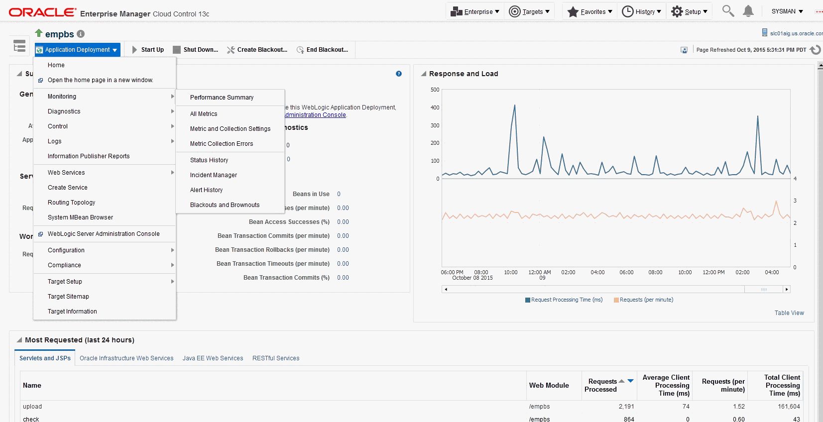

  14. メトリック拡張を検証するターゲット・インスタンスの「ターゲット名」列で値をクリックします。ターゲットのホームページに移動します。
    画像は、ターゲット・デプロイメントの管理ページを示しています。

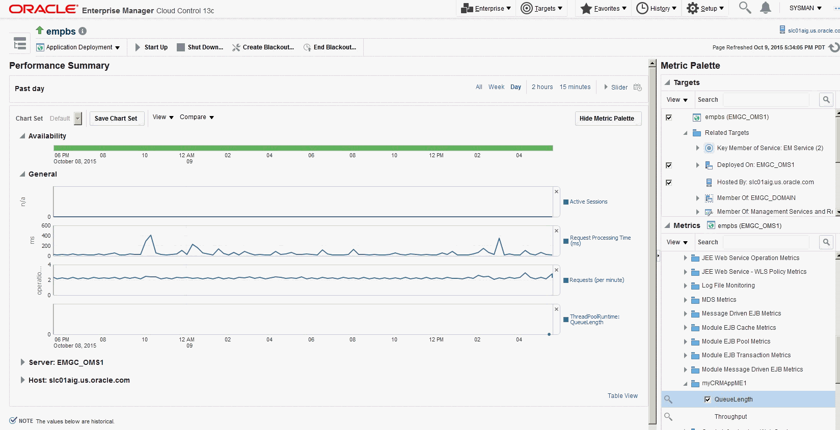

  15. ミドルウェア・ターゲットの場合、「ターゲット・タイプ」→「監視」→「パフォーマンス・サマリー」(または、一般的に「ターゲット・タイプ」→「監視」→「すべてのメトリック」)ページにナビゲートします。
    画像は、ミドルウェア・ターゲットの監視を示しています。
  16. 「パフォーマンス・サマリー」ページでは、新しく作成されたメトリックが「メトリック・パレット」に表示され、このページでそのメトリックを選択してチャート化できます。
    画像は、パフォーマンス・サマリー・ページを示しています。

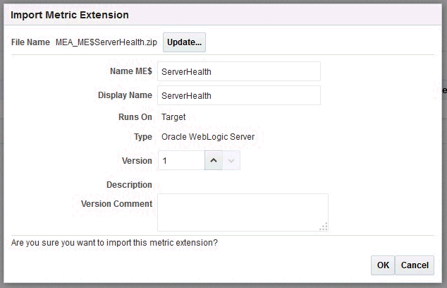

    前述のセッションでは、jmxcliを起動すると、-wオプションで指定されたディレクトリ(または-wオプションを指定しない場合は現在のディレクトリ)にZipファイルMEA_ME$myAppME_1.zipが作成されます。
    次に示すように、これをEnterprise Managerコンソールにインポートします。「エンタープライズ」メニューから、「監視」→「メトリック拡張」を選択して「メトリック拡張」ホームページにアクセスします。
    画像は、Enterprise Managerのメトリック拡張を示しています。
    前述の例のようにメトリック拡張アーカイブをインポートすると、そのアーカイブを編集(および修正)、テスト、公開およびデプロイできます。
