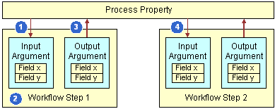

Figure 13 describes how Siebel CRM uses a process property in a workflow process.
Figure 13. How Siebel CRM Uses a Process Property in a Workflow Process
Explanation of Callouts
Siebel CRM does the following when it uses a process property in a workflow process:
  1. The process property sends data to Workflow Step 1 as an input argument.
  2. Workflow Step 1 modifies the data according to the configuration for Step 1.
  3. An output argument on Workflow Step 1 sends data from the step to the process property.
  4. An input argument on Workflow Step 2 brings the data that Step 1 uses into Workflow Step 2, where the workflow process can use it according to the internal configuration that is defined for workflow Step 2.
