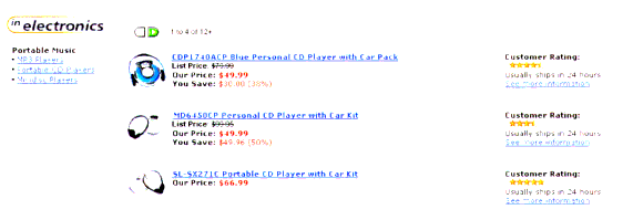

Configuring Siebel Business Applications > About Siebel Web Templates and Siebel Tags > About Applet Web Templates > About Catalog List Applets and Rich List TemplatesA catalog list applet or a rich list template supports a layout that is similar to a catalog. Siebel CRM can display a catalog in a view that references applets that maintain a parent and child relationship. You can display records from the parent applet and the child applet so that Siebel CRM interweaves them with each other. Example of an Applet That Interweaves RecordsFigure 29 describes an example of an applet that interweaves records. Note how Siebel CRM interweaves records in this example:
To create this layout, the parent and child applets are list applets. The parent applet is a root level applet. You can use more than one root level applet to display more than one set of parent-child relationships in a view. The Position Property Defines Relationships Between AppletsThe Position property of the view web template item defines the relationship that exists between the applets. It works similarly to the Position property of the tree node. The root level applets contain position values, such as 1, 2, and so on. You assign the immediate child applets of the applet with position 1 with position values 1.1, 1.2, and so on. You can define third level applets with position 1.1.1, 1.1.2, and so on. These third level applets are child applets of the applet with position 1.1. For more information, see Defining the Position Property of a Tree Node. Tags That Define the Layout for Nonroot AppletsThis topic describes tags that define the layout for nonroot applets layout. Siebel CRM only supports applets in the base mode in this layout. Note the following:
