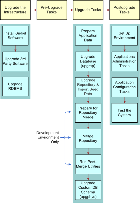

The basic flow of the upgrade process is shown in Figure 2.
NOTE:  In production test environment and production environment upgrades, the upgrep + upgphys steps are run together and there are several additional deployment steps.
Figure 2. Flow of the Upgrade Process
Upgrade the Infrastructure
The first phase is to upgrade your hardware and software to meet system and implementation requirements, which includes upgrading the Siebel Enterprise Server to the new release. This action upgrades the Siebel Servers and provides the programs, scripts, input files, and other files required to merge the repository and upgrade the Siebel database. For information on how to upgrade the infrastructure, see Siebel Installation Guide for the operating system you are using.
Perform Preupgrade Tasks
This phase prepares the Siebel database for upgrade and includes such tasks as closing database connections, clearing pending workflow tasks, disabling customized triggers and editing and validating the storage control file.
NOTE:  The Siebel upgrade process is not designed to support custom database triggers. If you have created customized triggers for the Siebel schema to be upgraded, you must remove them before starting the Siebel upgrade process. You can re-create these objects once the Siebel upgrade completes successfully.
Perform Upgrade Tasks (Development Environment)
This phase merges your customizations into the new release. This phase also upgrades the development environment database and includes these tasks:
  • Prepare application data. These tasks prepare test data for migration.
  • Upgrade database (upgrep). Run the Database Configuration Wizard in upgrep mode, selecting the zSeries Staging of Files for Upgrade option. This generates the files required to build the staging database and generate the upgrade files required to perform the in-place upgrade of the database.
  • Perform the in-place upgrade of the database. During this phase, a basic upgrade of the Siebel database schema is performed and repositories are loaded to prepare for the repository merge.
