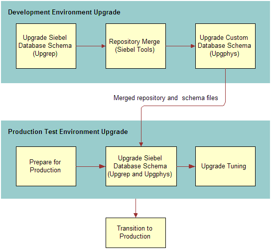

Figure 3 shows how the Database Configuration Wizard (and Siebel Upgrade Wizard) work together with the Siebel Tools repository merge to upgrade your environments.
NOTE:  The Prepare for Production step is required for upgrades from Siebel CRM version 7.5.3 only.
Figure 3. Upgrade Flow
