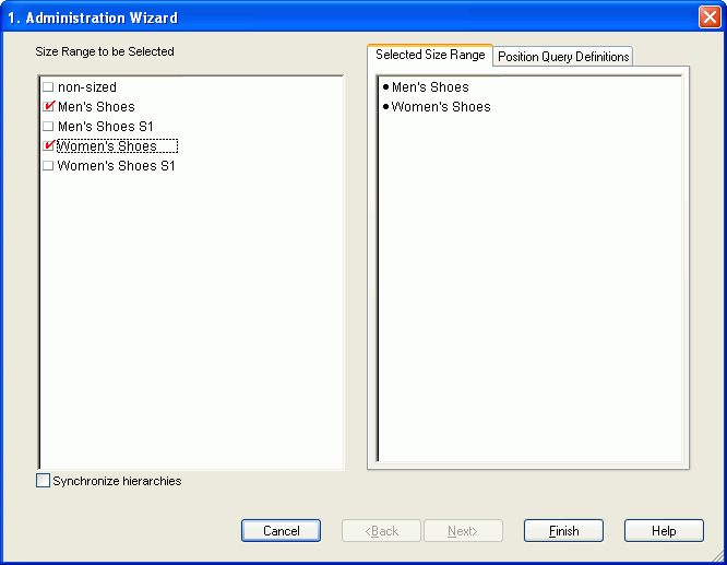

To open the Administration Workbook:
  1. From the File menu, select New or click the New button.
  2. On the SizeOpt tab, select 1. Administration and click OK.
    Figure 2-1 Creating a New Administration Workbook
    Admin Workbook
  3. The Size Range to be Selected screen appears. Select the desired size range and click Finish.
    Figure 2-2 Administration Workbook Wizard - Size Range to be Selected Screen
    The size range selections apply only to the specification of kink exception thresholds in the Alert Thresholds tab.
    The Administration Workbook is built.

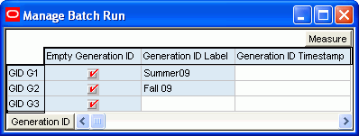

Manage Batch Run Worksheet
This worksheet is used to trigger the generation (or re-generation) of size profiles associated with each generation ID.
Figure 2-3 Manage Batch Run Worksheet
Manage Batch Run
The following table describes the measures available on this worksheet:
Table 2-1 Manage Batch Run Worksheet Measures
Measure Description
Empty Generation ID
This indicates to the SPO batch that it is empty, and the SPO batch can reuse the generation ID.
Generation ID Label
A user-specified descriptive label for the profile generation ID.
Generation ID Timestamp
This is updated upon successful completion of the SPO batch. It indicates the timestamp of the previous SPO run associated with the generation ID.

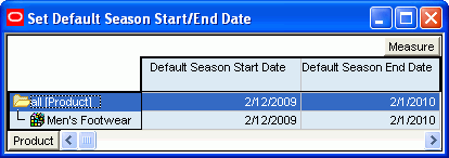

Set Default Season Start/End Date Worksheet
The set default season start/end date worksheet is used to set different start, and end dates for the season for each of the size ranges that are being optimized.
Figure 2-5 Set Default Season Start/End Date Worksheet
Default Dates Worksheet
Table 2-3 Season Start/End Date Worksheet Measures
Measures Description
Default Season Start Date
Used for fashion items, this indicates the season start date. It is used for preprocessing.
Default Season End Date
Used for fashion items, this date indicates the season end date. It is used for preprocessing.

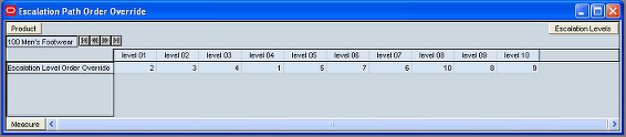

Escalation Path Order Override Worksheet
Use this step to override the default escalation path that was displayed in the Escalation Path Management worksheet. In this worksheet specify the escalation path overrides at the escalation path override level.
Figure 2-7 Escalation Path Order Override Worksheet
Table 2-5 Escalation Path Order Override Worksheet Measures
Measure Description
Escalation Level Order Override
The escalation level orders that override the default orders.

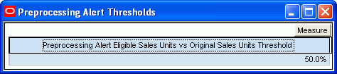

Preprocessing Alert Threshold Worksheet
This worksheet allows users to review and modify alert thresholds for preprocessing alerts.
Figure 2-8 Preprocessing Alert Threshold Worksheet
Alert Threshold
The following table describes the measures available on this worksheet.
Table 2-6 Preprocessing Alert Threshold Worksheet Measures
Measure Description
Preprocessing Alert Eligible Sales Units vs Original Sales Units Threshold
The threshold used by the Preprocessing Alert. This alert compares the original unfiltered sales to the filtered sales. If the ratio of the total filtered sales for the SKU/store to the total original unfiltered sales exceeds this threshold, then this implies the system has preprocessed too many sales and the alert parameter is set to true.

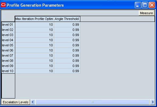

Profile Generation Parameters Worksheet
The Profile Generation Parameters worksheet allows users to review and modify parameters used to calculate profiles at various escalation levels based on the escalation level's intersection.
Figure 2-11 Profile Generation Parameters Worksheet
Table 2-9 Profile Generation Parameters Worksheet Measures
Measure Description
Angle Threshold
This is used by the Optimized Size Profile method. The method calculates size profiles iteratively, and calculates the angle between the size profile from a given iteration to the size profile from the previous iteration. If the angle falls within the specified threshold, the system will stop iterating.
Max Iteration Profile Optimization
This is used by the Optimized Size Profile method. This indicates the maximum number of iterations after which the algorithm will stop and return size profile from the last iteration.

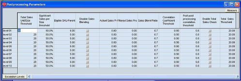

Postprocessing Parameters Worksheet
Post processing is performed to check size profiles for accuracy and reject or prune size profiles if they do not meet accuracy criteria. The Postprocessing Parameters worksheet allows users to review and modify post processing parameters that drive the criteria for size profile accuracy.
SPO primarily performs the following types of postprocessing:
  • Blending or comparison to sales size profiles
  • Comparison to chain size profiles
  • Significant sizes check
  • Total sales check
  • Contributing number of SKU parent/store/weeks check
In addition, the system also looks for kinks in size profiles. This functionality is described in the "Kinks and Kink Exceptions" and in the "Size Range Management Workbook" chapters.
Figure 2-12 Postprocessing Parameters Worksheet
Table 2-10 Postprocessing Parameters Worksheet Measures
Measure Description
Total Sales Unit/Size Threshold
Total sales units per size for the size to be considered significant. Significant sizes are used to determine if a size profile is reliable; for example, if a size profile does not have sufficiently significant sizes, it is rejected by the system.
Significant Sales per Size Threshold
If the percentage of significant sales per size for a given size profile falls below the threshold defined by this measure, the size profile is rejected. The size is considered significant if the total sales units value for the size exceeds the value in the Total Sales Unit/Size Threshold.

When sales blending is turned off and system compares calculated size profiles against normalized actual unfiltered historic sales and rejects size profiles if significantly different.
Actual Sales Profile Correlation Comparison Threshold
If correlation of calculated size profile to normalized unfiltered sales is less than this threshold, system will automatically prune the size profile.
Filtered Sales Profile Correlation Comparison Threshold
If correlation of calculated size profile to normalized filtered sales is less than this threshold, system will automatically prune the size profile.
Sales Blend Ratio
Used only when Enable Normalized multiple is False, this indicates the ratio of unfiltered sales profile (based on actual unfiltered history) to use in the blending process to generate final size profiles.
Correlation Coefficient Threshold
Indicates the minimum correlation coefficient between raw profile and chain level profile. This is used in postprocessing to identify situations where the size profiles do not look in any way similar to the corresponding chain level aggregate size profiles. This check can effectively be disabled by specifying a very low threshold.
Correlation coefficient is an indication of the degree to which two variables (in this case a calculated size profile for a given level and its corresponding chain level size profile) are linearly related.
A correlation coefficient of 1 indicates there is a perfect relationship between the two variables, meaning that whenever one variable has a high (low) value, so does the other.
A correlation coefficient of -1 indicates there is a negative relationship, meaning that whenever one variable has a high (low) value, the other has a low (high) value.
A correlation coefficient of 0 means that there is no linear relationship between the variables.
Correlation coefficient is calculated as:
Where:
  • n = the size length
  • x = the size profile for a given level
  • y = the chain level size profile
  • i = ranges from 1 to n, for each size in the size range
Post processing Correlation Threshold
Indicates the minimum correlation coefficient between a raw profile and a reference profile. The reference profile can be specified during the implementation phase. For instance, the user could specify last year's sales profile or a previously approved size profile.
This is used in postprocessing to identify situations where a computed size profile is highly correlated to the reference profile. If the computed size profile does not meet the minimum correlation, it is not filtered out, irrespective of its postprocessing.
Enable Total Sales Check
Enable this check to see if the total eligible sales that were used for calculating the size profile are below a certain threshold. If the total contributing sales is below this threshold, the size profile is pruned or rejected. The threshold is specified in the Total Sales Check Threshold measure.
Total Sales Threshold
This is used when the Enable Total Sales check flag is set to True. If the total contributing sales is below this threshold, the size profile is pruned or rejected.
