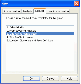

To open the Size Range Management workbook:
From the File menu, select New or click the New button.
On the SizeOpt tab, select 3. Size Range Management and click OK.

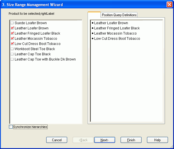

The Size Range Management wizard screen is displayed. Select the products you want to examine, and click Next.

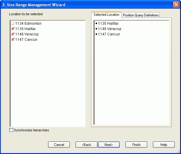

The locations are displayed on the Size Range Management Wizard. Choose the locations, and click Next.

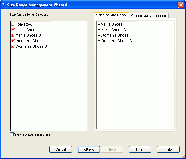

The Size Range to be Selected screen is displayed. Select the size ranges you want to examine, and click Finish.
The Size Range Management Workbook is built.

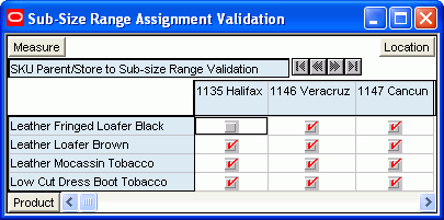

The Sub-Size Range Assignment Validation worksheet is used to display the stores for which valid size ranges are available. This worksheet is used to ensure that each of the stores is mapped to one of the available sub-size ranges.
The following table describes the measures available on this worksheet:
