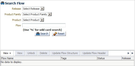

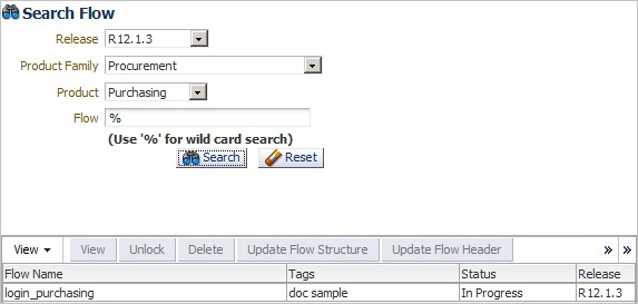

The Search pane of the Flow page lets you search for specific flows:
You can select the Release, Product Family, Product, and Flow to narrow the search criteria. You can also use the % wildcard character in the Flow field to narrow the search:
Figure 5-6 Search Flow Options with Search Criteria

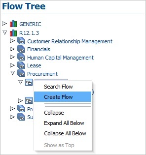

Expand the Flow Tree to the product feature where you want to add the flow.
Right-click the Feature name and select Create Flow from the shortcut menu
Figure 5-7 Create Flow Option of the Shortcut Menu

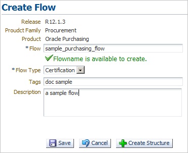

In the Create Flow pane, enter a Flow name, Flow Type, Tags and Description.
The flow name should be between 5 and 30 characters. The Flow name is available to create check mark appears if the name does not currently exist in the database.

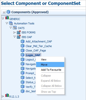

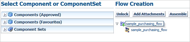

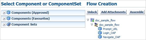

Click Create Structure. The Select Component or Components Set and the Flow Creation pane opens for specifying the components or component sets to add to the new flow and a new scenario is added to the flow tree. A scenario defines a specific OpenScript child script name within the overall flow. See Section 5.2.1, "Adding Scenarios to a Flow" for additional information about adding scenarios to a flow.

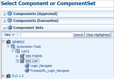

Expand the Flow tree and select the scenario where you want to add components or component sets.
Expand the Components (Approved), Components (Favourites), or Components Sets tree to view the available components or component sets.

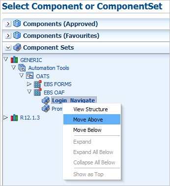

Figure 5-11 Select Component Set Pane Shortcut Menu
Right-click the component or component set to add to the Flow Creation tree and click Move (or click and drag the component or component set to the flow tree).
Figure 5-12 Flow Creation Pane with Components Added
Repeat steps 5-7 to add additional components or component sets to the Flow Creation tree as needed. Select Move Above or Move Below to add the component or component set above or below the currently selected component or component set in the Flow Creation tree.

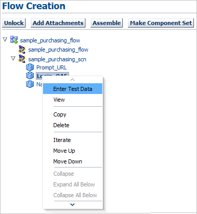

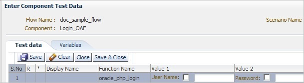

Right-click a component in the Flow and select Enter Test Data from the shortcut menu. You can also download a Test Data Excel file for the flow, enter the test data for the flow into the Excel file, then upload the Excel file. See Section 5.2.2, "Entering Test Data Using an Excel File" for additional information about entering test data using an Excel file.
Figure 5-14 Flow Creation Pane Enter Test Data Shortcut Menu Option
Enter the test data required for the component.
Figure 5-15 Enter Component Test Data Window

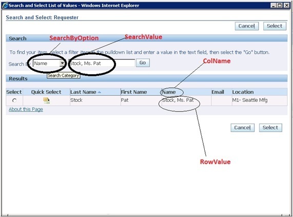

WEBSELECTLOV Function: Test data entry for the WEBSELECTLOV Function corresponds to the following:
Figure 5-18 Test Data Locations for WEBSELECTLOV Function

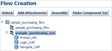

When you create a flow structure, a scenario name is automatically created to define the OpenScript child script name. Each scenario in a flow corresponds to an OpenScript child script. A flow may have only one scenario or it can have multiple scenarios depending upon the flow and the automation process the flow designer is developing.
The number of scenarios in a flow depends upon the user/automation process the flow designer is developing.
If the flow is small requiring only a few steps (components or component sets) to complete the flow, only one scenario may be required which will create the MASTERDRIVE script and one OpenScript child script. There is no need to add additional scenarios to the flow.
If the purpose of the flow is to automate multiple functional scenarios in one flow, then the better practice is to break the flow into multiple scenarios (and create multiple OpenScript child scripts) under one flow.
If a flow is to automate a lengthy end-to-end scenario, the better practice is to break the flow into multiple simple scenarios to make it easier to execute and troubleshoot the OpenScript child scripts, if necessary.

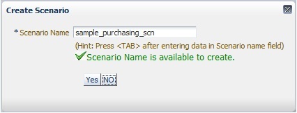

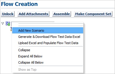

To add scenarios to the flow tree:
Open the flow tree and select the flow name.
Right-click the flow name and select Add New Scenario from the shortcut menu.
Figure 5-19 Add New Scenario Shortcut Menu
Enter a scenario name, then press the Tab key. The Scenario Name is available to create check mark appears if the name does not currently exist in the database.
Click Yes.
Click OK to confirm.
Add components and/or component sets to the flow tree under the scenario name.
When you generate the OpenScript scripts, each scenario name will correspond to an OpenScript child script along with the MASTERDRIVE script.

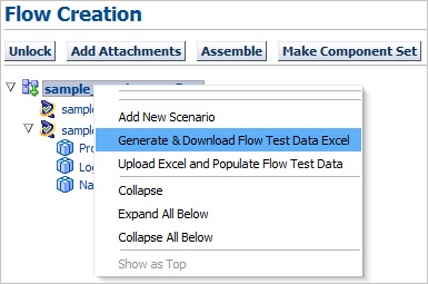

You can enter test data for an entire flow into an Excel file and then upload the Excel file to the flow. The basic steps are as follows:
Download the test Data Excel file for the flow.
Enter the test data into the Excel file.
Upload the test data Excel file to the flow.
Populate the flow with the test data.
To enter test data for a flow using an Excel file:
Create a new flow or search for an existing flow.
Select Update Flow Structure.
Right-click the flow name in the Flow Creation pane and select Generate & Download Flow Test Data Excel from the shortcut menu.
Figure 5-21 Flow Creation Pane Generate & Download Excel Shortcut Menu Option
Select Save and specify the location to save the Excel file.
Edit the Excel file to enter the test data for the flow and save the Excel file.

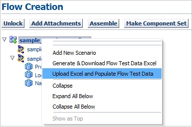

Right-click on the flow name in the Flow Creation pane and select Upload Excel and Populate Flow Test Data from the shortcut menu
Figure 5-22 Flow Creation Pane Upload Excel Shortcut Menu Option
Select the Excel file for the flow test data and click Start. Close the Browse dialog box after successfully uploading the file. The data will be populated to all components in the flow.

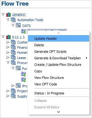

To update a flow header:
Expand the Flow Tree to the flow you want to update.
Right-click the flow name and select Update Header from the shortcut menu.
Figure 5-23 Update Header Option of the Flow Tree Shortcut Menu
In the Update Flow pane, edit the Release, Product Family, Product, Flow name, Flow Type, Tags and Description.
Click Save when finished to save and exit the Update Component Set pane. The Search pane indicates Updated Flow <name> Successfully.

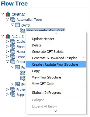

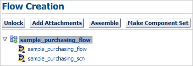

Right-click the Flow name and select Create/ Update Flow Structure from the shortcut menu.
Figure 5-25 Create/Update Flow Structure Option of the Flow Shortcut Menu

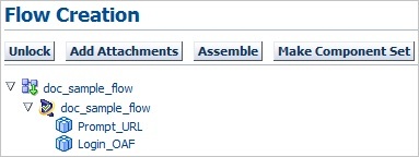

The Select Component or Components Set and the Flow Creation pane opens for specifying the components or component sets to add or update in the Flow.
Figure 5-27 Select Component Set Pane with Expanded Components Tree
Expand the Flow Creation tree to view the existing components or component sets.
Figure 5-28 Flow Creation Pane with Components Added

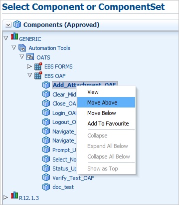

Select a component or component set in the Flow Creation tree where you want to add the new component or component set.
Right-click the component or component set in the Select Component (Approved), Select Component (Favourites) or Component Set tree that you want to add to the Flow Creation tree and click Move Above or Move Below.
Figure 5-29 Move Options of the Shortcut Menu

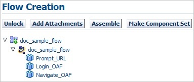

Repeat step 7 to add additional components or component sets to the Flow Creation tree Component Set as needed.
Figure 5-30 Flow Creation Pane with Additional Components Added

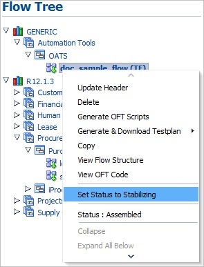

Click Assemble when finished to change the flow status to Assembled and unlock the flow. The Search pane indicates Assembled Flow Successfully.
To change the flow to Stabilizing status, right-click the flow name in Flow Tree and select Set Status to Stabilizing.
Figure 5-31 Flow Tree Set Status to Stabilizing Shortcut Menu Option

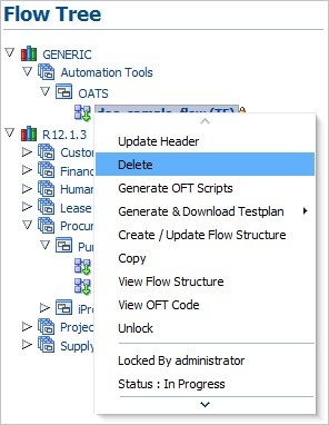

To delete flows from the Flow tree:
Expand the Flow Tree to the flow you want to remove from the flow tree.
Right-click the Flow name and select Delete from the shortcut menu.
Figure 5-32 Delete Flow Option of the Shortcut Menu
Click Yes to confirm.
Click OK.

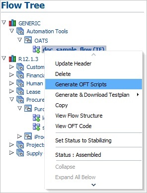

To generate OpenScript script code from an existing flow:
Expand the Flow Tree or use the search options to select the flow to use to generate OpenScript code.
Select Generate OFT Scripts from the Flow Tree shortcut menu or the search pane.
Figure 5-33 Generate OFT Scripts Option of the Shortcut Menu
Enter the Execution location folder.
Enter the Normal wait time.
Enter the Page wait time.
Select if the script is rerunable or not.
If Rerunable, select the time zone, specify the Rerun type.
Select the time zone.
Click Download Suite.
Extract the zip file into the OpenScript repository.
Start OpenScript.
Open and playback the MASTERDRIVE script located in the flowname folder. The MASTERDRIVE script executes the script containing the OpenScript code for the flow. You can also open the script with the flow code in OpenScript to view the Tree View and Java Code.

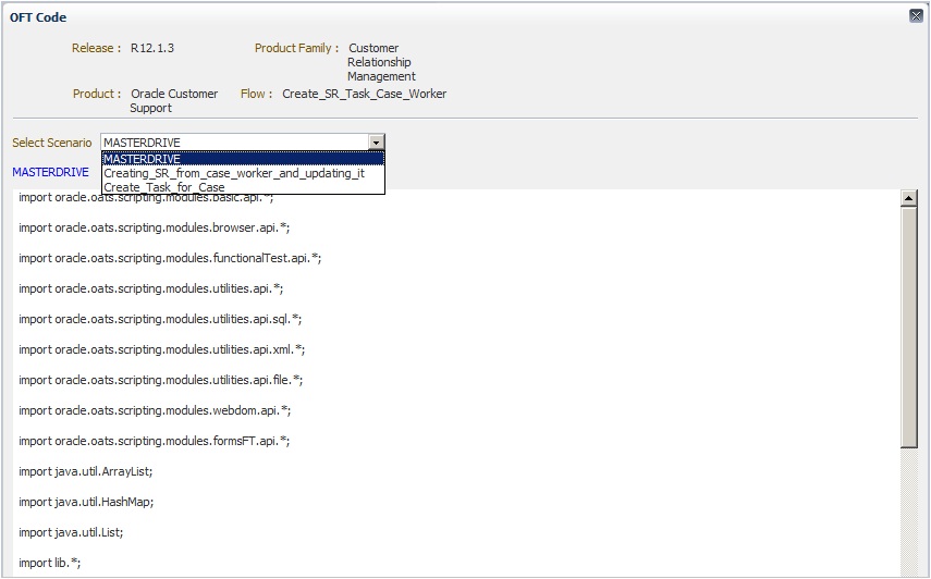

To view OpenScript script code from an existing flow:
Expand the Flow Tree or use the search options to select the flow to use to view OpenScript code.
Select View OFT Code from the Flow Tree shortcut menu.
Figure 5-34 View Code Window Showing OpenScript Code for a Flow
Select the MASTERDRIVE or flow scenario name from the Select Scenario list to view the OpenScript code for the specific flow.
Click the [X] button to close the code view when finished.
