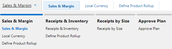

Step 1: Sales & Margin
The first step in the Item Planning @ Store process is Sales & Margin. This step is used to define parameters such as whether the item will be assorted in a particular store and to make adjustments of regular, promotional, and clearance sales at the item/location level.
The steps to complete this process:
  • Seed sales.
  • Seed like items, if necessary.
  • Set VAT rate.
  • Plan regular, promotional, and clearance sales and margin.
Figure 16-2 Sales & Margin Step
Surrounding text describes Figure 16-2 .
Prior to Starting this Step:
  • Cluster level item plans should be approved.
After Completing this Step:
  • Plan receipts and inventory based on the sales plan.
Tabs and Views in this Step:

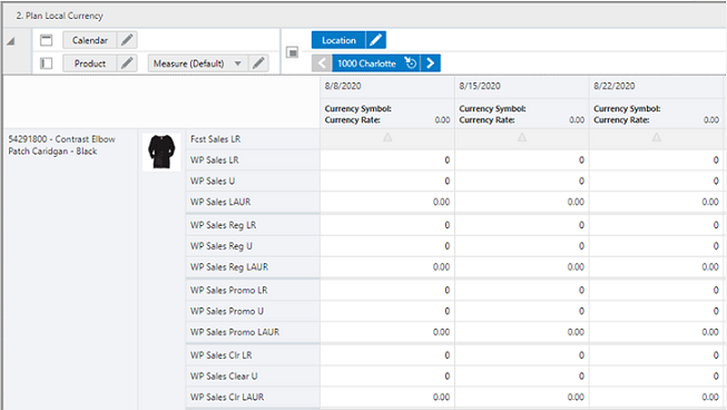

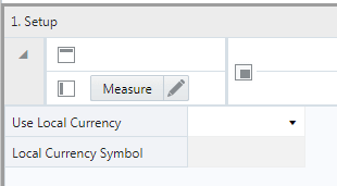

Local Currency Process Extension
If your business is using the local currency function, follow this process:
  • Go to the Local Currency tab and Setup view and select the currency you wish to plan in from the Use Local Currency measure picklist.
  • Run the Convert Local Currency Application Action.
  • Go to the Plan Local Currency view to plan item level sales in the local currency.
    Note that local currency is denoted by an L in the measure name to indicate Local Currency, for example, WP Sales LR.

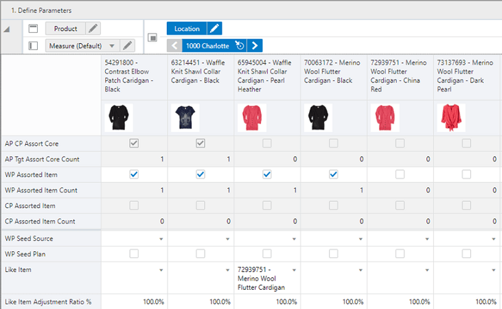

1. Define Parameters View
The Define Parameters view is used by the planner to define which items will be assorted by location, select a sales seed source, and seed like items, if necessary.
  • Review the WP Assorted Item Boolean flag measure and ensure it is checked for each valid item location.
    Only item/location combinations with the WP Assorted Item measure set to true will receive a seeded sales plan.
  • Review the CP Assorted Item measure to understand if there are differences between the Item Planning @ Cluster plan and the exception plan that you are creating.
  • If Assortment Planning & Optimization Cloud Service is in use, review the AP CP Assort Core measure to understand which items are assorted in the Assortment Plan.
  • In the WP Seed Source picklist, select a seeding source.
    Assort Plan - The Assortment Planning Current Plan (CP) units will be spread based on the Item Planning @ Cluster sales curve.
  • The units will be seeded, then multiplied by the Item Price to calculate the Sales Retail.
  • Only Sales Retail, Units, and AUR are seeded with this option:
    • Last Year - Sales, Returns, Receipts, Transactions, and Traffic are seeded with this option.
    • Forecast - Units will be seeded, then multiplied by the Item Price to calculate the Sales Retail.
    • Current Plan - Sales, Returns, Receipts, Transactions, and Traffic are seeded with this option.
  • Like Item Seeding - If you want to assign a like item, in the WP Like Item measure, select the existing item to assign to the new item.
    Note that you can use the Search feature to quickly find items with the Add designation so that it is easier to locate new items.
  • Select a Like Item Seed Source:
    Like Item CP and Like Item LY - Sales, Returns, Receipts, Transactions, and Traffic are seeded with this option.
  • In the Like Item Adjustment measure, assign an adjustment ratio for the existing item sales to be copied to the new item.
  • Run the Seed Plan Application Action.
Note that only unelapsed periods will be updated with seeded data.
Figure 16-3 1. Define Parameters View
Surrounding text describes Figure 16-3 .

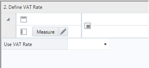

2. Define VAT Rate View
The Define VAT Rate view is used by the planner to choose the VAT Rate used for the category.
The step to complete this process:
  • In the Use VAT Rate picklist measure, select the appropriate VAT rate for the category.
Figure 16-4 2. Define VAT Rate View
Surrounding text describes Figure 16-4 .

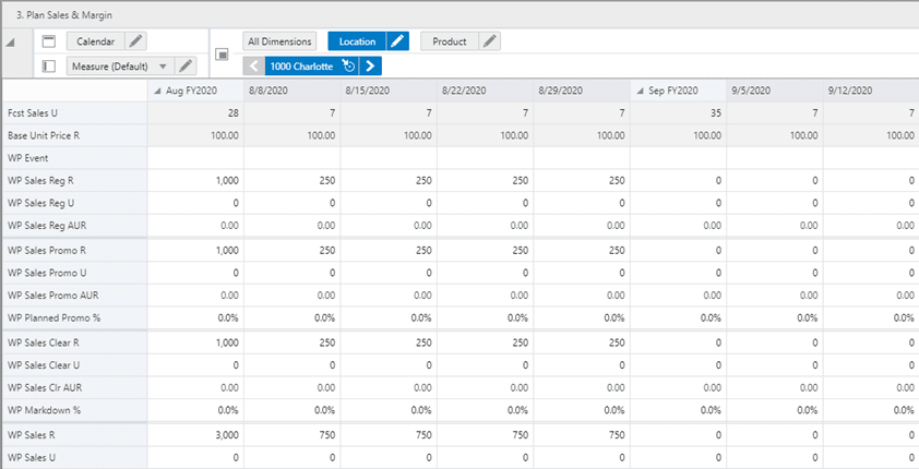

3. Plan Sales & Margin View
The Plan Sales and Margin view is used by the planner to replan regular, promotional, and clearance sales by item and location.
  • Review and adjust each item/week/store Regular, Promotional, and Clearance Sales.
    It is a best practice to seed sales before planning the sales buckets so that there is a demand curve in Reg, Promo, and Clr Sales from which to begin your plan.
    If there is no seeding and no prior data entered, then planning WP Sales will spread proportionally (since there is no demand curve the data will spread evenly) to Reg, Promo, and Clr Sales.
    If that is not the desired behavior, plan Reg Sales, Promo Sales, and Clr Sales before planning Sales, so that a demand curve is in place before planning WP Sales.
  • Review and adjust Sales after having planned Regular, Promotional, and Clearance Sales, if necessary.
  • Review AUC and Gross Margin measures to ensure financial viability of the plan.
Measure Interactions
The following logic is used when planning different types of sales:
  • WP Sales are the aggregation of WP Sales Reg, WP Sales Promo, and WP Clr.
  • Updates to WP Sales will update WP Reg Sales, WP Promo, and WP Clr Sales proportionally.
  • Updates to WP Sales Reg R will hold AUR and recalculate Units.
  • Updates to WP Sales Promo Disc % or the WP Markdown % will apply the entered discount to the WP Promo/Clr Sales AUR, hold the units and recalculate WP Promo/Clr Sales Retail.
  • Updates to WP Sales Promo/Clr R will hold the AUR and recalculate units.

Figure 16-5 3. Plan Sales & Margin View
Surrounding text describes Figure 16-5 .

Local Currency Tab
Process Extension
    Note that local currency is denoted by an L in the measure name to indicate Local Currency, for example WP Sales LR.
1. Setup View
This view is used to elect the currency you wish to plan in from the Use Local Currency measure picklist.

2. Plan Local Currency View
Local Currency refers to the ability to plan in more than one currency if your business operates in multiple countries with different currencies. Multiple currencies and their exchange rates can be managed within Assortment Planning, allowing the planner to choose which currency they would like to plan in. Data will be stored in the one global currency, and within a workbook, users can switch between currencies as business needs dictate.

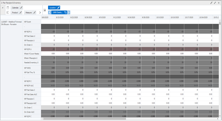

2. Plan Receipts & Inventory View
The Plan Receipts & Inventory view is used by the planner to readjust the receipt plan to meet sales trends based on business knowledge or constraints.
  • Review the WP Receipts U and make adjustments to quantities or delivery weeks based on business knowledge and the updated sales plan.
  • Review the On Order measure to understand when ordered receipts are scheduled to arrive.
  • Review the WP EOP U to ensure there are not over or under stock issues.
    If the receipt plan does not support the sales plan, a Real Time Alert will be activated to alert you that action is needed.
  • The What-If Cover Weeks measure can be used to enter a number of weeks that receipts must cover sales, based on the sales plan and current week BOP.
    For example, if you enter 3, the system will look at 3 future weeks of sales and subtract this week's planned sales, this week's BOP and any planned Safety Stock U.
    The resulting receipt unit need will populate the What-if Receipts U measure.
  • The Needed Inventory U measure compares the WP EOP with Safety Stock U. If WP EOP is less than Safety Stock U, the measure will populate with the unit amount needed to be above the Safety Stock threshold.
  • Review the WP WOS to view the calculated Weeks of Supply based on the sales and receipt plan.
    For each week, WOS is calculated as the number of future weeks of sales covered by the current period's EOP U.
  • Review the WP Sell Thru % as a reference value to see how fast inventory is projected to sell through.
    For each week, Sell Thru % is calculated as Net Sales Units / (BOP U + Receipts U).
  • Review the Cost measures.
  • Repeat this process for each item and location.
  • Once all /locations have been planned, utilize the measure profiles to compare to LY and CP.
Note that you can use Product Attributes to roll up your items by attributes. For example, this can be used to view inventory levels by attributes that are important to the category, to make sure that receipts are invested for important attributes.
Figure 16-13 2. Plan Receipts & Inventory View
Surrounding text describes Figure 16-13 .

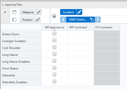

1. Approve Plan View
  • In the WP Approve to CP measure, check the Boolean flag for the subcategories and stores that should be approved.
    If all subcategories and stores should be approved at once, roll up to All Product and All Location and check the Approve to CP measure at that level.
  • In the WP Comment measure, enter approval comments.
    The WP Approval Comments will be copied to the OP Approval Comments and concatenated with the approver's ID, for future reference in this view.
  • Run the Approve Plan Application Action.
Figure 16-20 1. Approve Plan View
Surrounding text describes Figure 16-20 .
Measure Table
Table 16-14 1. Approve Plan View Measures
Label Definition
WP Approve to CP
Boolean flag measure required to be checked in order to approve the Working Plan Item Plan to the Current Plan.
WP Comments
Comments entered here will be copied to the CP Approval Comments and concatenated with the approver's ID, for future reference in this view.
CP Comments
Current Plan comments used as a reference.
Measure Profile
Default Profile
The Default profile is used to approve the Item Plan to the CP version.
Application Action
Approve Plan
The Approve Application Action copies data from the Working Plan (WP) to the Current Plan (CP).
