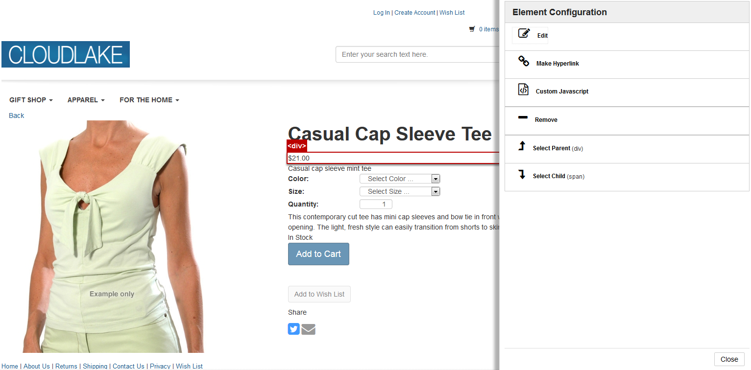

In order to add the offer to the layout, we must edit an element. In this case, we select the <div> element that contains the price. This opens the element configuration panel.
Click on an element to open the element configuration panel
We want to edit the text displayed, so select Edit from the menu displayed. From here you can edit the text displayed in the element using the HTML editor, text editor, style editor, or class editor, or a combination of these.
