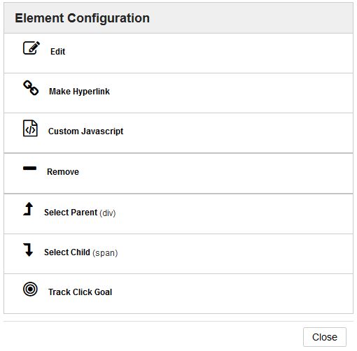

Once you click on the element, the element configuration panel is displayed.
Element configuration panel
The element configuration panel only displays the configuration options that are available to the currently selected element. For example, if there are no child elements then the Select Child option is not displayed.
The configuration options available are:
Edit: This option is available to all element types and you can use it to edit the properties of the selected element. If you click on it, the element configuration panel displays a set of tabs containing whichever of the following are appropriate for the element you selected:

Classes: This allows you to assign a defined CSS class to the specified element.
Edit Image: If the selected element is an image element you can define the image properties using this option. The configuration options available here are:
Image URL: This is the source URL for the image.
Alt Text: This is the alternative text for the image.
Title: This is the text displayed in the tooltip for the image.
Image Size: This is the size at which the image should be displayed. You can select Default, Maintain Original Size, or Manual Resize. If you select Manual Resize then you must enter a value for the height and width of the image in pixels.
Make/Edit Hyperlink: This option is available to all elements which are a container with content. It is displayed as Make Hyperlink, unless the element is already a hyperlink, in which case it is displayed as Edit Hyperlink. The configuration options available here are:
Label: This is the text displayed on the page.
URL: This is the URL to which the visitor is directed if they click on the hyperlink.
Title: This is the text displayed as the tooltip for the hyperlink.
Target: This specifies how to open the hyperlink once the user clicks it.
Custom JavaScript: This option is available to all element types. It is used to execute a custom JavaScript at runtime.
Note: There are limits to the JavaScript that can be entered here. The eval function is not permitted and Experiments does not permit you to save any experiment with an eval command in the JavaScript entered here.
Remove/Undo Remove: This option is available to all elements. It is used to remove, or undo a previous decision to remove, the selected element from the variant page.
Note: In the experiment configuration screen the element is removed, but the space where it was is preserved so that the removed element can be tracked. When the variant is displayed to a visitor, the element is still loaded as part of the web page, but it is not visible on screen.
Select Parent: This is used to switch focus to the parent element of the currently selected element. The element type of the parent element is shown in brackets.
Select Child: This is used to switch focus to the child element of the currently selected element. The element type of the child element is shown in brackets.
Track Click Goal: This is displayed if the element selected is a link, input element, button, or <a> tags. It assigns the selected element as one of the goals for the experiment and opens the Goal Configuration slide panel so that you can configure the goal. For more information on configuring an element as a goal, please refer to the Configure the goals section of this document.
