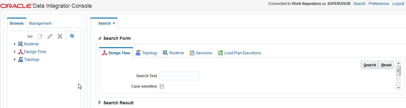

Open the Oracle Data Integrator Console. This displays the Oracle Data Integrator Console Sign In window.
In the Oracle Data Integrator Sign In window:
Select the ODI Work Repository name from the Repository drop-down list.
Enter the name of the ODI user in the User Id field.
Enter the password for the ODI user in the Password field.
Click Sign In. This displays the Oracle Data Integrator Console Screen, as shown in the following figure:

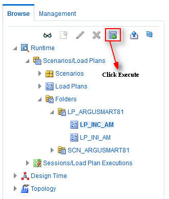

Select the Browse tab in the left pane.

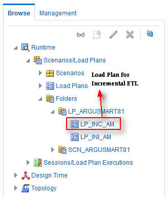

Expand the Runtime folder, and navigate to Runtime > Scenarios/Load Plans > Folder > LP_ARGUSMART81 > LP_INC_AM, as highlighted in the following figure:
The LP_INC_AM option in this section represents the load plan for the Incremental ETL process for Argus Mart.
Click Execute, as highlighted in the following figure:
This displays the Execute Load Plan window, as shown in the following figure:

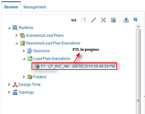

You can verify the status of the ETL process by expanding the Load Plan Executions folder in the Sessions/Load Plan Executions section. You can view the status of the Load Plan in Green color with tilted s, which signifies that the ETL session is in progress, as highlighted in the following figure:

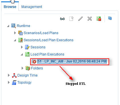

To stop the Incremental ETL, execute the following steps:

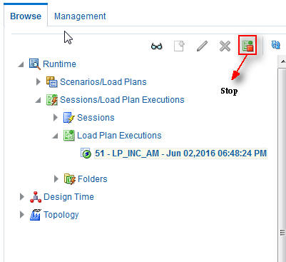

Select the Load Plan, which you want to stop, by expanding the Load Plan Executions folder of the Sessions/Load Plan Executions section and click Stop, as shown in the following figure:

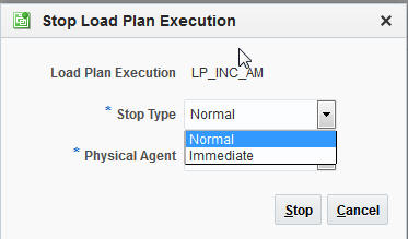

This displays the Stop Load Plan Execution dialog box.
Select Normal from the Stop Type drop-down list.
Select OracleDIAgent from the Physical Agent drop-down list.
Click Stop. This displays the Information dialog box with the Load Plan was Stopped Successfully confirmation message.
Click OK.
You can verify the status of the ETL process by navigating to the Load Plan Executions folder in the Sessions/Load Plan Executions section. You can view the status of the Load Plan in Red color with the X symbol, which signifies that the ETL session is not in progress, as highlighted in the following figure:

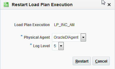

Restarting the Incremental ETL process enables you to start the ETL process from the last execution step where it was stopped or failed.
To restart the Incremental ETL, execute the following steps:

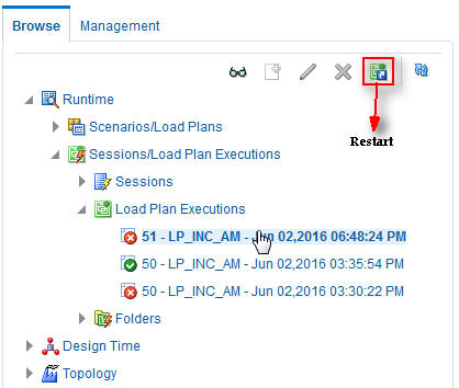

Select the Load Plan, which you want to restart, in the Load Plan Executions folder of the Sessions/Load Plan Executions section and click Restart, as shown in the following figure:
This displays the Restart Load Plan Execution dialog box.
Select the required log level from the Log Level drop-down list.
Click Restart. This displays the Information dialog box with the Load Plan restarted message.
Click OK.
This adds another Load Plan, with the same name as that of the stopped ETL, in the Load Plan Executions folder of the Sessions/Load Plan Executions section. However, this instance of the Load plan is in Green color, which signifies that the ETL is in progress.
