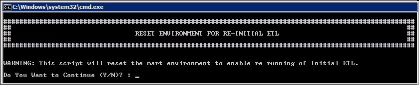

This displays a warning message, which serves as a confirmation from you that you want to reset the Mart environment as shown in the following figure:
Enter Y, which represents Yes, in the Do You Want to Continue (Y/N)? field, if you want to continue with resetting the Mart environment to be able to run the Initial ETL on the database again.
Or
Enter N, which represent No, if you want to quit the process of resetting the Mart environment.

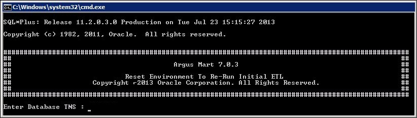

If you have entered Y, the Reset Environment to Re-Run Initial ETL Screen is displayed, as shown in the following figure:
Enter the TNS Name to connect to the Argus Mart database in the Enter Database TNS field and press Enter.
Enter the following parameters for the user who have administrator rights to access the ETL process.
Note: This user is referred to as Argus ETL User. If the user is not the database owner with the administrator rights for the ETL process, the system displays an error message. |
Enter the Argus Mart Database Owner in the Enter Argus ETL User field, and press Enter.
Enter the password in the Enter Password for User field, and press Enter.
Enter the name of the log file in the Enter log file name field, and press Enter.

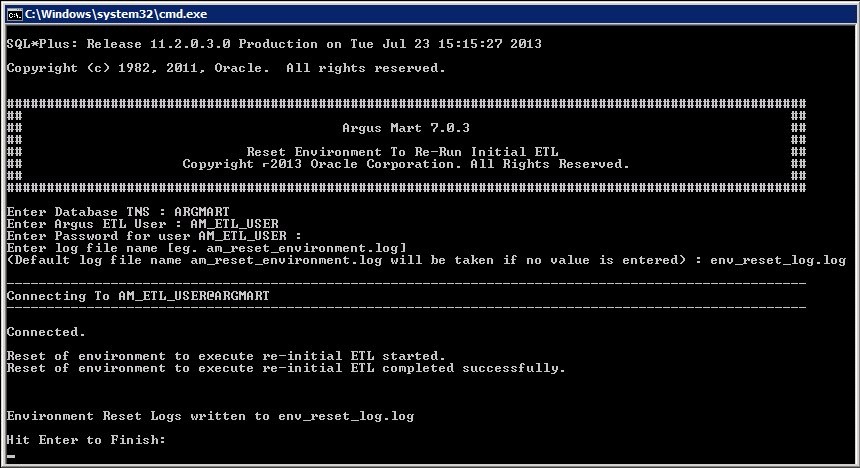

The system displays a Connecting status message and once connected displays Connected, as shown in the following figure:
Press Enter to complete writing the logs.
Press Enter to exit from the window.
