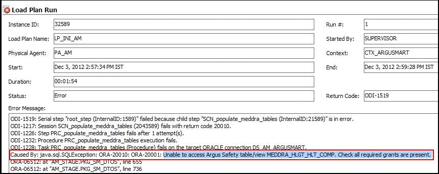

The following error message is displayed during the ETL process, whenever the dictionary is reloaded in Argus Safety:

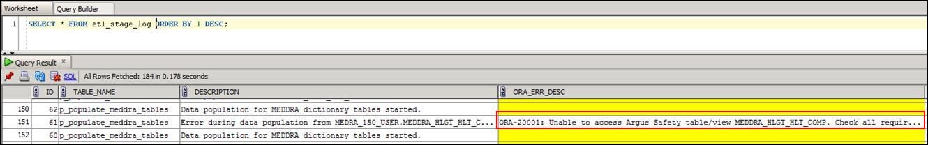

You can also view this error message by logging on to the SQL Developer as the AM_MART_USER, as shown in the following figure:
Cause of Error
Whenever there is a dictionary reload in Argus Safety, some of the required privileges for the Argus Safety user, which you created, using the Schema Creation Tool during the Installation Process, are lost.
Resolution
You must give the required privileges to the Argus Safety user. To do so, click the Argus User Creation link on the Schema Creation Tool, select the user that you created during the installation process in the Argus Safety User Creation dialog box, enter the name of the log file and click OK to give the required privileges to the user.

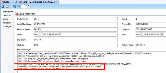

Error Message
There are some Pre-requisite checks that you must do before the execution of the ETL. The following is the error message, which is displayed if any of the Pre-requisites checks are not done:
Cause of Error
The following are the possible causes of this error message:
If you are trying to run the Initial ETL on a database again without executing the Re-initial script.
If you are trying to execute the Incremental ETL prior to the Initial ETL.
If you have not configured the First Human Language Profile Switch using the Argus Safety console for the enterprises configured in Argus Mart. You must not leave the value for the First Human Language Profile Switch, as Blank.
If the previous instance of the ETL is still not complete for the Load Plan.
Resolution
To resolve this error message, you must:
Ensure that you run the Initial ETL on a database again only if you have already executed the Re-initial script. For more information on Re-initial script, see Chapter 15, "Re-initializing the ETL Process."
If you are trying to run the Incremental ETL on a database, ensure that the Initial ETL has already been executed on it.
Ensure that you have not left the value for the First Human Language Profile Switch for the enterprises configured in Argus Mart, as Blank.
Ensure that the Previous Instance of the ETL process is complete. You can either resume the ETL process if it is in Stopped state, or you can execute the re-initial script on the database and restart the ETL process from the first step.
For more information on resuming or restarting the ETL process, see Chapter 8, "Extracting, Transforming, and Loading Data."

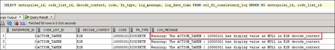

You can run the following query using the SQL developer to view the Flexible Re-categorization (FR) Consistency warning message:
SELECT enterprise_id, code_list_id, decode_context, code, fr_type, log_message, log_date_time FROM etl_fr_consistency_log ORDER BY enterprise_id, code_list_id
The following is the error message:
Cause of Error
The display value for a codelist is NULL in the rm_code_list_detail_discrete table in Argus Safety.
Resolution
You must update the value for the codelist in the rm_code_list_detail_discrete table in Argus Safety and re-run the ETL.

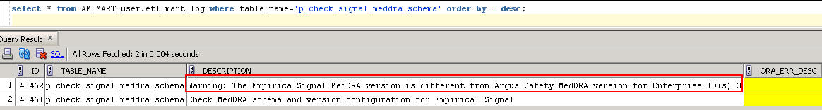

You can run the following query using the SQL developer to view the MedDRA mismatch warning message in the etl_mart_log table:
SELECT * FROM am_mart_user.etl_mart_log WHERE table_name = 'p_check_signal_meddra_schema' ORDER BY 1 DESC;
Cause of Error
During the ETL process, a check is done between the Argus Safety and the Argus Mart database to ensure that they are using the same MedDRA version. This warning message is displayed when these values do not match.
Resolution
You must update the value for the MedDRA version in the SIGNAL_MEDDRA_VER table to ensure that it matches with the Argus Safety database value.
