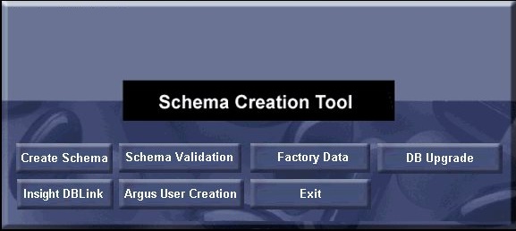

3.3 Starting the Argus Mart Schema Creation Tool
This section gives you a brief introduction about all the options that are visible on the user interface, when you start the Argus Mart schema creation tool.
To start the Argus Mart Schema Creation tool, execute the following steps:
  1. Log in to the Argus Mart Server as a user with administrator privileges.
  2. Click DBInstall.exe saved at the following location:
    ...\ArgusMart\Database\DBInstaller\DBInstall.exe
    Alternatively, select the Argus Mart Schema Creation Tool from the Windows Start menu.
    The Argus Mart Schema Creation Tool appears.
    Figure 3-2 Schema Creation Tool
    Surrounding text describes Figure 3-2 .
    The following is a summary of all the options provided on the user interface:
    Table 3-2 Summary of Schema Creation Tool options
    Option Description Reference
    Argus User Creation
    Enables you to create the users for the Argus Safety database.
    Section 3.4.2, Creating User for the Argus Safety Database
    Create Schema
    Enables you to create a new database schema for Argus Mart.
    Section 3.4.3, Creating a New Database Schema for Argus Mart
    Factory Data
    Loads data in to the newly created Argus Mart database schema.
    Section 3.4.4, Loading Factory Data
    Schema Validation
    Enables you to validate a newly-created Argus Mart database schema.
    Section 3.5, Validating the Schema
    Insight DBLink
    Enables you to link Argus Insight database with Argus Mart database.
    Section 3.4.5, "Creating Argus Insight Database Link"
    DB Upgrade
    Enables you to upgrade existing database.
    Section 7.3, "Upgrading Argus Mart Database"
    Exit
    Enables you to exit from the Argus Mart Schema Creation tool
    N/A

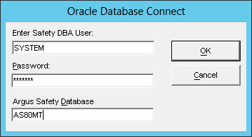

  2. Click Argus User Creation.
    The Oracle Database Connect dialog box appears.
    Figure 3-3 Oracle Database Connect Dialog Box
    Surrounding text describes Figure 3-3 .
  3. In the Oracle Database Connect dialog box:
    1. In the User field, enter the name of Argus Safety SYSTEM or INSTALL user.
    2. In the Password field, enter the password for Argus Safety SYSTEM or INSTALL user.
    3. In the Argus Safety Database field, enter the name of the Argus Safety database that you want to connect to.
    4. Click OK.

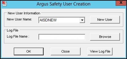

      The Argus Safety User Creation dialog box appears.
      Figure 3-4 Argus Safety User Creation Dialog Box
      Surrounding text describes Figure 3-4 .

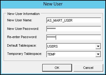

  4. Click New User.
    The New User dialog box appears.
  5. In the New User dialog box:
    1. In the New User Name field, enter the name for the new user.
    2. In the New User Password field, enter the password for the new user.
    3. In the Re-enter Password field, re-enter the password for the new user.
    4. From the Default Tablespace drop-down list, select the default tablespace, where you want to store the database objects.
    5. From the Temporary Tablespace drop-down list, select the tablespace, where you want to store the database objects temporarily.
      Figure 3-5 Argus Safety User Creation
      Surrounding text describes Figure 3-5 .
  6. Click OK.
    You return to Argus Safety User Creation dialog box.
  7. In the New User Name drop-down list, select the name of the newly created user from the list of existing users.
  8. To navigate to the location where you want to save the log file, click Browse.
    The Save Log File dialog box appears.
  9. In the File name field, enter the name of the log file.
    You may enter the name of the file as AS_MART_USER, which is easier to remember, for reference later in the installation process.
  10. Click Save.
    You return to Argus Safety User Creation dialog box and the complete path of the log file appears in the Log File Name field.
  11. Click OK to create the specified user.

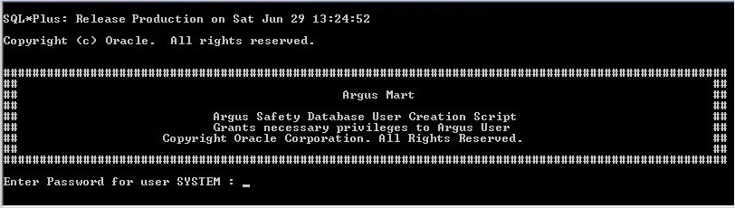

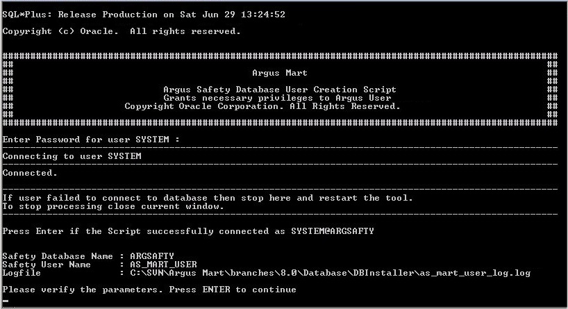

    The command prompt screen appears.
    Figure 3-6 Entering Password for the Argus Safety SYSTEM or INSTALL User
    Surrounding text describes Figure 3-6 .
  12. Enter the password for the Argus Safety SYSTEM or INSTALL user, and press Enter.
  13. Verify that the script is successfully connected as <Argus Safety SYSTEM/INSTALL User>@<Argus Safety Database Name>, and press Enter.
    The information about the Argus Safety database name, the name of the user to create, and the name of the log file appears.
    Figure 3-7 Verifying AS Database, User, and Log File Details
    Surrounding text describes Figure 3-7 .
  14. Verify the information, and press Enter to continue.

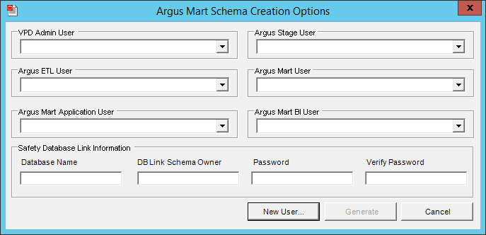

      The Argus Mart Schema Creation Options dialog box appears.
      Figure 3-9 Argus Mart Schema Creation Options Dialog Box
      Surrounding text describes Figure 3-9 .

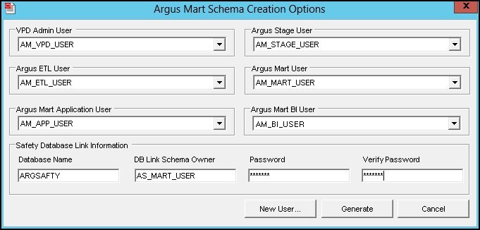

      Now we need to create the following users using this screen:
      • VPD Admin User
      • Argus Stage User
      • Argus ETL User
      • Argus Mart User
      • Argus Mart Application User
      • Argus Mart BI User
      Tip:
      You may create the users with names AM_VPD_USER, AM_STAGE_USER, AM_ETL_USER, AM_MART_USER, AM_APP_USER, and AM_BI_USER respectively so that you can easily remember and use them later in the installation process.

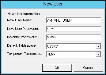

  4. Click New User.
      Figure 3-10 Creating VPD Admin User
      Surrounding text describes Figure 3-10 .
  6. Click OK.
  7. Repeat steps 5(a) to 5(e) of this procedure to create three more users, which are referred as Argus Stage User, Argus ETL User, Argus Mart User, and Argus Mart Application User.

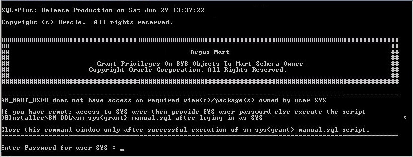

    Before proceeding to the next steps, make sure that you have remote access to the SYS user.
    If you do not have remote access to SYS user, execute the sm_sys{grant}_manual.sql script through SYS user, and enter the following inputs:
    • Enter Argus Mart schema Name—Provide Argus Mart User. For example, AM_MART_USER.
    • Enter Argus Mart VPD schema Name—Provide VPD Admin User. For example, AM_VPD_USER.

  8. In the Argus Mart Schema Creation Options dialog box:
    1. From the VPD Admin User drop-down list, select the Argus VPD user.
    2. From the Argus Stage User drop-down list, select the Argus Stage user.
    3. From the Argus ETL User drop-down list, select the Argus ETL user.
    4. From the Argus Mart User drop-down list, select the Argus Mart user.
    5. From the Argus Mart Application User drop-down list, select the Argus Mart Application user.
    6. From the Argus Mart BI User drop-down list, select the Argus Mart BI user.
    All these users are created in step 5 of this procedure. Make sure you select these users only from each respective drop-down list.
  9. In the Safety Database Link Information section:
    1. In the Database Name field, enter the Argus Safety Database name, which you have used while creating the user for the Argus Safety database.
      See step 3(b) of the section 3.4.2 , Creating User for the Argus Safety Database for detailed steps.
    2. In the Database Link Schema Owner field, enter the name of the user for the Argus Safety database.
      See step 5(a) of the section 3.4.2 , Creating User for the Argus Safety Database for detailed steps.
    3. In the Password field, enter the password of the user for the Argus Safety database.
      See step 5(b) of the section 3.4.2 , Creating User for the Argus Safety Database for detailed steps.
    4. In the Verify Password field, re-enter the password.
      Figure 3-11 Safety Database Link Information Details
      Surrounding text describes Figure 3-11 .

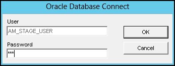

    Figure 3-12 Oracle Database Connect: Argus Stage User Password
    Surrounding text describes Figure 3-12 .
  11. In the Password field, enter the password for the Argus Stage User.
  12. Click OK.

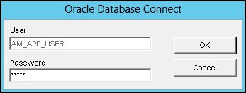

    Figure 3-14 Oracle Database Connect: Argus Mart Application User Password
    Surrounding text describes Figure 3-14 .
  15. In the Password field, enter the password for the Argus Mart Application User.
  16. Click OK.
    Figure 3-15 SYS User Details
    Surrounding text describes Figure 3-15 .
  17. If you have remote access to the SYS user, enter the password for the SYS user, and press Enter to continue.

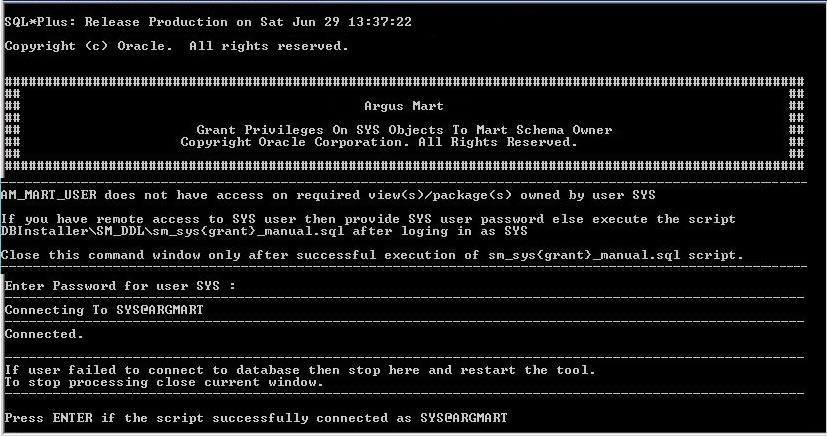

    The following screen appears.
    Figure 3-16 Verifying User and Argus Mart Database Details
    Surrounding text describes Figure 3-16 .
    If you have already executed the script sm_sys{grant}_manual.sql through SYS user, the above screen does not appear.
  18. Verify that the script is successfully connected as <SYS User Name>@<Argus Mart Database Name>, and press Enter.
    The Grant succeeded message appears multiple times on the command prompt screen and subsequently the location of the log file.

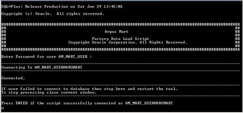

3.4.4 Loading Factory Data
To load factory data into the newly created Argus Mart database schema, execute the following procedure:
  1. Start the Argus Mart Schema Creation tool.
    See Section 3.3, Starting the Argus Mart Schema Creation Tool.
  2. Click Factory Data.
  3. Enter the following parameters:
    • Argus Mart Schema Owner
    • Password
    • Database
  4. Click OK.
  5. Enter the password for the Argus Mart user, and Press Enter.
    The following command prompt screen appears:
    Figure 3-18 Verifying the Argus Mart User and Database Details
    Surrounding text describes Figure 3-18 .
  6. Verify that the script is successfully connected as <Argus Mart User Name>@<Argus Mart Database Name>, and press Enter.
    Multiple messages about the creation of rows appears.
  7. Press Enter.
    The confirmation message appears stating that the Factory Data is loaded and verify the log file.
  8. Click OK to complete the procedure.
  2. Click Insight DBLink.

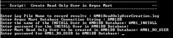

3.4.6 Creating Argus Mart Read-Only User
You can create a read-only schema in Argus Mart. This schema will have read-only (SELECT) access on all the tables and views of the AM_MART schema. Besides, this read-only schema can also be used for customized reporting purpose.
To create Argus Mart Read-only user:
  1. From the Utils folder, double click the MART_RO_USER.bat file.
  2. Enter the following inputs:
    1. Name of the Log file
    2. Name of Argus Mart database instance
    3. Name of Argus Mart INSTALL user
    4. Password of Argus Mart INSTALL user
    5. Name of Argus Mart Read-only user that you want to create
    6. Password of Argus Mart Read-only user
    Surrounding text describes params.jpg.
    On successful connection to the Argus Mart INSTALL user, the script provides read-only access to Reporting Mart (RM) and Signal Mart (SM) objects of Argus Mart schema to the read-only user.
  2. Click Schema Validation.

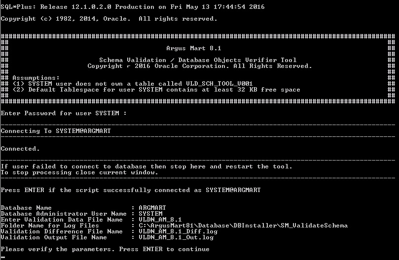

    6. Click Validate Schema.
  5. Enter the password for Argus Mart SYSTEM or INSTALL user, and press Enter.
  6. Verify that the script is successfully connected as <Argus Mart SYSTEM or INSTALL User Name>@<Argus Mart Database Name>, and press Enter.
    Figure 3-22 Verifying other Details
    Surrounding text describes Figure 3-22 .
  7. Review the information on the command prompt screen, and press Enter.
    A message to enter database administrator password appears.
  8. Enter the password for Argus Mart SYSTEM or INSTALL User, and press Enter.
  9. Continue to review the information on each screen, and press Enter until the Schema Validation Utility dialog box appears along with the location of the log file.
