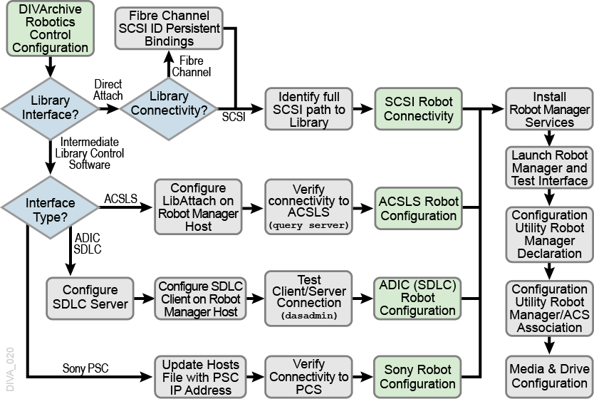

The following figure outlines the steps for configuring the robotics to be controlled by DIVArchive:
DIVArchive Robotics Configuration Flow Chart

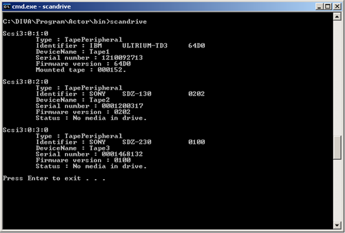

For Windows, you can determine the RM_SCSI_DEVICE_LSM(n) settings for the DIVArchive Robot Manager using the scandrive.exe utility. The utility is located in the %DIVA_HOME%\Actor\bin directory. The utility automatically reports all devices located in the Windows SCSI hardware tree in the registry and their corresponding Port, Bus, Target, and Logical Unit Numbers (LUN).
Scandrive Utility Output
The utility reports the SCSI Device ID of the library in the format ScsiP:B:T:L (see the previous figure), where P is the port number, B is the bus number, T is the target number, and L is the Logical Unit Number.
The Type section of the utility's output refers to that peripheral's class (HDD, CDROM, and so on). A tape library will be reported as a Medium Changer Peripheral, and the Identifier for each corresponding device reported should match the model number of the library itself (for example, SL500). You can then enter the full SCSI path reported for each library into the RM_SCSI_DEVICE_LSM(n) settings in the robotmanager.conf file.

You perform DIVArchive Robot Manager control and management functions using robotmanager.exe from a command prompt. On Windows servers the executable is located in the %DIVA_HOME%\Program\Robotmanager\bin folder. On Linux servers, robotmanager.sh is located in the /home/diva/DIVA/Program/RobotManager/bin directory.
Installing and Uninstalling the Robot Manager Services in Windows
You use the following command line options to install or uninstall the DIVArchive Robot Manager from a Windows command prompt:
robotmanager -i
Installs the Robot Manager Service as set by the SERVICE_NAME parameter defined in robotmanager.conf. If this parameter is undefined, the service is installed as DIVArchive Robot Manager - host_name.
robotmanager -u
Removes the Robot Manager Service set by the SERVICE_NAME parameter in robotmanager.conf. If this parameter is undefined the service to be removed is DIVArchive Robot Manager - host_name.
These Robot Manager command options default to the robotmanager.conf file located in the %DIVA_HOME%\Program\conf\robot_manager folder to define the Service Name (if any). If you are installing multiple Robot Managers on a single host (see Appendix A for Oracle DIVArchive options and licensing information), additional Robot Manager configuration files must be created and specified to the service during installation to create unique instances for each Robot Manager.
You can create additional configuration files for each Robot Manager by copying and renaming the original robotmanager.conf file. For example, robotmanager1.conf, robotmanager2.conf, and so on. Each configuration file must contain unique SERVICE_NAME, RM_PORT, and RM_ACS entries.
For example, robotmanager1.conf might have the following parameters for a SCSI interface:
RM_MODULE=SCSI_Robot.dll
SERVICE_NAME=Robot1
RM_PORT=8500
RM_ACS=0
While robotmanager2.conf might have the following parameters for an ACSLS interface:
RM_MODULE=ACSLS_Robot.dll
SERVICE_NAME=Robot2
RM_PORT=8501
RM_ACS=1
You must specify the path to each Robot Manager configuration file for each instance when installing additional Robot Manager Services on the same host. You identify the path by adding the -conf (or -f) command switches when installing the service. For example, robotmanager -i -conf ..\..\conf\robot_manager\robotmanager2.conf installs the RObot Manager service as defined by the SERVICE_NAME parameter from the robotmanager2.conf configuration file.
If you must uninstall one or more Robot Manager Services, the configuration file path must also be specified. For example, robotmanager -u -conf ..\..\conf\robot_manager\robotmanager2.conf removes the Robot Manager Service as defined by the SERVICE_NAME parameter in robotmanager2.conf configuration file.
After installing the services check the Windows Services applet to confirm that the Robot Manager Services were installed correctly. To change the SERVICE_NAME, you must uninstall the existing service before editing the robotmanager.conf file. Then reinstall the service after changing the SERVICE_NAME parameter.
Installing and Uninstalling the Robot Manager Services in Linux

Testing the Robot Manager Library Interface
After configuring the Robot Manager configuration file, launch the DIVArchive Robot Manager and confirm that the library itself can be controlled.
Library interfaces that use ACSLS, SDLC, or PSC intermediate control software must be running before launching the DIVArchive Robot Manager. ACSLS controlled libraries should also be varied online (for example, vary lsm0 online).

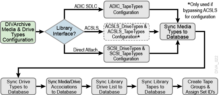

Configuring Media and Drive Types
After you have successfully configured the DIVArchive Robot Manager for your libraries, and the appropriate details for all DIVArchive Robot Managers entered into the Robots tab section of the Configuration Utility, the Tape Media, Drive Models, and the Drive Locations currently installed in each library must be entered.
The following flowchart lists the workflow of this portion of the configuration. All of the DIVArchive Robot Managers configured must be running and successfully connected to each library before commencing this portion of the configuration.
Media and Drive Types Configuration
Tape Drives and their associated media types that are installed in a particular library are initially configured in the DIVArchive Database using static configuration files. The files are located in the %DIVA_HOME%\Program\conf\robot_manager folder. The DIVArchive Robot Manager selects the appropriate files according to the RM_MODULE setting configured in robotmanager.conf.

Synchronizing Media Types with the Database
You must import the values that have been uncommented in the Tape_Types configuration files into the DIVArchive Database. Each DIVArchive Robot Manager to be queried must be online to complete this procedure successfully.
Use the following procedure to import and synchronize the values from the Tape_Types files in the database:
Caution:
Only perform this operation if you are adding Media Types to the library.
  1. Open the Configuration Utility and connect to the database.
  2. Select the Synchronize DB option from the Tools menu and acknowledge the warning message.
  3. Select the individual Robot Manager to synchronize from the menu list in the Database Synchronization dialog box, or select ALL to synchronize all Robot Managers.
  4. Only select the Synchronize media types list check box. Confirm that all other check boxes are deselected.
  5. Click Go to update the selected associations.
    The Configuration Utility will connect to the DIVArchive Robot Manager. The Robot Manager parses the SCSI_Tape_Types (or ACSLS_Tape_Types if used) configuration file.
  6. If a Tape Type is not currently in the database, you will be prompted to enter it. Click No for any Tape Types not currently in use.
    If you report cleaning tapes in the following two steps, you must enter a Tape Size and Block Size of 1 KB for each cleaning tape added so they do not interfere with the total available size computation of all tapes in the Control GUI.
  7. Enter the Total Size for this Media Type and click OK.
  8. Enter the Block Size for this Media Type. Ensure you enter the Block Size correctly before clicking OK because you cannot change it later.
  9. Click Close to exit the Database Synchronization dialog box.
  10. Confirm the Tape Type has been correctly entered in the Tape Properties frame of the Configuration Utility Tapes tab.
Synchronizing Drive Types with the Database
You must also import the uncommented values in the Drive_Types configuration files into the DIVArchive Database. Each DIVArchive Robot Manager to be queried must be online to complete this procedure successfully.
Use the following procedure to import and synchronize the values from the Drive_Types files in the database:
Caution:
Only perform this operation if you are adding Drive Types to the library.
  4. Only select the Synchronize drive types list check box. Confirm that all other check boxes are deselected.
    The Configuration Utility will connect to the DIVArchive Robot Manager. The Robot Manager parses the SCSI_Drive_Types (or ACSLS_Drive_Types if used) configuration file.
  6. If a Drive Type is not currently in the database, you will be prompted to enter it. Click No for any Drive Types not currently in use.
  7. Enter the Block Size for this Drive Type. Ensure you enter the Block Size correctly before clicking OK because you cannot change it later.
  8. Confirm there are no errors in the status window. If errors appear, recheck the Tape_Types and Drive_Types definition files.
  10. Confirm the Drive Type has been correctly entered in the Drive Properties frame of the Configuration Utility Drives tab.
Synchronizing Media and Drive Compatibility with the Database
This step cross-references the compatibility entries in the Tape_Types and Drive_Types definition files.
For libraries controlled by ACSLS Media and Drive Type, information is normally retrieved directly from ACSLS,. Therefore, an ACSLS software upgrade or a library firmware update may require the Media and Drive Type settings to be resynchronized.
Use the following procedure to synchronize the media and drive compatibility in the database:
Caution:
Only perform this procedure is you are adding a Media or Drive Type, or updates are made to the Tape or Drive Types definition files in a DIVArchive software update.
  4. Only select the Synchronize media/drive compatibility list check box. Confirm that all other check boxes are deselected.
    The Configuration Utility will connect to the DIVArchive Robot Manager. The Robot Manager parses the SCSI_Tape_Types (or ACSLS_Tapes_Types if used) configuration file.
  6. Confirm there are no errors in the status window. If errors appear, recheck the Tape_Types and Drive_Types definition files.
  7. Click Close to exit the Database Synchronization dialog box.
  8. Confirm the Media Type and Drive Type associations have been correctly entered in the Media Compatibility frame of the Configuration Utility Robots tab.

Each drive's serial number is automatically identified by library synchronization with the database during initial installation or drive replacement. Some cases may require you to manually determine the serial number and enter it into, or verify it against, the database.
You can manually identify the drive serial number either using the library's front panel display, or using the Scandrive Utility and the Robot Manager Client or GUI.
The latter method involves mounting a tape into a specific drive number in the tape library, establishing which drive the Actor is reporting that has that tape mounted, and then recording its serial number and entering, or verifying, it with the corresponding library Drive ID in the database. You must only complete this process one time for each drive in the library.
Caution:
The Robot Manager Client GUI utility issues direct commands to the Robot Managers and will interfere with DIVArchive operations. It interacts directly with both the Robot Managers and the Tape Drives in the libraries. You must not use it while the DIVArchive Manager is running.
You can use the Robot Manager Client GUI utility to send manual mount commands to a DIVArchive Robot Manager. See the Robot Manager Client GUI section for information.
The serial number of each drive can be discovered by using the scandrive.exe utility located in the %DIVA_HOME%\Program\Actor\bin folder. This utility automatically reports all SCSI devices installed in the host computer, and their corresponding port, bus, target and logical unit numbers. For tape devices, the utility also indicates the drive's firmware, serial number, and whether a tape is loaded into the drive.
After a tape is mounted in a drive (using the Robot Manager Client GUI), run the scandrive.exe utility on an Actor host (that will use the selected drive) to determine which drive has the tape mounted and its corresponding serial number.
See Determining the SCSI Library Connection for information on using the Scandrive utility.
In the following figure the Type section refers to that peripheral's class (HDD, CDROM and so on). Each tape drive will be reported as a TapePeripheral, and the Identifier for each corresponding device should match the model number of the drive itself (for example, IBM Ultrium TD2).
Confirm the tape barcode is the correct one loaded through the Robot Manager Client GUI. You must then enter the serial number for the appropriate drive by highlighting it in the Drives section of the Configuration Utility, and then selecting Edit. Repeat the process by mounting a tape into the next library drive.
Remember to dismount the tape after determining the drive's serial number.
