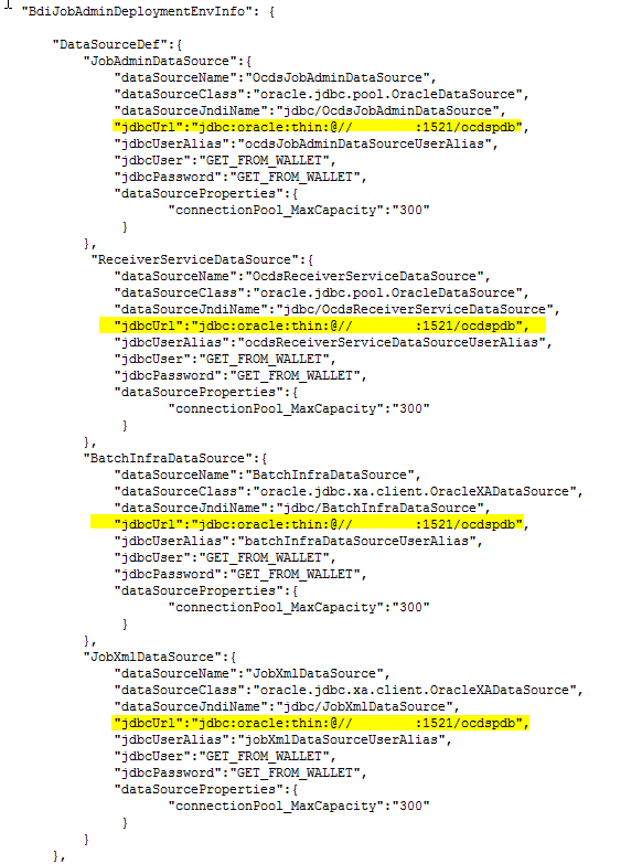

  2. Configure the conf/bdi-job-admin-deployment-env-info.json file with the database and WebLogic domain details. This file is used by the deployment script.
    1. Edit the Datasource definitions for JobAdminDatasource:
      • jdbcUrl: Configure the jdbcUrl for all DataSources definitions in DataSourceDef.
        BatchInfraDataSource references a schema created using the WebLogic RCU (<prefix>_WLS).
        All other datasources reference the OCDS interface (ocds_ifc) schema created during the prerequisite step: OCDS Database Creation.
        Figure 5-1 Datasource Definitions

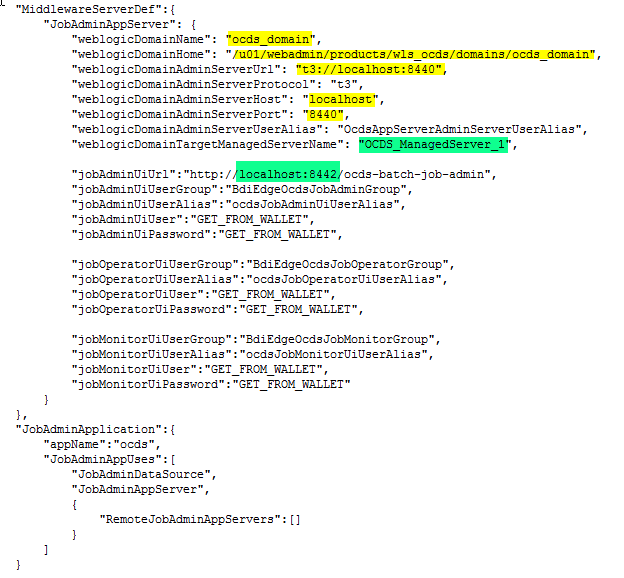

    2. Edit the Middleware Server definitions for JobAdminAppServer
      • webLogicDomainName: WebLogic domain name.
      • webLogicDomainHome: WebLogic domain home directory.
      • webLogicDomainAdminServerUrl: Server URL information.
      • webLogicDomainAdminServerHost: Server host.
      • webLogicDomainAdminServerPort: Admin Server port.
      • webLogicDomainTargetManagedServerName: Managed Server name.
      • jobAdminUiUrl: Host and managed server port where Job Admin application will be deployed. This can be setup with the HTTPS port.

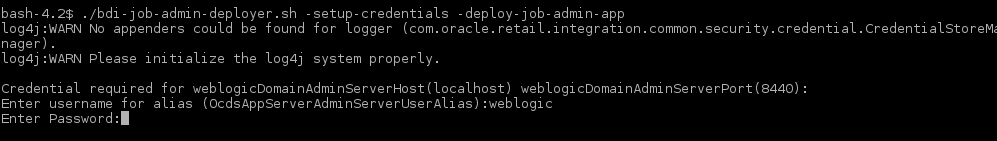

  1. Change to the ocds-jobadmin-deployment/bin folder and execute the version bdi-job-admin-deployer script for the o/s using the switches:
    -setup-credentials -deploy-job-admin-app
    On Linux:
    ./bdi-job-admin-deployer.sh -setup-credentials -deploy-job-admin-app
    On Windows:
    bdi-job-admin-deployer.cmd -setup-credentials -deploy-job-admin-app
    1. There will be one prompt for a WebLogic user credential:
      • Enter username for alias (OcdsAppServerAdminServerUserAlias):
        Enter the WebLogic Admin Server credentials.

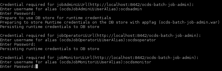

    2. There will be three prompts to create JobAdmin user credentials:
      • Enter username for alias (ocdsJobAdminUiUserAlias):
        Enter credentials to be used to create the Admin user.
      • Enter username for alias (ocdsJobOperatorUiUserAlias):
        Enter credentials to be used to create the Operator user.
      • Enter username for alias (ocdsJobMonitorUiUserAlias):
        Enter credentials to be used to create the Monitor user.

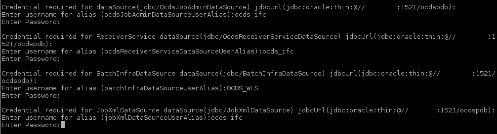

    3. There will be four prompts for database user credentials. Three of the four credentials are for the OCDS Interface User named ocds_ifc.
      • Enter username for alias (ocdsJobAdminDataSourceUserAlias):
        Enter the credentials for the OCDS Interface schema user. The username must be ocds_ifc. The password was defined as a prerequisite in the Chapter 3, "OCDS Schemas".
      • Enter username for alias (ocdsReceiverServiceDataSourceUserAlias):
      • Enter username for alias (batchInfraDataSourceUserAlias):
        Enter the credentials for the <prefix>_WLS schema created during the Repository Creation Utility (RCU) step.

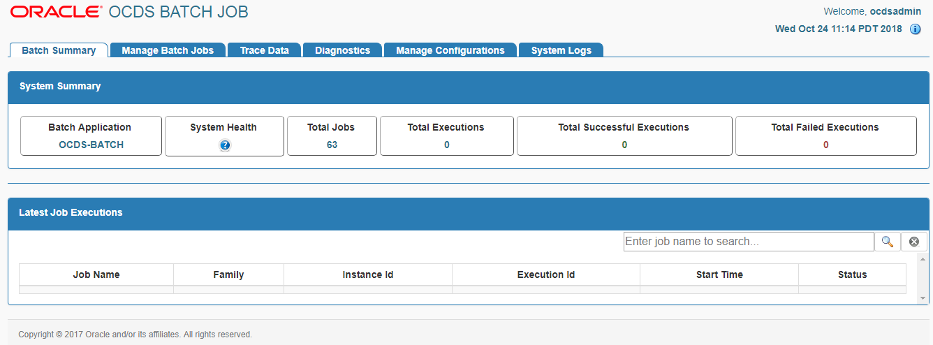

After the OCDS (BDI) Job Admin application has been successfully deployed you should be able to access and log into the application's user interface.
  1. Verify that the BDI Job Admin has been deployed.
    1. Go to http[s]://<host>:<port>/ocds-batch-job-admin/
      Example: https://example:8443/ocds-batch-job-admin/

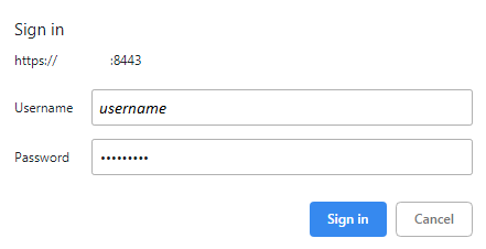

    2. At the prompt enter one of the Job Admin User credentials created during the installation.
      Figure 5-6 Job Admin User Credentials
    3. The OCDS Job Admin UI displays.
