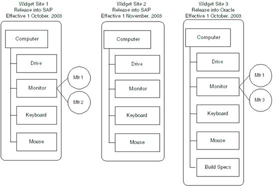

The following diagram illustrates how sites can be used in Agile PLM. The three sites in this diagram vary in ERP system, effectivity date, and manufacturer. Also, Site 3 has added site-specific build instructions.
Figure 3-1 Example of Manufacturing Sites in use
Diagram of manufacturing sites in use
