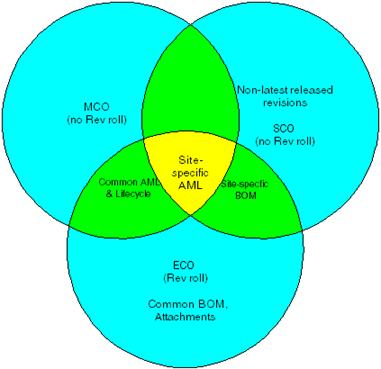

Each Agile PLM class has at least one out-of-the-box subclass. The Agile administrator may decide to use some or all of these change classes and subclasses, and may have created additional subclasses. For example, under the Change Orders class, you might have ECOs, Mechanical ECOs, Software ECOs, and so on.
The purpose of each change subclass is listed in the following table. Corresponding change icons are also listed. These icons are displayed next to the change number on the Changes tab of the item, and next to each change in search results.
Table 7-1 Change subclasses
| Change type | Purpose |
Change Order: ECO
(Web Client)
(Java Client) |
An engineering change order tells users that changes need to be made to specific items, and to go ahead and do the work required to make those changes. ECOs create a new, trackable revision of an item. ECOs can affect common and site-specific portions of the BOM and AML. ECOs allow you to: Release new items. Create revision-specific redline modifications to BOMs, to manufacturer data, and to attachments. Create change-controlled redline modifications to item attributes. |
Change Order: DFCO Web Client only |
The Design File Change Order (DFCO) change order subclass is used to publish Design files. The DFCO has an Affected Files tab. Typically, DFCOs are used in conjunction with Agile Engineering Collaboration, which connects Agile PLM with your CAD system environment. The DFCO subclass is available only if your Agile administrator has enabled it. |
ECR
(Web Client)
(Java Client) |
An engineering change request is used to request a change to be made to items. You can create an ECR against a non-latest released revision of an item. |
MCO
(Web Client)
(Java Client) |
A manufacturer change order tells users that changes need to be made to the manufacturing data of specific items. MCOs can affect common and site-specific portions of the AML. MCOs allow you to: Release new items. Redline the manufacturer data of an item. Change the lifecycle phase of items. Create change-controlled redline modifications to item attributes. |
SCO
(Web Client)
(Java Client) |
A site change order tells users that changes need to be made to site-specific items, and to go ahead and do the work required to make those changes. SCOs affect only the site-specific portion of the BOM and AML. They do not affect the common portion of the BOM and AML. You can create an SCO against a non-latest released revision of an item. SCOs let you redline BOMs and AMLs. |
Deviation
(Web Client)
(Java Client) |
A deviation is used to deviate from a process or specification for a specific time period. You can create a deviation against a non-latest released revision of an item. Deviations do not have any redlining functions. |
Stop Ship
(Web Client)
(Java Client) |
A stop ship alerts users to stop shipping or using an item. You can create a stop ship against a non-latest released revision of an item. Stop ships do not have any redlining functions. |

Changes can affect site-specific information. Before you add affected items to a change, specify the manufacturing site that you want to affect. For general information about sites, see the chapter Chapter 3, "Sites and Distributed Manufacturing."
This section includes the following topics.
For information about working with the Affected Items tab, see the chapter Chapter 8, "Affected Items of Changes."
The following data is subject to change control:
Site-specific portion of the BOM
Site-specific portion of the AML
Dispositions
Effectivity dates
Release of a site association after the item is released
All of the above data can be directly edited before an item is released. After the item is released, BOM data and AML data may be redlined through an ECO, MCO, or SCO. A new item revision is not required, but will be made if the modification is made using an ECO.
See also: "Changes and Manufacturing Sites."
You can use an ECO to perform the following site-related actions:
Modify the common or site-specific BOM of an item.
Modify the common or site-specific AML of an item.
Modify dispositions site-specifically.
Modify the effectivity and obsolete dates of site-specific items.
You can use an MCO to modify the common and site-specific AML of an item or change the lifecycle phase of an item.
You can use MCOs for all sites. In this example, there are two competing MCOs with site-specific information. When the first MCO is released, then the pending MCO is rebased to the newly released MCO. In a similar manner, if a pending MCO has competing site-specific redlines with a pending ECO or SCO, then when the ECO or SCO is released, the pending MCO is rebased to the newly released ECO or SCO.
You can use site change orders (SCOs) to make site-specific changes to an item without changing the revision of the parent item.
With SCOs, you can modify the effectivity and obsolete dates, and the dispositions of previous revisions of an item, on a site-by-site basis. SCOs let you use an explicit process to propose, review, and approve the modification of effectivity dates and to record the reasons why the effectivity dates were changed.
Note: You cannot use an SCO to make redline modifications to a previous revision of an item. All redline modifications must be made to the latest released revision of an item. |
You can use an SCO to do the following:
Modify the site-specific BOM of an item for latest revisions.
Modify the site-specific AML of an item for the latest revisions.
Modify the site-specific dispositions. Includes latest and non-latest revisions.
Modify the effectivity and obsolete dates of site-specific items. Includes latest and non-latest revisions.
More than one site can be affected by an SCO, however, each row on the Affected Items tab applies to only one site. Duplicate items are not allowed. For example, if you add item P001 for site A, then you cannot also add P001 for site B. You cannot use an SCO to modify the common site portion of the BOM or AML. Also, you cannot use an SCO to modify the BOM of an item that has not been released by an ECO, that is, an SCO cannot modify preliminary BOMs.

Redlining highlights, in red, changes made to an object. ECOs, MCOs, and SCOs are the only changes that have redlining functions. Use these changes when you need to modify a released item. For information about the functions of these types of changes, see "Change Classes."
Depending on your company policy, when you redline manufacturing data, use an ECO when you want to advance the revision of an item, or use an MCO when you do not want to advance the revision of an item.
For information about redlining a BOM, see "Redlining the BOM of a Released Item"
For information about redlining an AML, see "Modifying Manufacturing Data from the Redlines Tab"
For information about redlining attachments and Affected Files, see Getting Started with Agile PLM.
You can redline BOM and AML data and attachments using an ECO. In addition, you can create change-controlled redline modifications to item attributes.
ECOs let you release new items and modify previously released items. When you create an ECO, a pending item revision is created for any items modified by the change (the ones listed on the Affected Items tab). When the ECO is released, the pending item revision is converted to a released revision for each modified item.
See also: "What are Change Controlled Attributes?"
You can redline Design or File Folder files on the Affected Files tab of a Design File Change Order (DFCO). In addition, you can create change-controlled version-specific Title Block redline modifications.
DFCOs lets you publish new Design files and modify previously published files. You can add redline markup the affected files with the Agile AutoVue viewer, and you can add local files as redline markups. You can also use the Associate Redlines feature to consolidate Ad Hoc redlines, ECO redlines, and ECR redlines on the Redlines/Markup Files tab of the DFCO Affected Files tab.
For more information, see Getting Started with Agile PLM, chapter "Working with Design File Change Orders (DFCOs)."
You can redline AML data using an MCO. In addition, you can create change-controlled redline modifications to item attributes.
MCOs are similar in appearance and function to an ECO. However, MCOs do not change the revision of an item, unlike an ECO. Instead, the MCO number is displayed alongside the corresponding revision number in the Rev drop-down list. For example, if there is a pending MCO #M12345 against Rev B of an item, then, on the Rev drop-down list, that revision is listed as (B) M12345.
MCOs can be used to:
Release a new item without a revision (but you can select its lifecycle phase)
Modify the lifecycle phase of an item without changing its revision
Redline manufacturing data (add, modify, or delete) on items (Manufacturers tab)
You can redline site-specific BOM data and site-specific AML data using an SCO, but only against the latest released revision.
SCOs are similar in appearance and function to an ECO. However, SCOs do not change the revision of an item, unlike an ECO. Instead, the SCO number is displayed alongside the corresponding revision number in the Rev drop-down list. For example, if there is a pending SCO S12345 against revision B of an item, then, on the Rev drop-down list, that revision is listed as (B) S12345.
