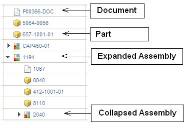

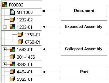

The BOM tab lists all the items on a BOM.
The BOM table displays the items on the BOM in a graphical hierarchy, using icons to indicate whether an item number represents:
Table 5-1 Item icons on the BOM tab
BOM table item icon Description
Part icon
A part
Document icon
A document
Assembly icon
An assembly

5.3.2 Expanding and Collapsing an Assembly
See also: "Opening Items on a BOM."
Close-up of the BOM tree, Web Client:
To expand an assembly or subassembly, click the Expand icon before its item number.
To collapse an assembly or subassembly, click the Collapse icon before its item number
Figure 5-1 Web Client BOM tree
Web Client expanded and collapsed sections of the BOM Tree
Close-up of the BOM tree, Java Client:
To expand an assembly or subassembly, click the Plus icon before its item number.
To collapse an assembly or subassembly, click the Minus icon before its item number
Figure 5-2 Java Client BOM tree
Java Client expanded and collapsed sections of the BOM Tree
