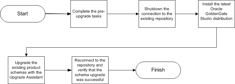

Review the flowchart and roadmap for an overview of the upgrade process for Oracle GoldenGate Studio .
The steps you take to upgrade your existing domain varies depending on how your domain is configured and which components are being upgraded. Follow only those steps that are applicable to your deployment.
Figure 3-1 Upgrade Process Flowchart for Oracle GoldenGate Studio
Description of Figure 3-1 follows
Description of "Figure 3-1 Upgrade Process Flowchart for Oracle GoldenGate Studio"
The following table lists the high-level steps that you need to perform to upgrade to Oracle GoldenGate Studio 12c (12.2.1.2):
Table 3-1 Tasks for Upgrading Oracle GoldenGate Studio
Task Description
