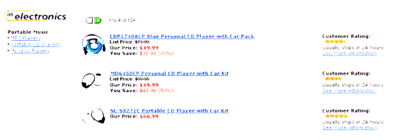

Figure 37 describes an example of an applet that interweaves records.
Figure 37.  Example of an Applet That Interweaves Records
Note how Siebel CRM interweaves records in this example:
  • The parent applet provides data for the bullet items under Portable Music.
  • The child applet provides data for values that Siebel CRM displays after Portable Music.
