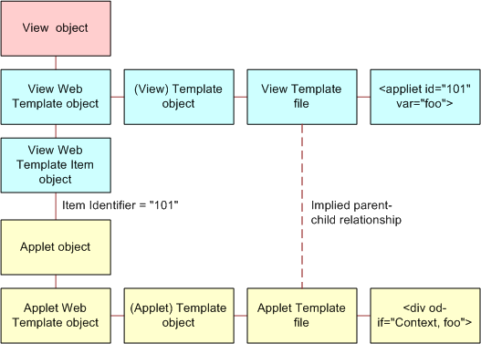

Variable Conditional Tag
An applet template includes the <div od-if="Context, <object>"> tag. It conditionally express the body of the <div od-if="Context, <object>"> tag as determined by a variable that is set in a parent view web template. For the purposes of the <div od-if="Context, <object>"> tag, if an applet is associated with a view, then the web template in the applet acts as a child of the view web template.
The applet placeholder in the view web template must define a variable that the <div od-if="Context, <object>"> tag in the child applet template can evaluate.
The expression in the <div od-if="Context, <object>"> tag returns a value of true or false depending on if the variable it evaluates is a property of the <div od-type="applet"> tag in the corresponding view web template. You can use this configuration to conditionally display parts of an applet depending on the position of the part in a view.
Figure 39 describes object relationships that Siebel CRM uses with the variable conditional tag.
Figure 39.  Object Relationships Siebel CRM Uses with the Variable Conditional Tag
Example Code That Uses the Variable Conditional Tag
