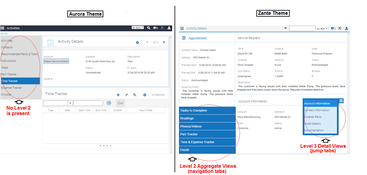

The Siebel Mobile application for Siebel Field Service uses the Zante UI theme by default, which is different from the Aurora UI theme which is the default theme used by the other Siebel Mobile applications (for Siebel Pharma, Siebel Consumer Goods, Siebel Sales, and Siebel Finance).
For information about navigating Siebel Mobile applications using the Aurora theme, see for example "Using the Home Page for Siebel Pharma".
For information about navigating the Siebel Mobile application for Siebel Field Service using the Zante theme, see "Using the Home Page for Siebel Field Service".
For information about how to change the UI theme for your Siebel Mobile application, see "Configuring Application Behavior Settings for Siebel Mobile".
The main difference between the Zante and Aurora themes is that the Zante theme uses second level navigation views as shown in Figure 8-2 (see Level 2 Aggregate Views). For information about how to set up second level navigation views for your Siebel application, see "Configuring Second Level Navigation Views".
You can configure second level navigation views in Siebel Tools for your Siebel application as required.
