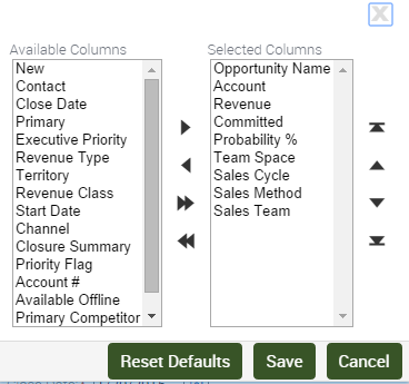

A list consists of columns of data. Some of these columns might not appear on the screen. You can add, remove, and rearrange the list columns as needed by using the Columns Displayed dialog box.
Figure 6-4 shows an example of the columns displayed dialog box.
To organize columns in a list
In a list, click Menu (the cogwheel icon), and then click Columns Displayed.
The Columns Displayed dialog box appears.
Select one or more columns in one of the lists (Available Columns or Selected Columns).
Click the buttons between the Available Columns and the Selected Columns list to show or hide the columns you select.
The buttons are described in the following table.

Select a column in the Selected Columns list, and then use the column-ordering buttons next to the Selected Columns list to change the order in which the columns appear in the list.
| Button | Description |
Single up navigation arrow. Click to move the column you select.
Moves the column you select up one position in the Selected Columns list. After you click Save, the column is moved up one position in the list you are modifying. |
Single down navigation arrow. Click to move the column you select.
Moves the column you select down one position in the Selected Columns list. After you click Save, the column is moved down one position in the list you are modifying. |
Single up navigation arrow with a line. Click to move the selected column.
Moves the column you select to the start of the Selected Columns list. After you click Save, the column is moved to the start of the list you are modifying. |
Single down navigation arrow with a line. Click to move the selected column.
Moves the column you select to the end of the Selected Columns list. After you click Save, the column is moved to the end of the list you are modifying. |
Click Save.
