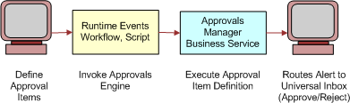

Siebel Order Management Infrastructure Guide > Approvals Manager > About Approval ProcessingIn Siebel order management, administrators can define a number of approval levels without the need for programming, scripting, or configuring. You can define both basic or multiple-step approval processing levels based on the needs of your organization. You can invoke approval processing from a script, a workflow, or a run-time event. Approval ItemAn approval item is an approval process invoked by the Approvals engine. An approval item can be one of two types: parallel or sequential. An approval item with an Approval Flow Type of Parallel is set so that all approvers receive the approval request at the same time. An approval item with an Approval Flow Type of Sequential is set so that each approver receives the approval request only after the prior person approves. If an approver rejects the request, no other approvers further along in the sequence sees the approval request. Approval StageThe approval stage is the set of individuals who must approve the approval item. An approval item can have multiple approval stages. Approval TypesThe individual that is set as an approver can be one of the following approval types:
NOTE: If your organization defines the relationship between Employee and Position as 1:1, the distinction between Approval Types is irrelevant. If your organization chooses to use the approval type Position, only the primary employee for the position is alerted. Automating an approval process involves the following steps:
Interaction of the Approvals engine parts is shown in Figure 38. |
