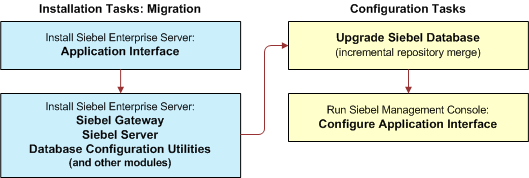

Figure 3 presents a simplified view of the installation and configuration tasks for Siebel CRM server modules for a migration deployment. NOTE: This illustration does not mention installing the Siebel Enterprise Cache or the Siebel Constraint Engine, or configuring security, the Siebel Enterprise Cache, the Siebel Constraint Engine, or the Siebel Migration application. However, those tasks, where applicable, are implicitly part of this roadmap. The Siebel Constraint Engine is available as a developer preview.
Figure 3. Installing and Configuring Servers for a Migration Deployment
