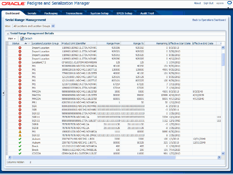

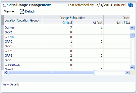

Serial Range Management
Displays a summary view of serial ranges with a count showing how many ranges by location are within their critical or at-risk thresholds. These serial ranges also include ranges nearing exhaustion, as well as, ranges that are nearing their effective end date expiration.

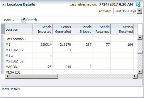

To View Location Detail Summary Information
Navigate to the Operations Dashboard.
Navigate to the Location Details component.
Location Details component (Transaction Activity of Last 365 Days)
The Location Details component appears displaying in a table format each location and the total number of Serials Imported, Serials Generated, Serials Shipped, Serials Returned, Serials Received, Serials Reserved, Serials Commissioned, Serials Decommissioned, and Serials Edited for those locations within the last thirty days. The total number of serials that display for Serials Reserved, Serials Commissioned, Serials Decommissioned, and Serials Edited reflect only the serials that were reserved, commissioned, decommissioned, and edited through the SerialsServiceAMService (Edit Serial Status and Usage) web service.
Last 30 Days appears in the transactions Activity field by default.
At the top of the Location Details component appears the date and time the component was last refreshed and the Refresh Dashboard Component icon.
At the bottom of the Location Details component appears the View Details link, that is used to access the Location Details page.
(Optional) Refresh the information that appears in the Location Details component by clicking the Refresh Dashboard Component icon.
The Location Details component is refreshed and displays the most current information. The "Last refreshed on" field is updated with the current date and time.
(Optional) Change the transaction date range for the Location Details component by selecting another date range using the transactions Activity field. Transaction activities are:
Last 7 Days
Last 30 Days
Appears by default.
Last 60 Days
Last 90 Days
Last 365 Days
The Location Details component is refreshed and displays the location details for the date range selected.

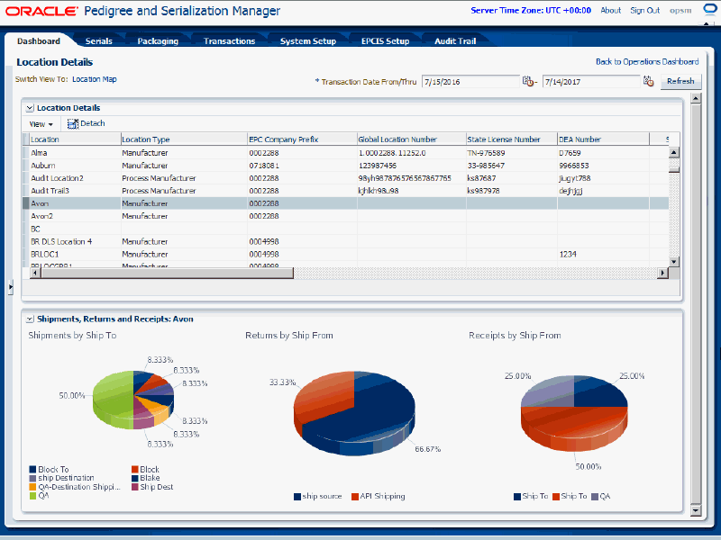

To View Location Details (Table View)
Navigate to the Location Details component within the Operations Dashboard.
Click the View Details link at the bottom of the Location Details component.
The Location Details page appears displaying two regions. The Location Details region and the Shipments, Returns, and Receipts region. Plus, the system populates the actual dates in the Transaction Date From and Thru fields from the transactions Activity value entered previously.
The Location Details region displays each location and the total number of Serials Imported, Serials Generated, Serials Shipped, Serials Returned, Serials Received, Serials Reserved, Serials Commissioned, Serials Decommissioned, and Serials Edited for those locations in a table format. In addition, this table provides a few more details (Location Type, EPC Company Prefix, Global Location Number, State License Number, and DEA Number) for each location.
The Shipments, Returns, and Receipts region displays pie graphs that depict the shipment, return, and receipt transaction activity for the location that is selected in the Location Details region. If no shipment, return, or receipt transaction activity exists a blank circle appears in the region stating "No Data to Display".
(Optional) Hover over the different sections in the pie graph to view details for that location.
A text box appears displaying the name (ship from or ship to) and the total number of shipment, returns, and receipts.
(Optional) View the Shipments, Returns, and Receipts pie graphs for another location by selecting a different location in the Location Details region.
The Shipments, Returns, and Receipts region is refreshed and displays the pie graphs for the location selected in the Location Details region.
(Optional) Change the transaction date range by selecting a different date range using the Transaction Date From and Transaction Date Thru fields and then click the Refresh button.
The Location Details page is refreshed and displays the information for the new date range.
To return to the main Operations Dashboard page, click the Back to Operations Dashboard link in the upper right corner of the Location Details page.

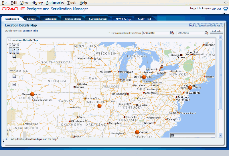

To View Location Details (Map View)
The Location Details page appears.
Click the Location Map link in the Switch View To field at the top of the page.
Location Details Map page
The Location Details Map page appears displaying location data points in a geographic map.
Note: For the geographic map functionality to work correctly you must have specified the longitude and latitude for each location using the Maintain Locations page.
For information on setting up locations, see Maintaining Locations.
(Optional) View basic location information by clicking a location data point on the map.
The Location Details dialog box appears displaying basic information including total number of serials that were imported, generated, shipped, returned, received, reserved, commissioned, decommissioned, and edited.
Click the OK button to close the dialog box.
(Optional) Navigate within the map by using the Pan and Zoom In and Out buttons provided in the map. You can also use the drag and drop functionality to move around the map view.
Return to the Location table view by clicking the Location Table link in the Switch View To field or you can return to the main Operations Dashboard page by clicking the Back to Operations Dashboard link in the upper right corner of the Location Details Map page.

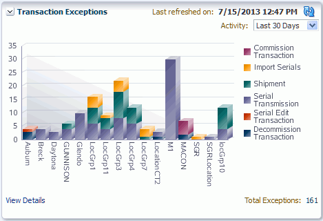

Use the Transaction Exceptions component of the Operations Dashboard to view a summary of the total number of transaction exceptions for each location and transaction type for a given date range.
These transactions exceptions metrics are only displayed for transactions created through the Java web services. No exceptions display for receipt transactions as the receipt transactions are created through a PL/SQL web service.
If you are using location security, only the transaction exception information that pertains to the transaction locations that you have at a minimum read access to in the Location Security Setup page will display in this component.
For more information on location security, see Location Security Overview.
From the Transaction Exceptions component you can access the Transaction Exceptions detail page where you can view:
More detailed information for each transaction exception.
Transaction Exceptions metric by location and transaction type.
Stacked bar graphs displaying the total number of transaction exceptions by location and transaction type.
Open (detected) exception messages associated with the transaction exception.
The Transaction Exceptions component appears displaying stacked bar graphs for each location and the total number of exceptions within the last thirty days for each type of transaction within those locations in a different color.
Last 30 Days appears in the Transaction Exceptions Activity field by default.
At the top of the Transaction Exceptions component appears the date and time the component was last refreshed and the Refresh Dashboard Component icon.
At the bottom of the component appears the View Details link and the total number of exception transactions for all locations. The View Details link is used to access the Transaction Exceptions detail page.
(Optional) Hover over the different colors in the bar graphs to view exception details for that location and type of transaction.
A text box appears displaying transaction type, location, and total number of transaction exceptions for that type.
(Optional) Refresh the information that appears in the Transaction Exceptions component by clicking the Refresh Dashboard Component icon.
The Transaction Exceptions component is refreshed and displays the most current information. The "Last refreshed on" field is updated with the current date and time.

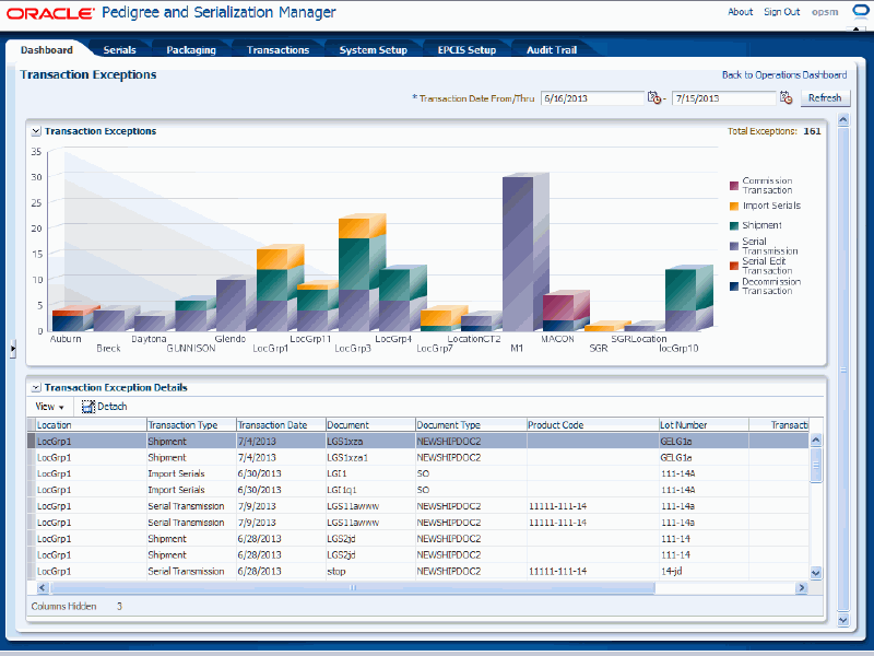

To View Transaction Exceptions Detail Information
Navigate to the Transaction Exceptions component within the Operations Dashboard.
Click the View Details link at the bottom of the Transaction Exceptions component.
The Transaction Exceptions detail page appears displaying the Transaction Exceptions region and the Transaction Exception Details region for the first location. In the Transactions Exception region of the page, the system displays a summary of the total number of transaction exceptions for each location and transaction type in a stacked bar graph format. Each bar graph represents a different location. In the upper right hand side of the region the total number of exceptions for all locations appears in the Total Exceptions field.
In the Transaction Exception Details region, the system displays in a table format the individual transaction records that make up those transaction exceptions. An "Exception Details" column appears in the table displaying an Exception Details icon. Click the icon to access the Exception Details page where you can view the actual open messages for the exception transaction.
Plus, the system populates the actual dates in the Transaction Date From and Thru fields from the Transaction Exception Activity value entered previously.
(Optional) View the transaction exception record details for another location by clicking an individual bar graph in the Transaction Exceptions region of the page.
The Transaction Exceptions Detail region is refreshed and displays in table format the detailed transaction exception records for the location selected in the bar graph.
(Optional) View the exception messages for a transaction by clicking the Exception Details icon in the Exception Details column in the table in the Transaction region of the page.
The Exception Details dialog box appears displaying the actual open (detected) exception messages for the transaction. Click the OK button to close the dialog box.
(Optional) Change the transaction exception date range by selecting a different date range using the Transaction Date From and Transaction Date Thru fields and then click the Refresh button.
The Transaction Exceptions page is refreshed and displays the information for the new date range.
To return to the main Operations Dashboard page, click the Back to Operations Dashboard link in the upper right corner of the Transaction Exceptions page.

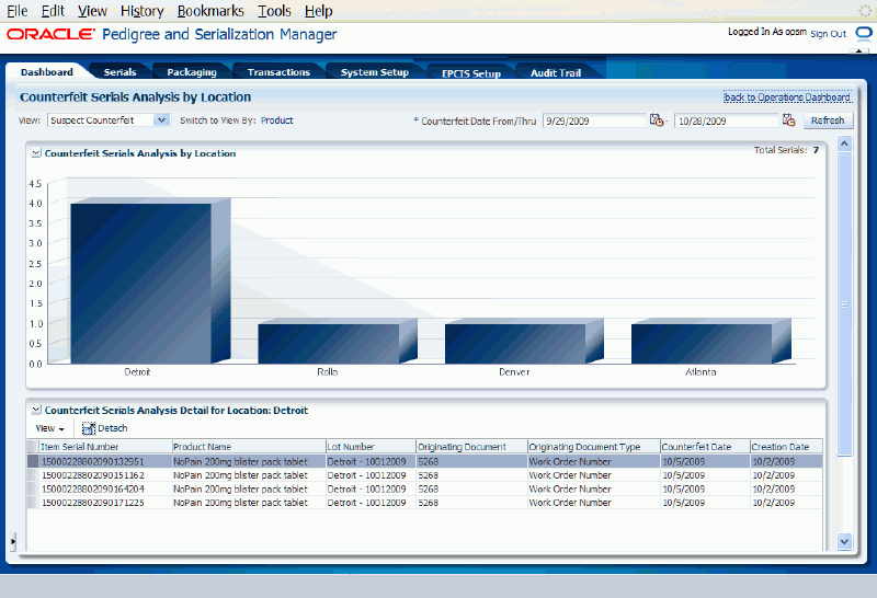

Use the Counterfeit Serials Analysis component of the Operations Dashboard to view a summary of the total number of suspect counterfeit, verified not counterfeit, or counterfeit serials in Oracle Pedigree and Serialization Manager (OPSM) by either product or location for a given date range.
If you are using location security, only the counterfeit information that is related to the serial locations that you have at a minimum read access to in the Location Security Setup page will display in this component.
From the Counterfeit Serials Analysis component you can access the Counterfeit Serials Analysis by Product or the Counterfeit Serials Analysis by Location pages where you can view:
More detailed information for each suspect counterfeit, verified not counterfeit, or counterfeit serial by product or location.
Counterfeit serials analysis metric by product or location.
Bar graphs displaying the total number of suspect counterfeit, verified not counterfeit, or counterfeit serials by product or location.
Duplicate serial information for the suspect counterfeit, verified not counterfeit, or counterfeit serial.

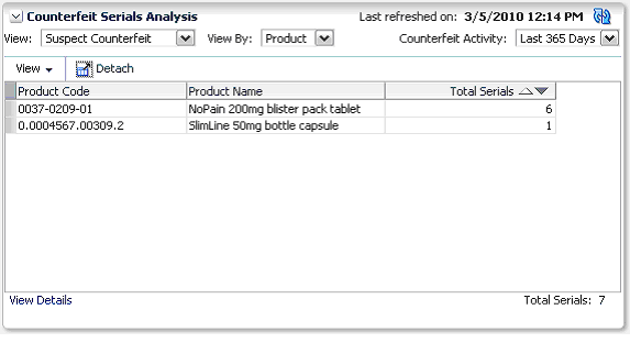

Counterfeit Serials Analysis component (Product View By)
The Counterfeit Serials Analysis component appears displaying in a table format each product and the total number of suspect counterfeit serials for those products within the last thirty days.
Suspect Counterfeit appears in the View field by default.
Product appears in the View By field by default.
Last 30 Days appears in the Counterfeit Activity field by default.
At the top of the Counterfeit Serials Analysis component appears the date and time the component was last refreshed and the Refresh Dashboard Component icon.
At the bottom of the component appear the View Details link and the total number of suspect counterfeit serials for all products. The View Details link is used to access the Counterfeit Serials Analysis by Product or the Counterfeit Serials Analysis by Location pages.

Navigate to the Counterfeit Serials Analysis component within the Operations Dashboard.
Click the View Details link at the bottom of the Counterfeit Serials Analysis component.
Counterfeit Serials Analysis by Product page
Depending on the value in the View By field either the Counterfeit Serials Analysis by Product page or Counterfeit Serials Analysis by Location page appears. These two pages operate the same way except one page displays the counterfeit serial analysis details by product and the other one the counterfeit serial analysis details by location.
In the upper region of the page, the system displays a summary of the total number of suspect counterfeit, verified not counterfeit, or counterfeit serials by product or location in a bar graph format. Each bar graph represents a different product or location. In the upper right hand side of the region the total number of serials appears in the Total Serials field.
In the lower region of the page, the system displays in a table format the individual serial records that make up those suspect counterfeit, verified not counterfeit, or counterfeit totals for the product or the location. A "Duplicates Exist" column appears in the table displaying a Duplicates Exists icon if there are duplicate serials. Click the icon to access the Duplicate Serial dialog box where you can view the original serials and any other serials that may be duplicates.
Plus, the system populates the actual dates in the Counterfeit Date From and Thru fields from the Counterfeit Activity value entered previously.
(Optional) Hover over the bar graph to view details for that product or location.
A text box appears displaying either the product code, product name, and total number of serials or location and total number of serials.
(Optional) View the serial record details for another product or location by clicking an individual bar graph in the upper region of the page.
The lower region of the page is refreshed and displays in table format the detailed serial records for the product or location selected in the bar graph.
(Optional) View the duplicate information for a serial by clicking the Duplicates Exist icon in the Duplicates Exist column in the table in the lower region of the page.
The Duplicate Serials dialog box appears displaying the original and other serial numbers that are duplicates. These serials may be the reason for the suspect counterfeit or counterfeit serials.
(Optional) View a different counterfeit type analysis by selecting a different view using the View field. Values are:
Counterfeit
Suspect Counterfeit
The Counterfeit Serials Analysis by Product or by Location page is refreshed and displays the serial information pertaining to that counterfeit type. For example, you can change from viewing suspect counterfeit serials by product to viewing counterfeit serials by product.
View a different counterfeit serial analysis breakdown by clicking the link next to the Switch to View By field. Links are:
Location
Product
The Counterfeit Serials Analysis by Product or by Location page is refreshed and displays in a table format the total number of suspect counterfeit, verified not counterfeit, or counterfeit serials by product or location.
(Optional) Change the counterfeit date range by selecting a different date range using the Counterfeit Date From and Counterfeit Date Thru fields and then click the Refresh button.
The Counterfeit Serials Analysis by Product or by Location page is refreshed and displays the information for the new date range.
To return to the main Operations Dashboard page, click the Back to Operations Dashboard link in the upper right corner of the Counterfeit Serials Analysis by Product or by Location page.

Navigate to the Serial Range Management component.
The Serial Range Management component appears displaying in a table format each location or location group and a total count of how many ranges are near range exhaustion (within their critical or at-risk thresholds) and how many ranges are near their end date expiration (next 7 days or next 8-30 days).
At the top of the Serial Range Management component appears the date and time the component was last refreshed and the Refresh Dashboard Component icon.
At the bottom of the Serial Range Management component appears the View Details link which is used to access the Serial Range Management page.
(Optional) Refresh the information that appears in the Serial Range Management component by clicking the Refresh Dashboard Component icon.
The Serial Range Management component is refreshed and displays the most current information. The "Last refreshed on" field is updated with the current date and time.
The Serial Range Management page appears displaying detailed information for all active serial ranges in the system for all locations and location groups, a specific location, or a specific location group in a table format. All Locations and Location Groups appears in the View field by default when you access the page from the View Details link. Otherwise, the specific location or location group appears in the View field by default when accessing the page from the Location or Location Group link in the table.
The Status column in the table displays a different icon to indicate if the ranges are within a critical or at-risk threshold based on either running out of serial numbers in the range or the ranges effective end date is nearing expiration. A different icon appears for each serial range status. Statuses are:
Green check mark: Indicates that the range is not critical or at risk of exhaustion or expiration, or no thresholds have been defined.
Yellow Triangle with Exclamation Point: Indicates that the range is at risk of nearing exhaustion.
Red Circle with an X in the Middle: Indicates that the range is critical of nearing exhaustion.
Blue Calendar page: Indicates the range is at risk of nearing effective date expiration.
Yellow Calendar page with Exclamation Point: Indicates the range is critical and nearing effective end date.
