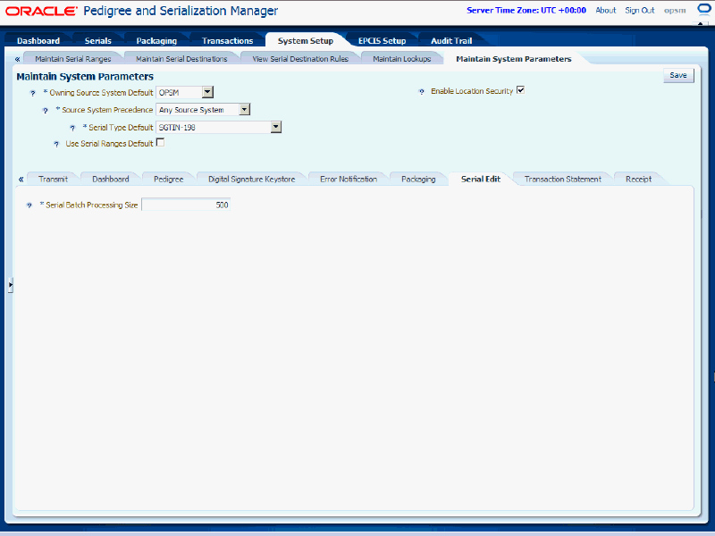

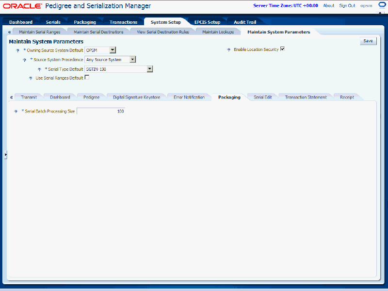

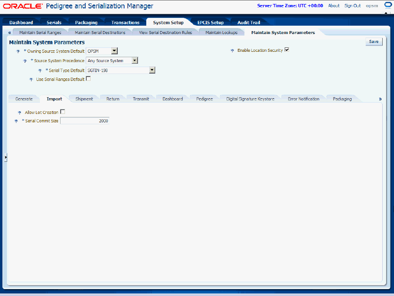

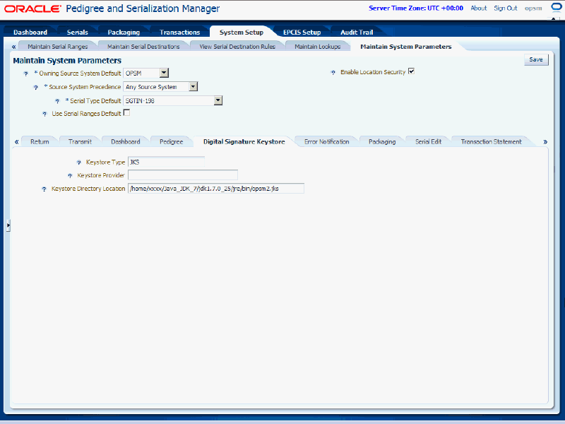

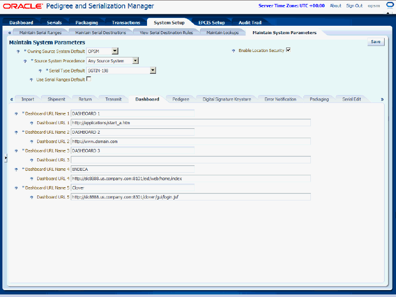

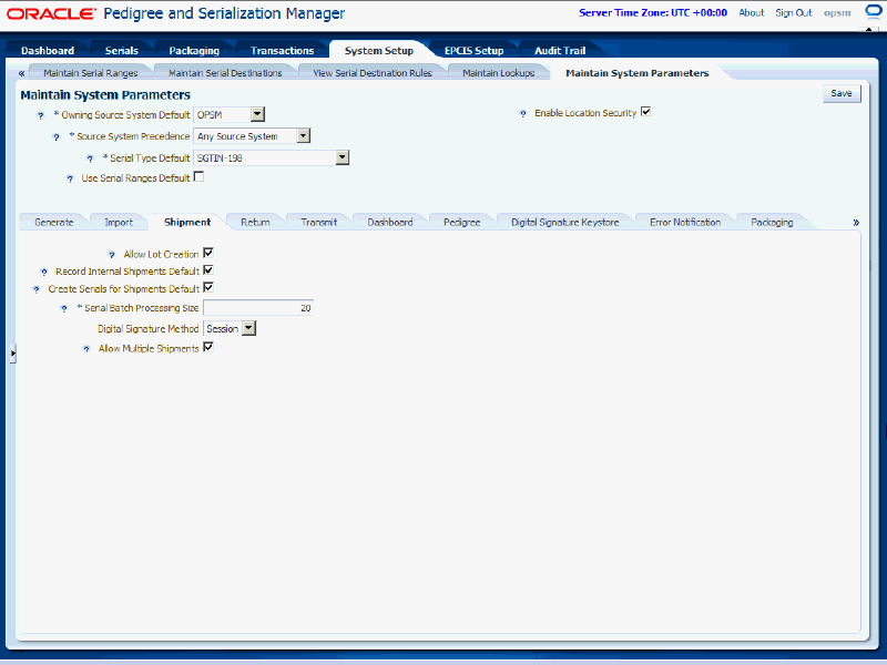

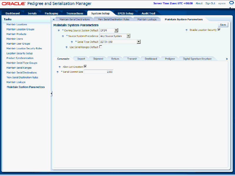

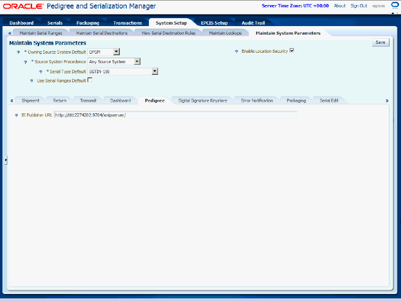

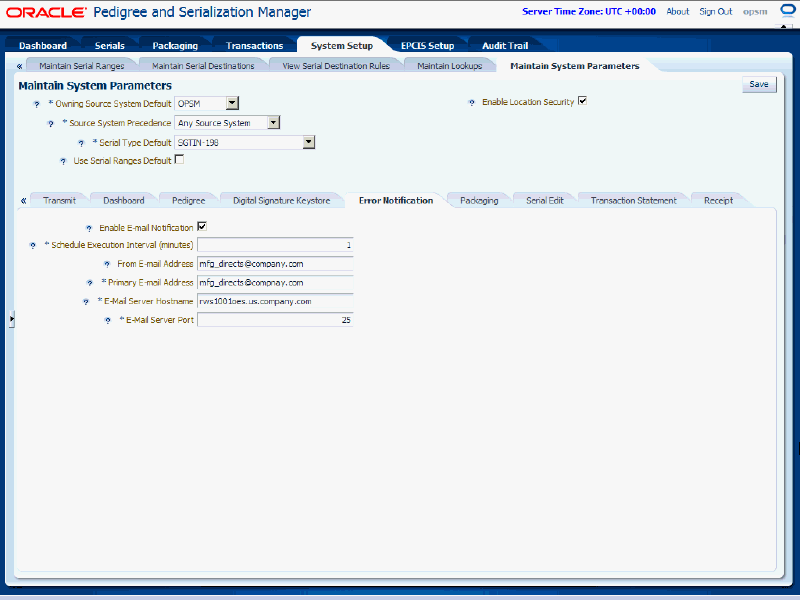

Set up OPSM system parameters.
For more information, see Maintaining System Parameters.

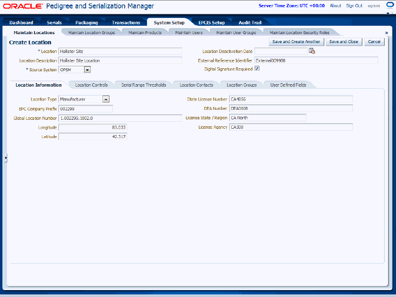

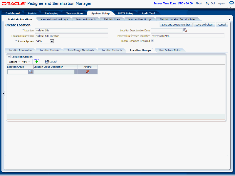

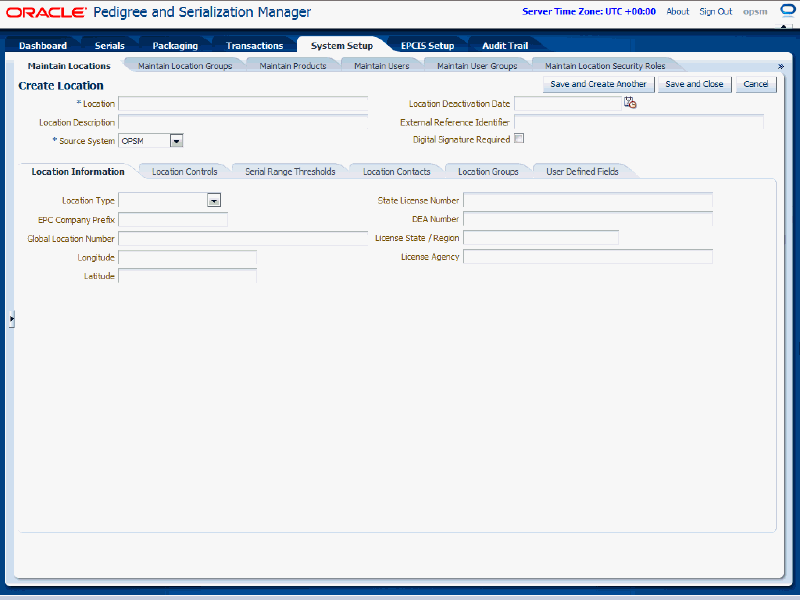

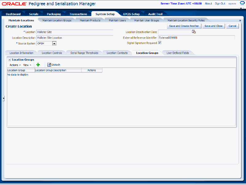

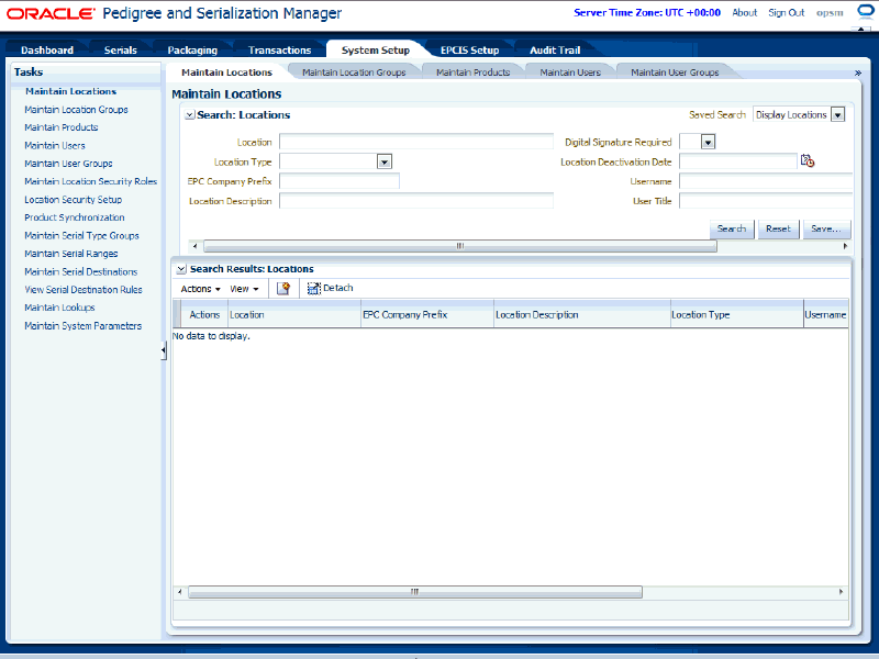

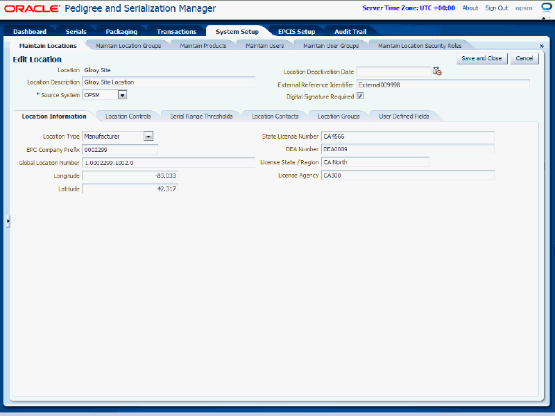

Create locations.
For more information, see Maintaining Locations.

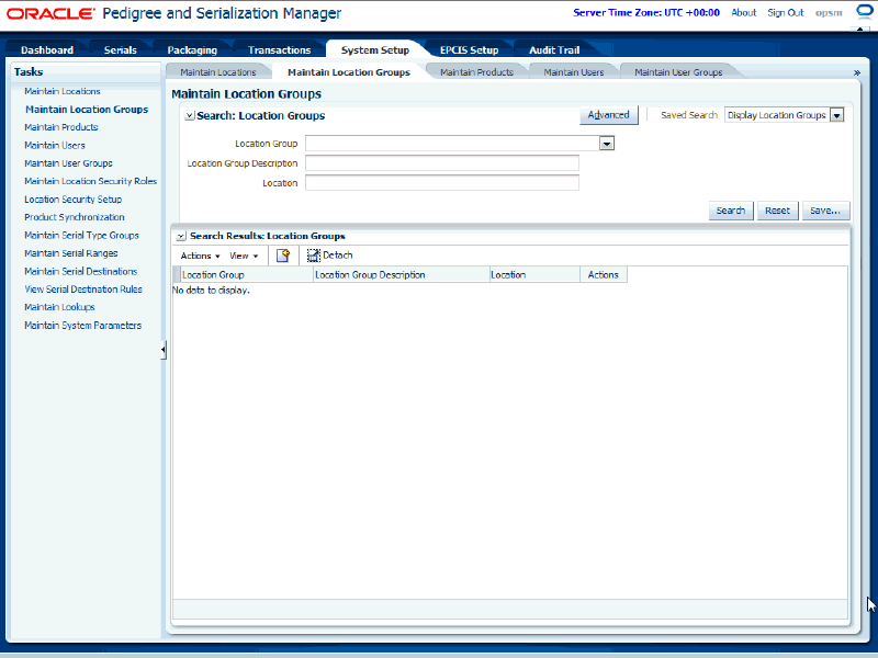

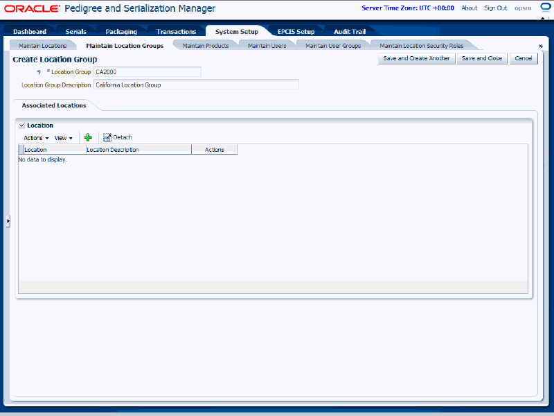

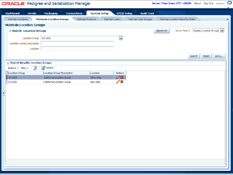

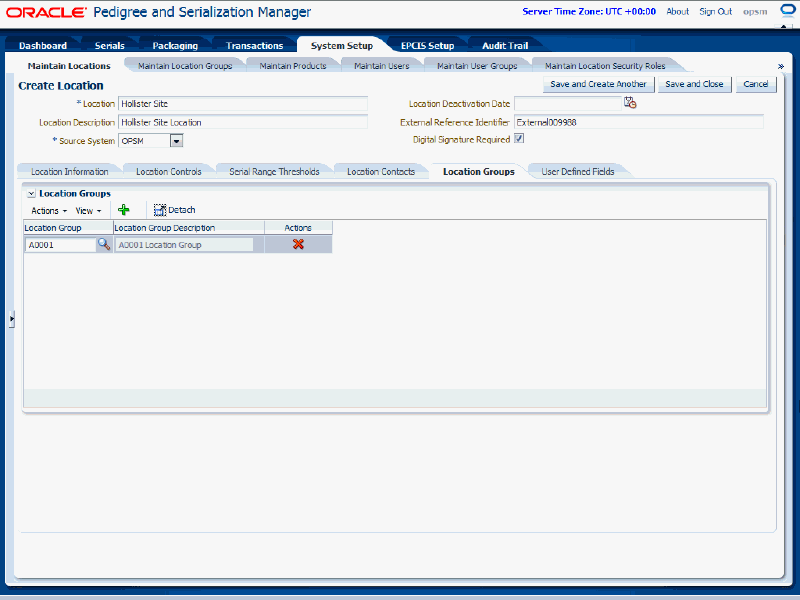

Create location groups (optional).
For more information, see Maintaining Location Groups.

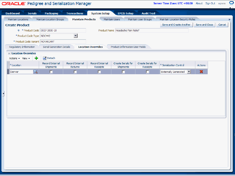

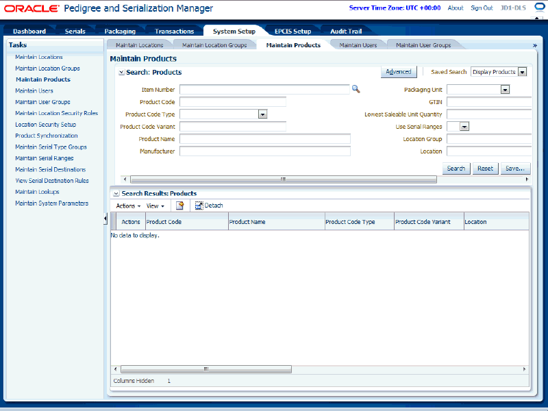

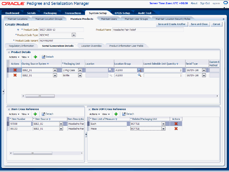

Create Products and Item Cross Reference.
For more information, see Understanding the Product Definition Process, Maintaining Products, Defining Product and Item Cross Reference Information from Integrated Transactional Systems, Synchronizing Products (Products Interface table), and

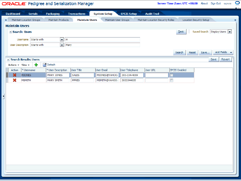

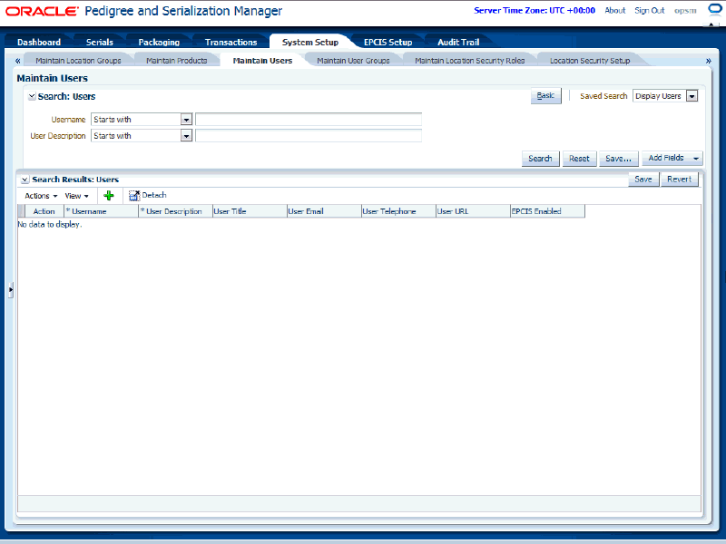

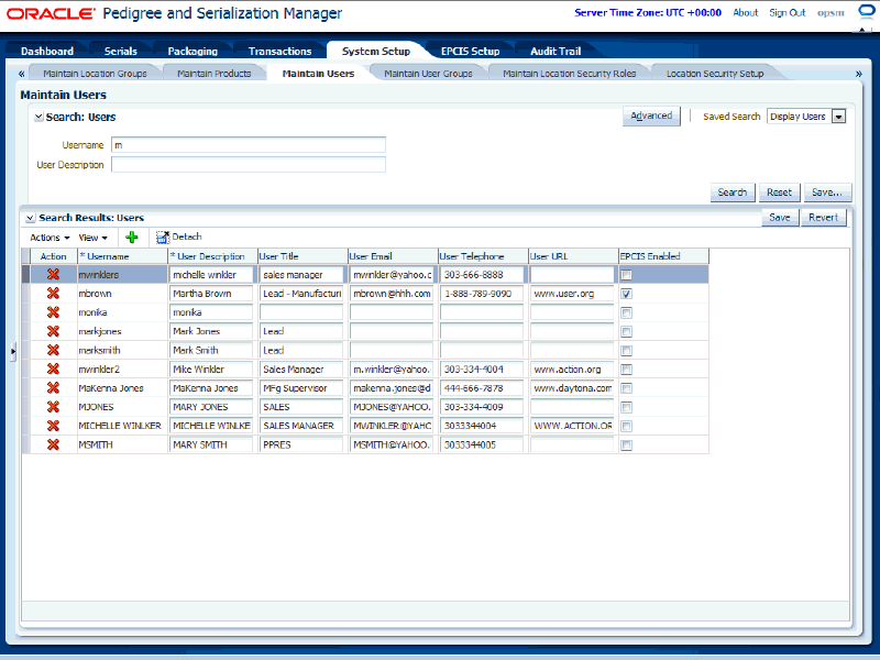

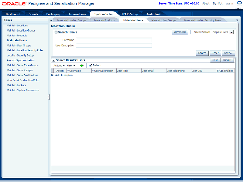

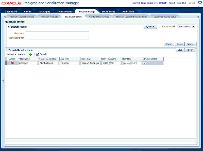

Create users (optional).
For more information, see Maintaining Users.

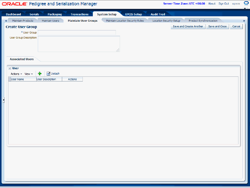

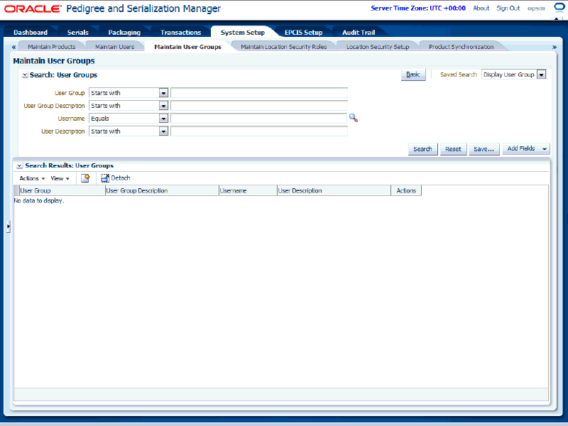

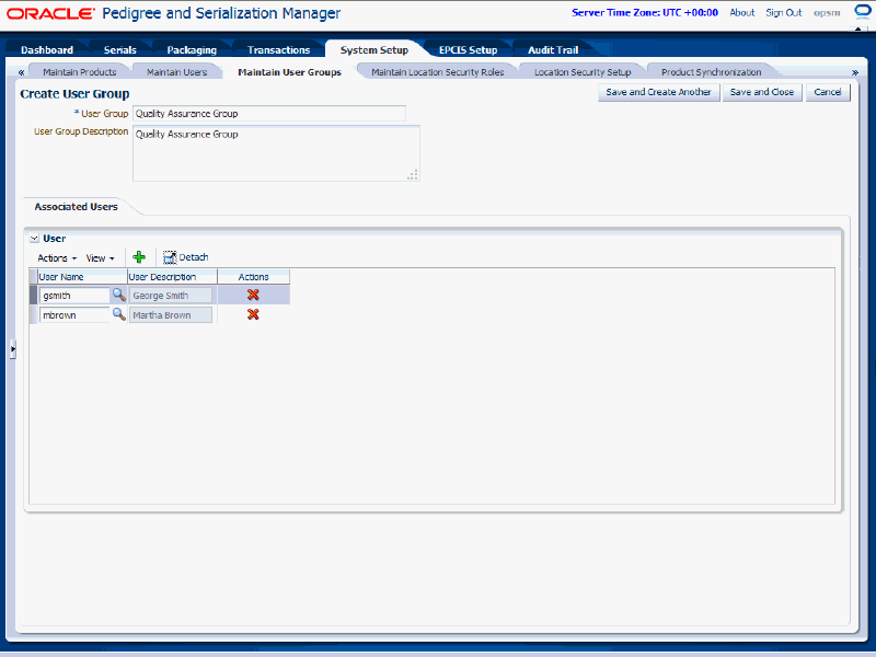

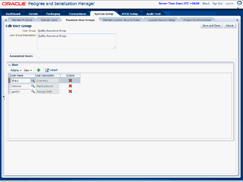

Create user groups (optional)
For more information, see Maintaining User Groups.

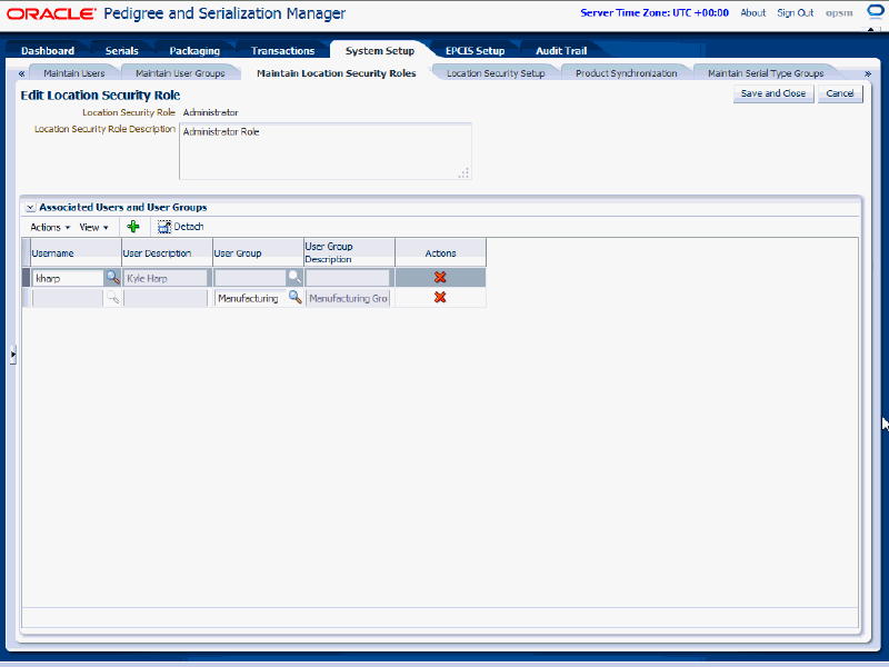

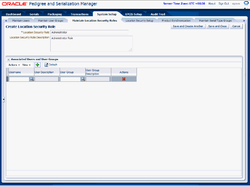

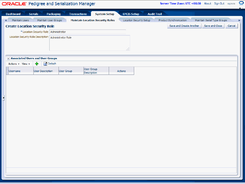

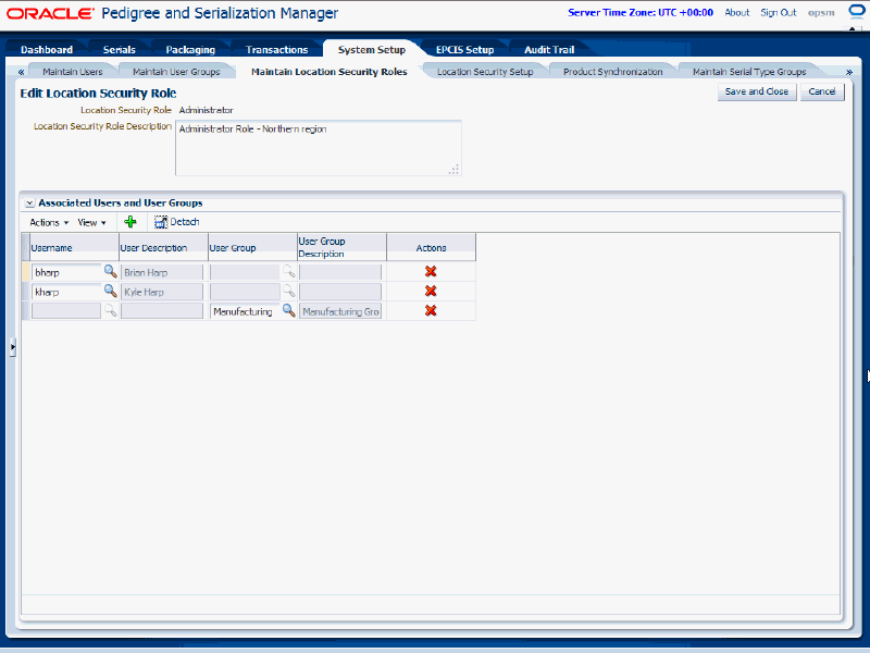

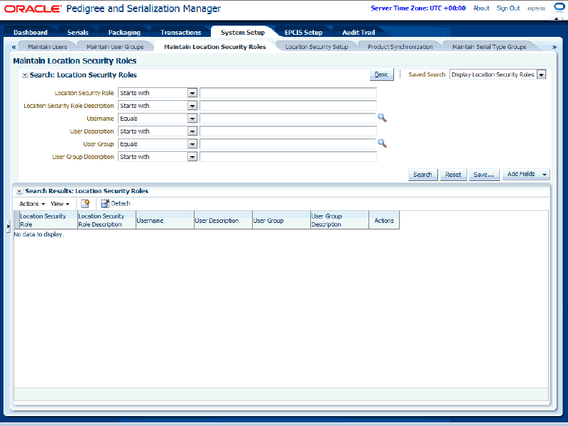

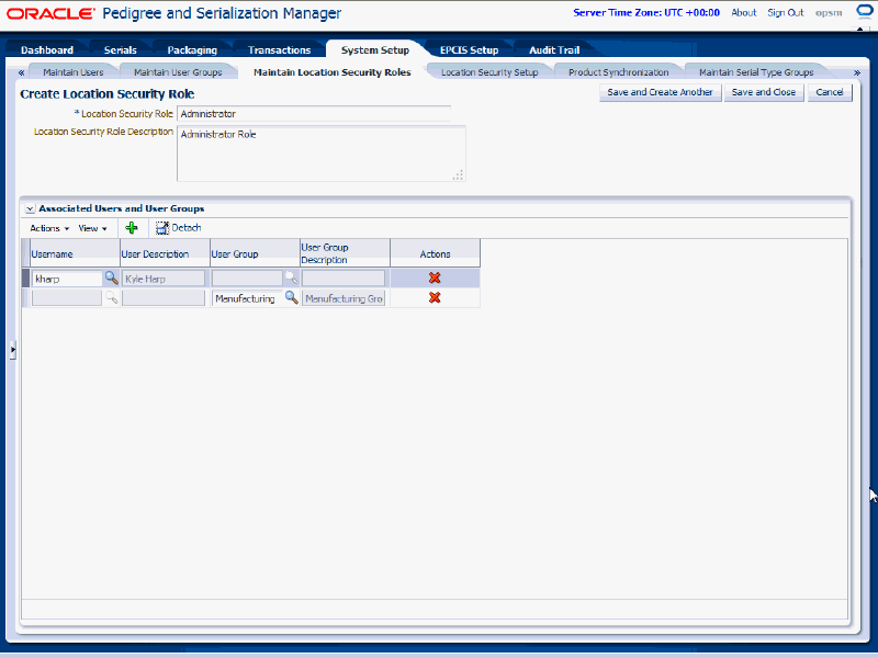

Create location security roles (optional)
For more information, see Maintaining Location Security Roles.

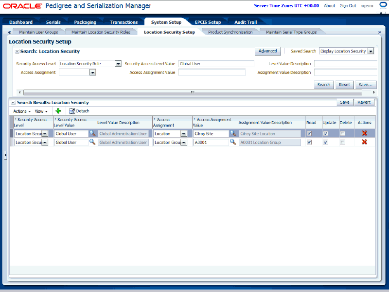

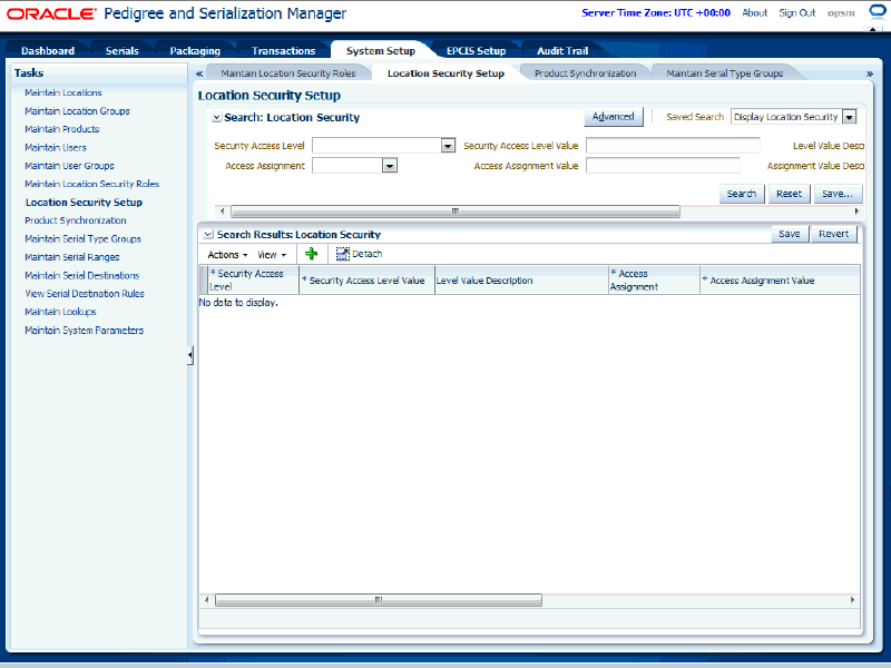

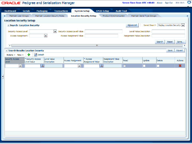

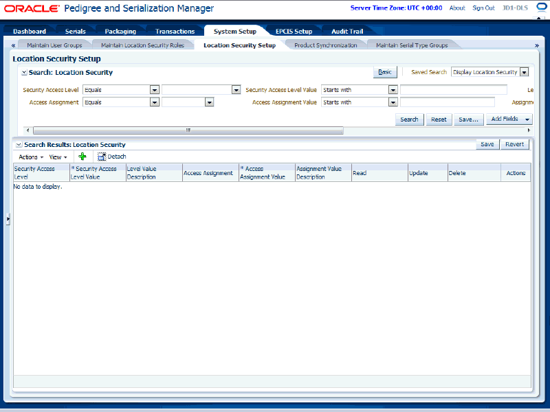

Set up location security (optional)
For more information, see Maintaining Location Security.

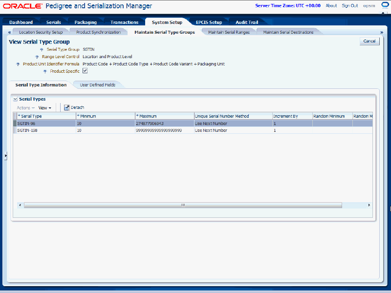

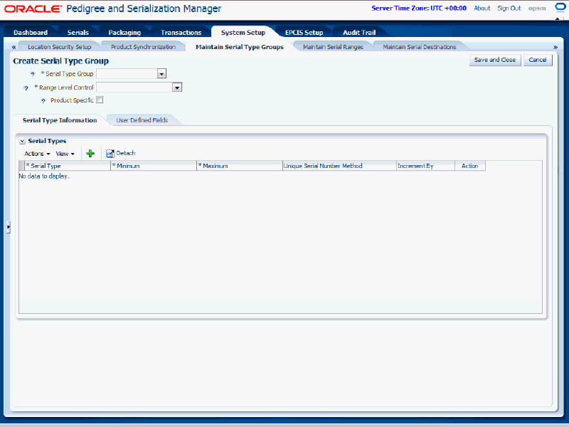

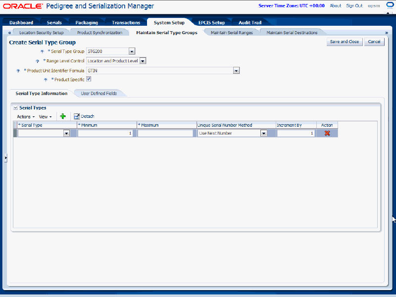

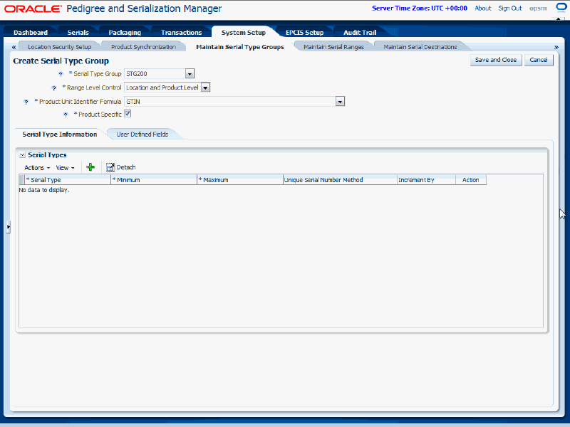

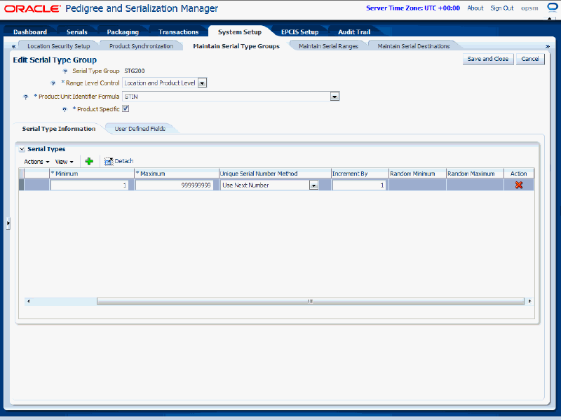

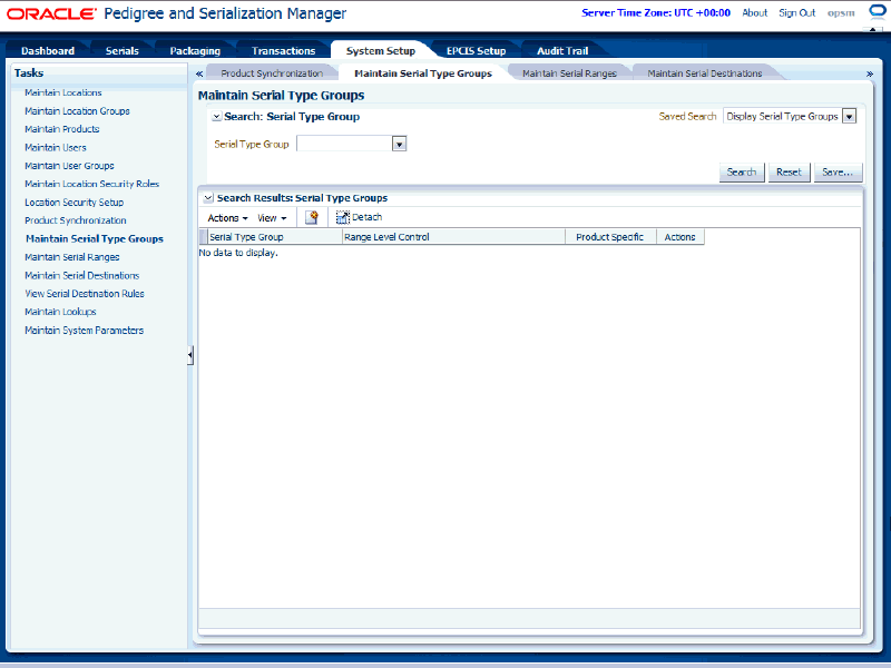

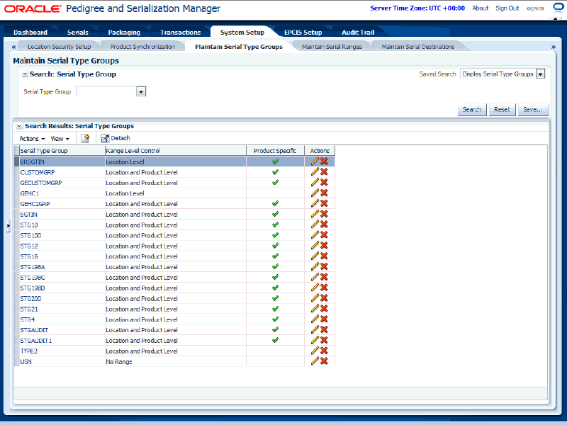

Create serial type groups and serial types.
For more information, see Maintaining Serial Type Groups and Serial Types.

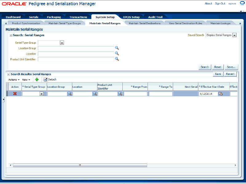

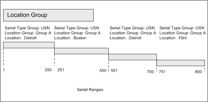

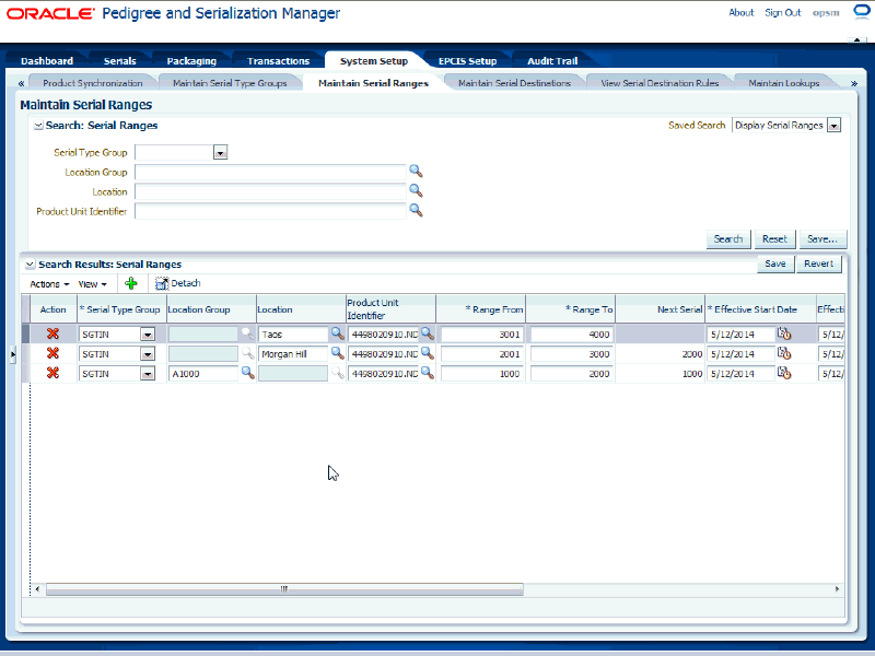

Create serial ranges (optional).
For more information, see Maintaining Serial Ranges.

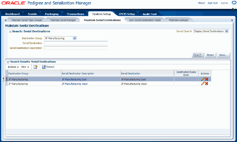

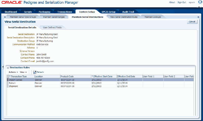

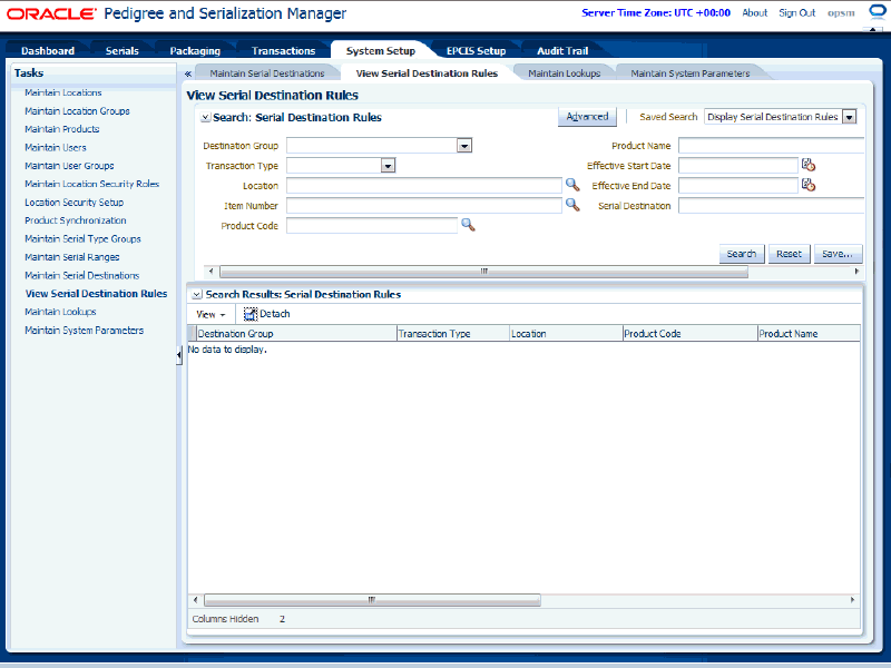

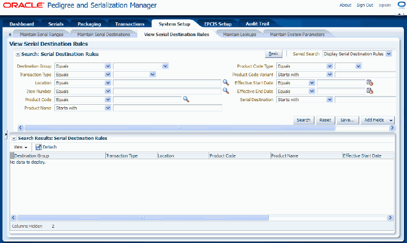

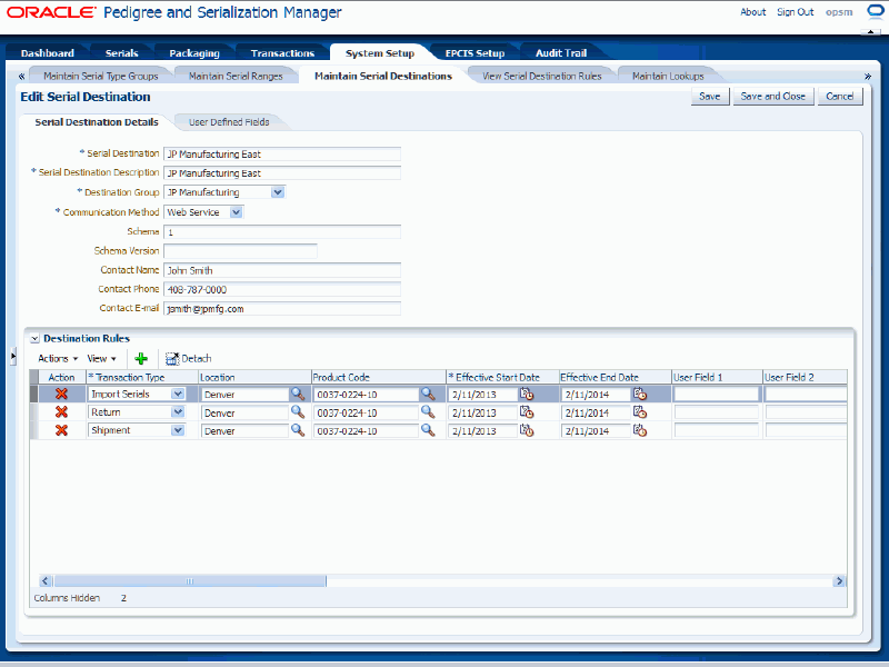

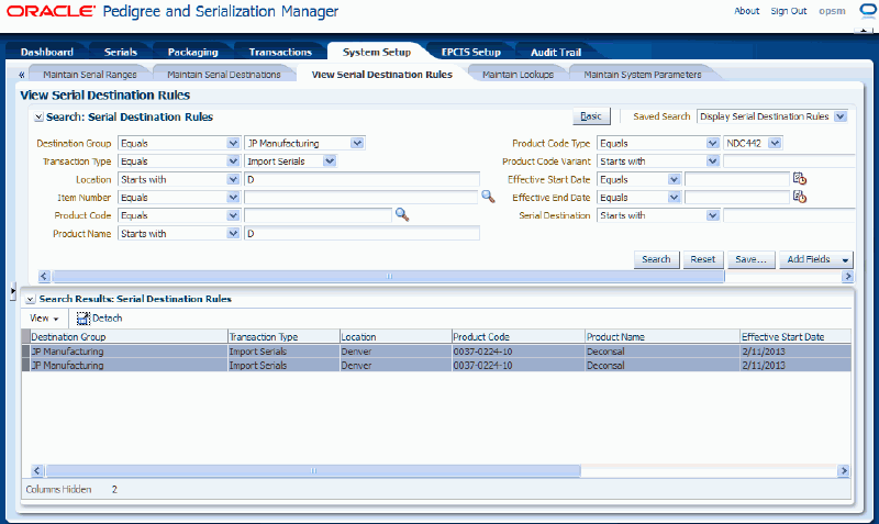

Create serial destinations and destination rules (optional).
For more information, see Maintaining Serial Destinations and Destination Rules and Viewing Serial Destination Rules.

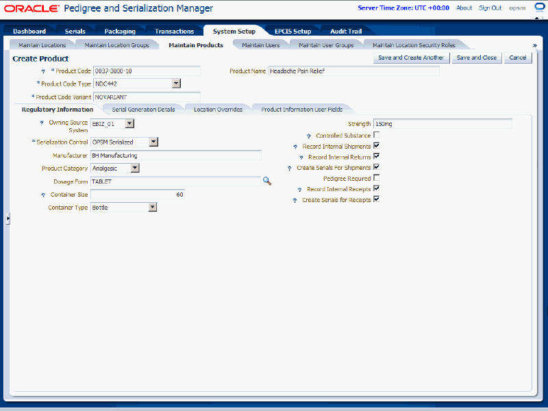

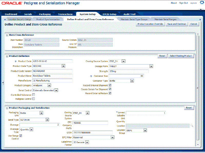

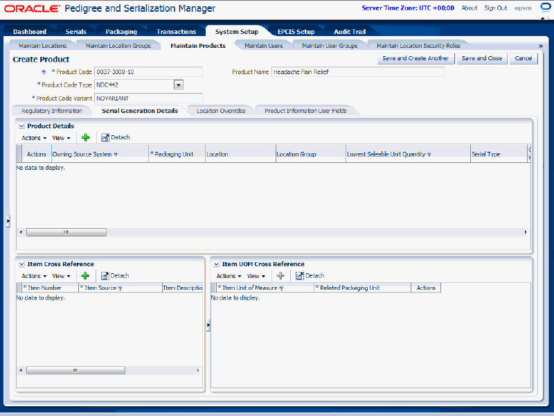

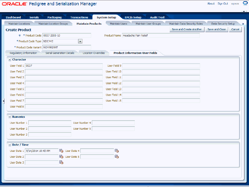

New products can be created directly in the Oracle Pedigree and Serialization Manager (OPSM) application with a cross reference to the item in one or more transactional systems. OPSM is the central repository for product definitions. OPSM stores the attributes used to identify the product, the required regulatory product attributes required to generate a pedigree, and the product packaging level information and attributes that control serialization of the product packaging unit.
The serialization attributes determine the serial type, serial generation overage amounts, and serial range control. The process control attributes for the product determine the following:
If serials are tracked for transactions with no change of ownership
If pedigrees are created
If serials can be created from shipment and receipt transactions
If serials are generated by OPSM or externally for the product

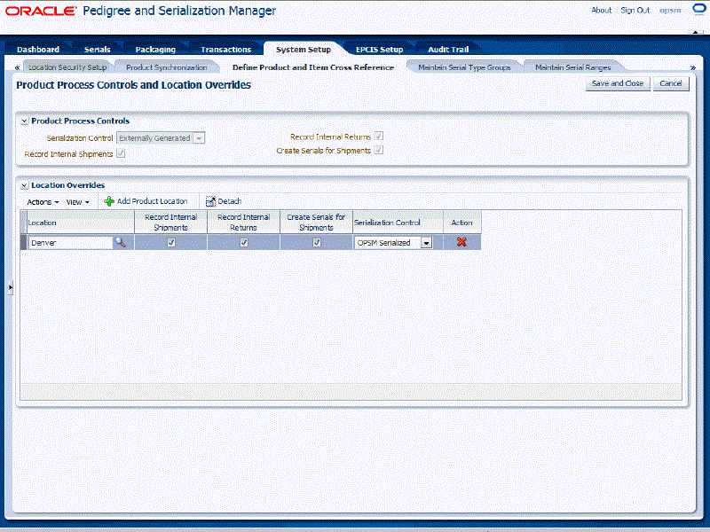

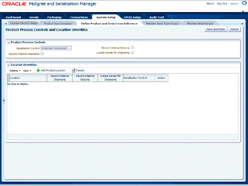

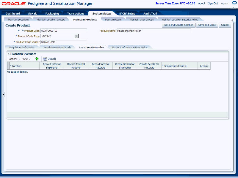

The process control attributes for the product can be overridden by location.

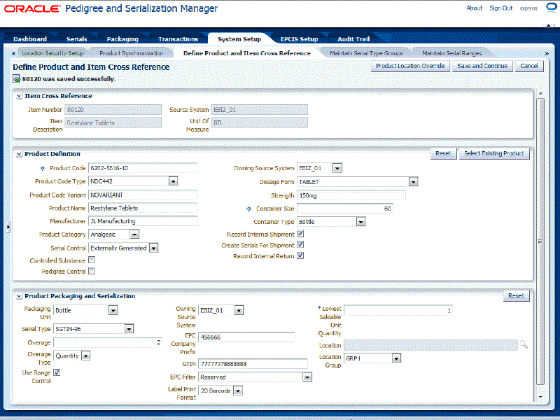

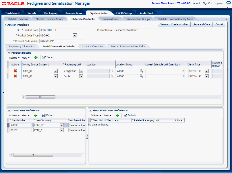

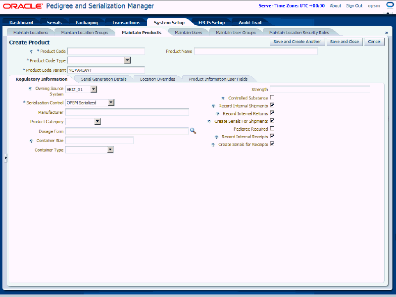

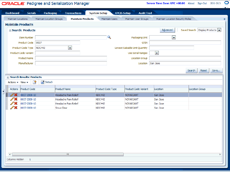

Products can be defined in OPSM in these ways:

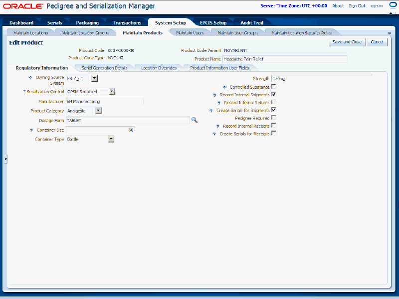

Using the Maintain Products page in OPSM. Product information can be created, modified, or deleted using the OPSM product pages.
For more information on defining products in OPSM, see Maintaining Products.

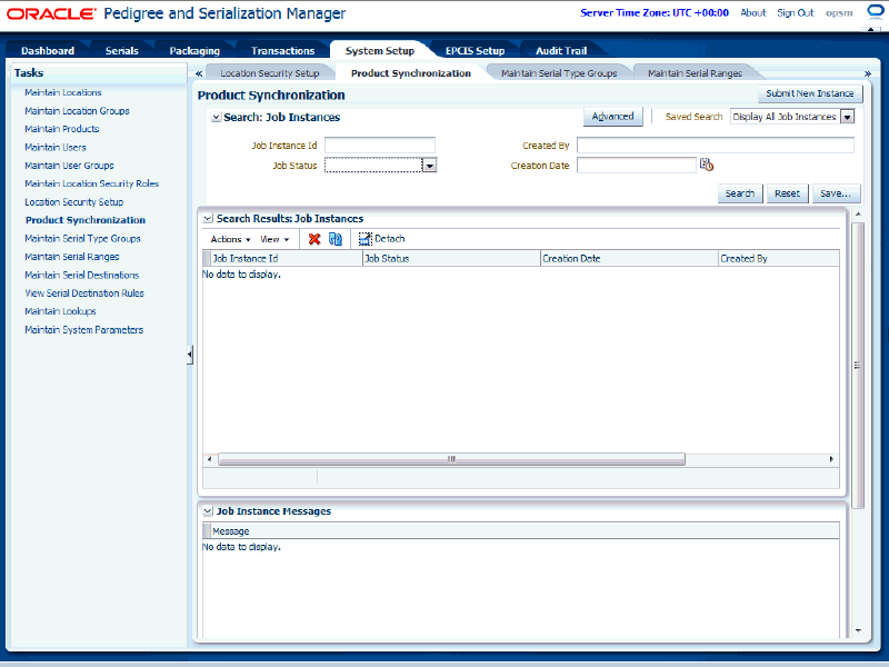

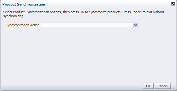

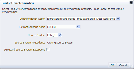

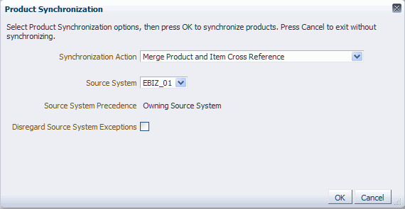

Using the Product Synchronization process. Product and item cross reference information can be merged from the Products Interface table.
For more information, see Synchronizing Products (Products Interface Table).

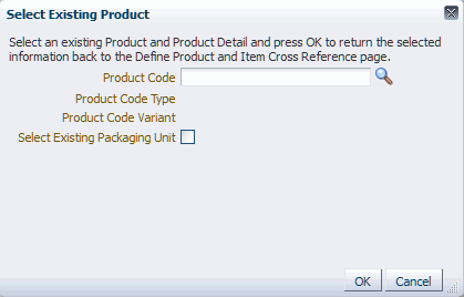

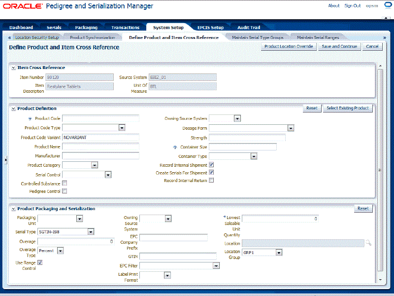

Using the Define Product and Item Cross Reference page in OPSM. From an external system, you can call the OPSM Define Product and Item Cross Reference page where you can define all of the different product attributes for the product in OPSM as it relates to the item from the transactional system. You can also specify the product overrides by location if necessary.
For more information, see Defining Product and Item Cross Reference Information from Integrated Transactional Systems.
Using the Product Service web service in OPSM. From an external system, product information can be created or updated using the Product Service web service.
For more information, see Web Service Details.
The Oracle Serialization and Tracking Integration Pack for Oracle Pedigree and Serialization Manager and Oracle E-Business Suite 3.1 can be used to synchronize product and item cross reference information from Oracle E-Business Suite to OPSM using one of the following methods:
Calling the OPSM Define Product and Item Cross Reference page from the Oracle E-Business Suite (Oracle Inventory) Master Item window or from the Organization Item window.
The Source System Precedence setting in the OPSM system parameters controls whether product and product detail information can be updated from any source system or only from the owning source system. The owning source system is recorded on the product and product detail records.
For information on defining products using the Define Product and Item Cross Reference page, see Defining Product and Item Cross Reference Information from Integrated Transactional Systems.
For more information on maintaining system parameters, see Maintaining System Parameters.
Using the batch product synchronization process between Oracle E-Business Suite and OPSM. Using the Product Synchronization page in OPSM you initiate the product synchronization process between these two applications.
For more information on synchronizing products, see Synchronizing Products (Products Interface Table).
For more information on integrating Oracle E-Business Suite with OPSM, see the Oracle Serialization and Tracking Integration Pack for Oracle Pedigree and Serialization Manager and Oracle E-Business Suite 3.1 - Implementation Guide.

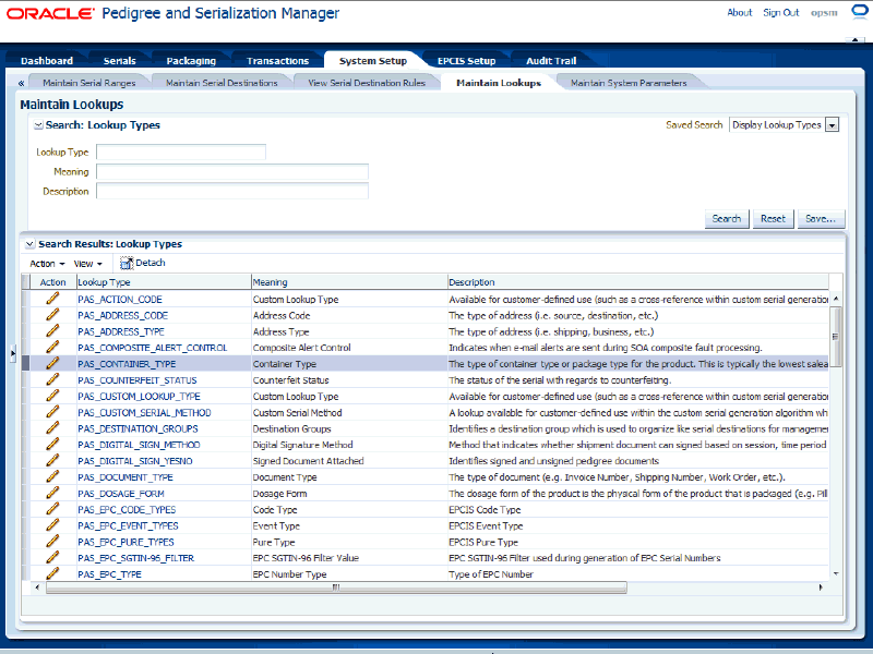

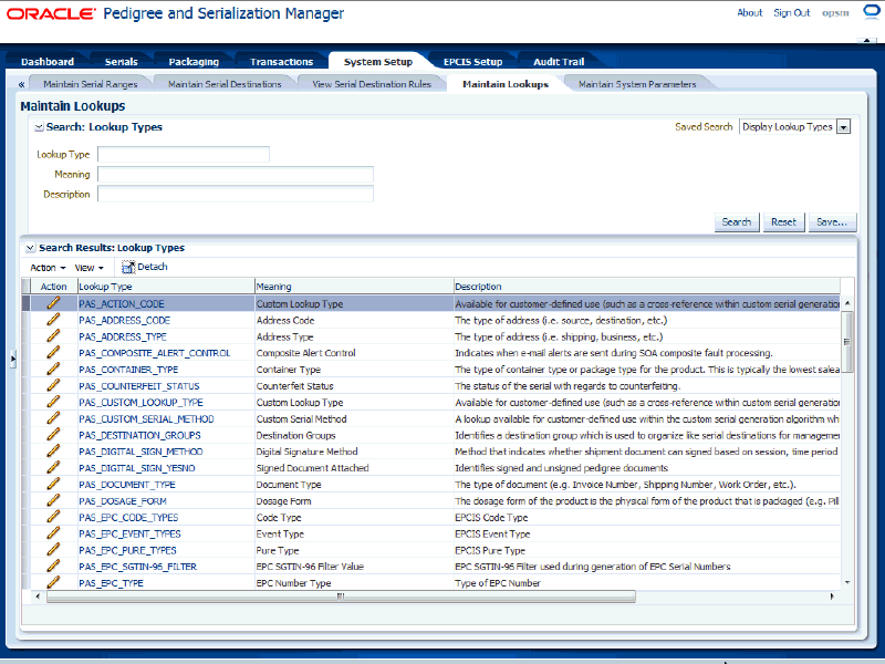

Use these procedures to search for, view, edit, delete, and translate lookup types and codes:

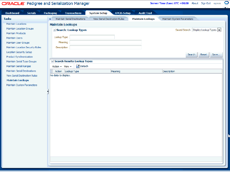

Navigate to the Maintain Lookups page.
In the Search: Lookup Types region, enter the search criteria for the lookup types using one or more of these fields:
| Field Name | Description |
| Lookup Type | (Optional) Enter the lookup type. |
| Meaning | (Optional) Enter the meaning for the lookup type. |
| Description | (Optional) Enter the description for the lookup type. |
Otherwise, you can click the Search button without entering any search criteria and all available lookup types appear.
Click the Search button.
All of the lookup types that match the search criteria appear in the Search Results: Lookup Types region in a table format.
Enter search criteria for the lookup types you want to view and click the Search button.
All of the lookup types that match the search criteria appear in the Search Results: Lookup Types table.

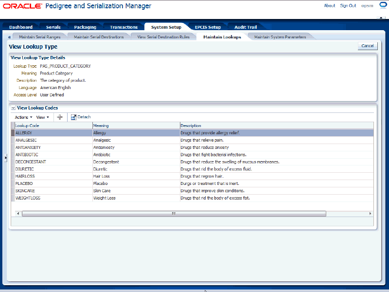

Click the Lookup Type link in the table for the lookup type for which you want to view the details.
View Lookup Type page
The View Lookup Type page appears displaying the details (Meaning, Description, Language, and Access Level) for the lookup type and all of its associated lookup codes with their meaning and description.
Click the Cancel button to return to the Maintain Lookups page.

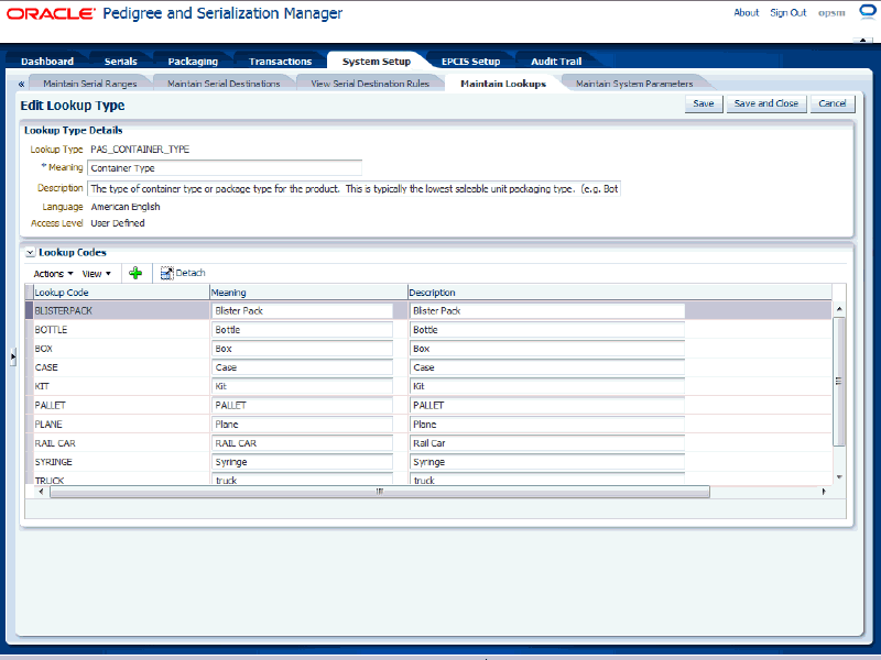

To Edit Lookup Types and Codes
Enter search criteria for the lookup types you want to edit and click the Search button.
Select the lookup type in the table for which you want to edit the lookup type fields or edit the lookup codes.
For all Access Level (User Defined, Extensible, and System) lookup types you can edit the Meaning and Description fields for the lookup type and its associated lookup codes.

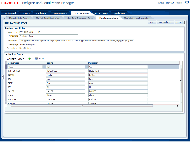

Select Edit in the Action menu or click the Edit Lookups icon associated with the lookup type in the Action column of the results table.
Edit Lookup Type page
The Edit Lookup Type page appears displaying the details (Meaning, Description, Language, and Access Level) for the lookup type and all of its associated lookup codes with their meaning and description.
Edit the lookup type fields by changing the Meaning and Description fields associated with the lookup type in the Lookup Type Details region of the page.
Edit the lookup code fields by changing the Meaning and Description fields for the lookup codes in the Lookup Codes region of the page.
Save your work. Choose one of these options:
Click the Save and Close button to save the information and return back to the Maintain Lookups page.
Click the Save button to save the information and to stay on this page so you can continue to edit the information.
Select the Lookup Code you want to delete in the Lookup Codes table.
Select Delete Lookup Code in the Actions menu or click the Delete icon associated with the lookup code in the Action column of the Lookup Codes table.
The Delete Lookup Code menu option and Delete icon are grayed and unavailable for lookup codes associated with System lookup types and for system defined lookup codes for Extensible lookup types.
Note: You can only delete lookup codes for User Defined lookup types and user defined lookup codes for Extensible lookup types.
The system displays a message stating you are about to delete this lookup code from the system. If this code is currently being used anywhere in the system, deletion of the code may cause unpredictable results. If you have not yet used the code within the system, you can safely delete it. Are you sure you want to delete this lookup code?
Click the Yes button.
The lookup code is deleted from the lookup type.

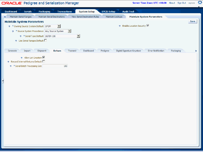

Before you can begin to use Oracle Pedigree and Serialization Manager (OPSM) you must first set up system parameters. System parameters define the owning source system default, source system precedence, serial type default, use serial ranges default setting for product details, and if you want to enable location security. They also define the default settings in OPSM for the different types of transactions used in OPSM, as well as, the Operation Dashboard URLs, the Pedigree BI Publisher server URL that is used to print Pedigrees, Digital Signature Keystore information, error notification setup information, and transaction statement information.
Use these procedures to view, set, and modify system parameters:
Note: The system parameters record is seeded upon installation. You cannot create or delete a system parameter record.
Navigate to the Maintain System Parameters page.
The Maintain System Parameters page appears displaying the current settings for the system parameters.
Select the different sub tabs (Generate, Import, Shipment, Return, Transmit, Dashboard, Pedigree, Digital Signature Keystore, Error Notification, Packaging, Serial Edit, Transaction Statement, and Receipt) to view the particular system parameters for that area.
Maintain System Parameters page - Generate sub tab
Select the settings for the following parameters:
| Owning Source System Default | Use this field to specify the default setting for the Owning Source System field on the Maintain Products page. This field value defaults into the Product Regulatory Information when a new product is created. This field value indicates the transactional system from which this product originated. Owning Source Systems are user defined using Lookup Type PAS_SOURCE_SYSTEM. For more information on creating a product, see Procedure: To Create Products. |
| Source System Precedence | Select the source system precedence. This field value indicates whether product or product detail information can be changed by any source system or only the owning source system. Source System Precedences are:
This is used by Product Synchronization process and the Define Product and Item Cross Reference page. This is not enforced in the Maintain Products page. |
| Serial Type Default | Use this field to specify the default setting for Serial Type when creating product details for a product. The value you select appears by default on the Create Product page (Serial Generation Details sub tab) when creating a product. SGTIN-96 appears by default in this field. Serial types are defined using extensible Lookup Type PAS_SERIAL_TYPE. OPSM provides several serial types. For more information on creating a product, see Procedure: To Create Products. |
| Use Serial Ranges Default check box | (Optional) If this check box is selected, then the Use Serial Ranges check box defaults as selected on the Create Product page (Serial Generation Details sub tab), when creating a product. The Use Serial Ranges check box is clear by default. For more information on creating a product, see Procedure: To Create Products. |
| Enable Location Security check box | (Optional) Select this check box if you want to enable location security in the environment. For more information on location security, see: |
Select the Generate sub tab.
| Allow Lot Creation check box | (Optional) Select this check box to enable a lot to be added to OPSM at the time of serial generation if the lot doesn't already exist. If no lot exists in OPSM, and this parameter is not set, the system issues an exception for the generate transaction. |
| Serial Commit Size | When performing a generate transaction, enter the number of serials that are processed before the system commits the serials to the database. |
Select the Import sub tab.
Maintain System Parameters page - Import sub tab
| Allow Lot Creation check box | (Optional) Select this check box to enable a lot to be added to OPSM at the time of serial import if the lot doesn't already exist. If no lot exists in OPSM, and this parameter is not set, the system issues an exception for the import transaction. |
| Serial Commit Size | When performing an import transaction, enter the number of serials that are processed before the system commits the serials to the database. |
Select the Shipment sub tab.
Maintain System Parameters page - Shipment sub tab
| Allow Lot Creation check box | (Optional) Select this check box to enable a lot to be added to OPSM at the time of shipment if the lot doesn't already exist. If no lot exists in OPSM, and this parameter is not set, the system issues an exception for the shipment transaction. |
| Record Internal Shipments Default check box | (Optional) If this check box is selected, then the Record Internal Shipment check box defaults as selected on the Create Product page, when creating a new product. If selected on the Create Product page, then the system records shipments to internal customers for that product. For more information on creating products, see Procedure: To Create Products. |
| Create Serials for Shipments Default check box | (Optional) If this check box is selected, then the Create Serials for Shipment check box defaults as selected on the Create Product page when creating a new product. If selected on the Create Product page, then the serials for the shipment are created for that product in OPSM at the time of shipment. If the serials already exist, the shipment transaction is set to an exception status. For more information on creating a new product, see Procedure: To Create Products. |
| Serial Batch Processing Size | When processing a shipment transaction, enter the number of serials that are processed by the system as a batch. Processing the serials in batches is a mechanism used to improve performance and scalability. 1000 appears by default for this field. |
| Digital Signature Method | (Optional) Select the method you would like to use when digitally signing Pedigree documents. Method values are:
| Allow Multiple Shipments check box | (Optional) Select this check box, if you want the system to allow multiple external shipments of serial numbers that are not included in a packaging hierarchy. Multiple external shipments of a packaging hierarchy are not allowed. The TransactionServiceAMService endpoint uses this parameter to determine whether the shipped state should be ignored or not when processing a shipment transaction. |
Select the Return sub tab.
Maintain System Parameters page - Return sub tab
| Allow Lot Creation check box | (Optional) Select this check box to enable a lot to be added to OPSM at time of return if the lot doesn't already exist. If no lot exists in OPSM, and this parameter is not set, the system issues an exception for the return transaction. |
| Record Internal Returns Default check box | (Optional) If this check box is selected, then the Record Internal Returns check box defaults as selected on the Create Product page when creating a new product. If selected on the Create Product page, then the system records product returns from internal customers for that product. For more information on creating products, see Procedure: To Create Products. |
| Serial Batch Processing Size | When processing a return transaction, enter the number of serials that are processed by the system as a batch. Processing the serials in batches is a mechanism used to improve performance and scalability. 1000 appears by default for this field. |
Select the Transmit sub tab.
Maintain System Parameters page - Transmit sub tab
Select the setting for the following parameter:
| Serial Batch Processing Size | When processing a transmit transaction, enter the number of serials that are processed by the system as a batch. Processing the serials in batches is a mechanism used to improve performance and scalability. |
Select the Dashboard sub tab.
Maintain System Parameters page - Dashboard sub tab
| Dashboard URL Name (1-5) | Enter the value that represents the task list name on the Operations Dashboard for the first through fifth custom URL's. |
| Dashboard URL (1-5) | Enter the value that represents the first through fifth custom URL's on the Operations Dashboard. Enter a fully qualified URL value (for example, http://www.domain.com). If no value is entered, the URL does not display on the Operations Dashboard. For more information, see Adding Custom URLs to the Operations Dashboard. |
Select the Pedigree sub tab.
Maintain System Parameters page - Pedigree sub tab
Enter the setting for the following parameter:
| BI Publisher URL | Enter the BI Publisher server URL that is used to print Pedigrees. Enter a fully qualified URL value (for example, http://hostname:port/xmlpserver). |
Select the Digital Signature Keystore sub tab.
Maintain System Parameters page - Digital Signature Keystore sub tab
Enter the settings for the following parameters:
| Keystore Type | Enter the type of keystore that is used for the digital signature of Pedigree documents (for example, JKS, PKCS12, and so on). |
| Keystore Provider | Enter the package provider of the keystore that is used for the digital signature of Pedigree documents. |
| Keystore Directory Location | Enter the location of the keystore file including the full path and file name. For example:
This file should be located on the same middle-tier as the WebLogic Server or should be accessible from it. |
For more information on digitally signing a Pedigree, see:
Select the Error Notification sub tab.
Maintain System Parameters page - Error Notification sub tab
| Enable E-mail Notification check box | Select this check box if you want the system to send notification e-mails if errors are detected on transactions or transactions that are locked as "In Progress" during the processing of the Transaction Service, Serial Service, and Product Service web services. If this check box is not selected, the system does not send any e-mail notifications of errors.
Note: The Oracle Scheduler must also be configured on the database for error notifications to occur. |
| Schedule Execution Interval (minutes) | Enter the amount of time in minutes after which the system checks for errors. 60 minutes appears by default. This field is required if you enable e-mail notifications. Note: Oracle recommends that you do not set this interval to a very small number as it can effect overhead. |
| From E-mail Address | (Optional) Enter the e-mail address that appears in the From line of the e-mail notification. If this information is not specified, the "To" e-mail address appears by default in the notification. |
| Primary E-mail Address | Enter the primary e-mail address where messages are sent if e-mail notifications are enabled. This e-mail address can be a distribution list. This field is required if you enable e-mail notifications. |
| E-mail Server Hostname | Enter the hostname of the e-mail server from which notifications are sent. This field is required if you enable e-mail notifications. |
| E-mail Server Port | Enter the port of the e-mail server from which notifications are sent. This field is required if you enable e-mail notifications. |
For more information on the error notification process, see Web Services E-Mail Notification.
Select the Packaging sub tab.
Maintain System Parameters page - Packaging sub tab
| Serial Batch Processing Size | When processing packaging transactions using the PackagingServiceAMService endpoint (web service operations), enter the number of serials that are processed by the system as a batch. Processing the serials in batches is a mechanism used to improve performance and scalability. 1000 appears by default for this field. |
Click the Save button.
Select the Serial Edit sub tab.
Maintain System Parameters page - Serial Edit sub tab
| Serial Batch Processing Size | When processing Reserve, Commission, Decommission, or Edit Serials transactions using the SerialsServiceAMService endpoint (web service operations), enter the number of serials that are processed by the system as a batch. Processing the serials in batches is a mechanism used to improve performance and scalability. All web service operations within the SerialsServiceAMService endpoint use this parameter. 1000 appears by default for this field. |
Select the Transaction Statement sub tab.
Maintain System Parameters page - Transaction Statement sub tab
| Transaction Statement | (Optional) Enter the transaction statement required by the Federal Drug Supply Chain Security Act (DSCSA) that will appear for each transaction. This transaction statement is delivered with every transaction produced by Oracle Pedigree and Serialization Manager. This field is a free form variable character text field and can be up to 400 characters in length. |

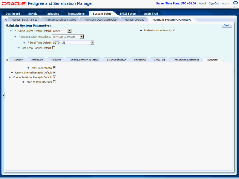

Select the Receipt sub tab.
Maintain System Parameters page - Receipt sub tab
| Allow Lot Creation check box | (Optional) Select this check box to enable a lot to be added to OPSM at the time of receipt if the lot doesn't already exist. If no lot exists in OPSM, and this parameter is not set, the system issues an exception for the receipt transaction. |
| Record Internal Receipts Default check box | (Optional) If this check box is selected, then the Record Internal Receipts check box defaults as selected on the Create Product page, when creating a new product. If selected on the Create Product page, then the system records receipts to internal customers for that product. For more information on creating products, see Procedure: To Create Products. |
| Create Serials for Receipts Default check box | (Optional) If this check box is selected, then the Create Serials for Receipts check box defaults as selected on the Create Product page when creating a new product. If selected on the Create Product page, then the serials for the receipts are created for that product in OPSM at the time of receipt. If the serials already exist, the receipt transaction is set to an exception status. For more information on creating a new product, see Procedure: To Create Products. |
| Allow Multiple Receipts check box | (Optional) Select this check box, if you want the system to allow multiple external receipts of serial numbers that are not included in a packaging hierarchy. Multiple external receipts of a packaging hierarchy are not allowed. The TransactionServiceAMService endpoint uses this parameter to determine whether the received state should be ignored or not when processing a receipt transaction. |
Modify any of the parameters settings.

Location setup provides the following:
Identification of the location:
Location Description
Location Type
Electronic Product Code (EPC) Company Prefix
Global Location Number (GLN)
Source System
Longitude and Latitude
External Reference Identifier
Digital signature required indicator
Licensing information:
State License Number
DEA Number
Licensing Agency
License State/Region
Deactivation of the Location:
Location Deactivation Date
If a location has been deactivated, the system does not generate new serials for the location. Previously generated serials for the location (when it was active) are transacted as normal.

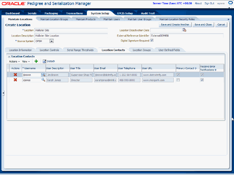

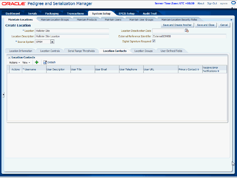

Location contacts information:
Username
Description
User Title
User Email
User Telephone
User URL
Primary contact check box
Receive error notifications check box
The Pedigree, Digital Signature, and Error Notification functionality in OPSM use location contacts:
Username on the location contact is the username that is entered when the user is prompted for digital signature validation (it is the user that is authorized to sign pedigrees).
Contact marked as the primary contact is the contact that displays and prints on the Pedigree document. Only one primary contact is allowed.
Contact marked as the one to receive error notifications is the contact that receives e-mail notifications if errors are detected on transactions, serial status updates, or transactions that are locked "In Progress" pertaining to this location during the Transaction Service and Serial Service web services processing.
E-mail notifications are only sent if you have enabled e-mail notification on the Maintain System Parameters page - Error Notification sub tab.

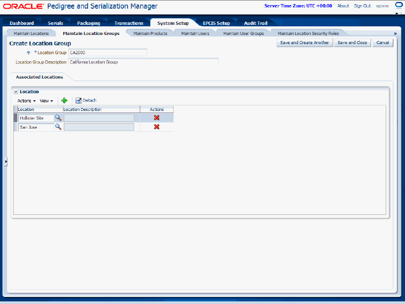

Location Group information:
Location Group
Location Group Description
Defines the location groups associated with the location. You can use location groups to define a single serial range for multiple locations.

Locations are also used in the definition of products, lots, serial ranges, and serial destinations in these ways:
Product Definition: Control attributes can be overridden specific to the Product and Location.

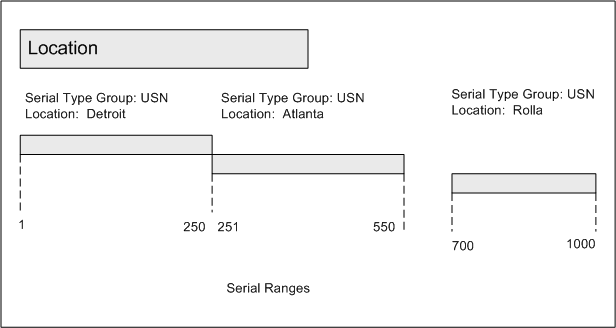

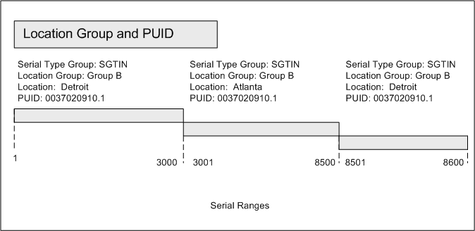

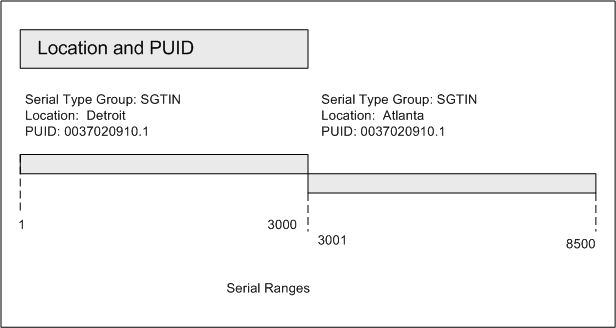

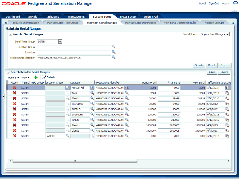

Serial Ranges: Ranges can be defined by two levels of granularity:
Serial Type Group and Location
Serial Type Group and Location Group
Serial Type Group, Location, and Product Unit Identifier
Serial Type Group, Location Group, and Product Unit Identifier
Serial Destinations: Serial destinations can be defined at three levels of granularity:
Transaction Type
Transaction Type and Location
Transaction Type, Location, and Product

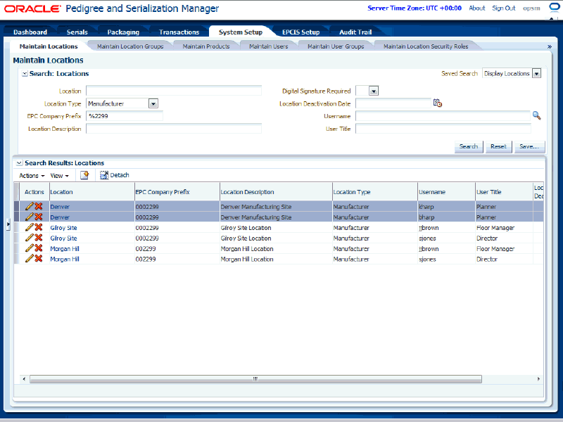

Use these procedures to search for, view, create, edit, deactivate, and delete locations:
Prerequisites
Navigate to the Maintain Locations page.
In the Search: Locations region, enter the search criteria for the locations using one or more of these fields:
| Location | (Optional) Enter the location. If you are using location security, you will only be able to view locations that you have at a minimum read access to in the Location Security Setup page. For more information on location security, see Location Security Overview. |
| Location Type | (Optional) Select the location type. Location Types are user-defined using Lookup Type PAS_LOCATION_TYPE. |
| EPC Company Prefix | (Optional) Enter the Electronic Product Code (EPC) company prefix. |
| Location Description | (Optional) Enter the description for the location. |
| Digital Signature Required | (Optional) Select whether you want to view locations where a digital signature is required for the Pedigrees. Values are:
| Location Deactivation Date | (Optional) Select the date the location was inactivated. |
| Username | (Optional) Select the location contacts username. |
| User Title | (Optional) Enter the location contacts user title. |
Otherwise, you can click the Search button without entering any search criteria and all available locations appear.
All of the locations that match the search criteria appear in the Search Results: Locations region in a table format.
If you are using location security, all of the locations that you have at a minimum read access to in the Location Security Setup page appear.

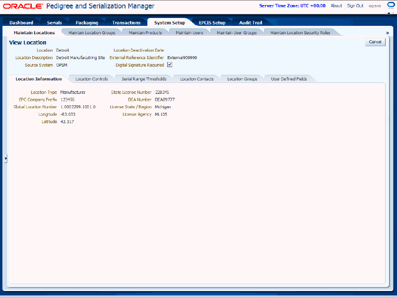

To View Location Detail Information
Enter search criteria for the locations you want to view the detail information for and click the Search button.
If you are using location security, you will only be able to view location detail information for locations that you have at a minimum read access in the Location Security Setup page.
All of the locations that match the search criteria appear in the Search Results: Locations table.
Click the Location link in the table that you want to view.
View Location page
The View Location page appears.
Select the different sub tabs (Location Information, Location Controls, Serial Range Thresholds, Location Contacts, Location Groups, and User Defined Fields) to view that particular type of information for the location
Click the Cancel button to return back to the Maintain Locations page.

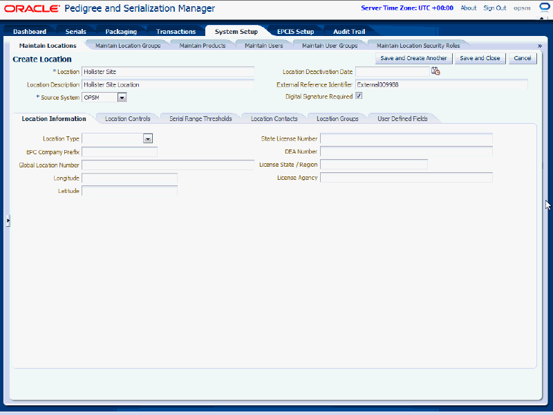

Select Create from the Actions menu or click the Create icon located at the top of the Search Results: Locations region.
If you are using location security, you can create a new location if you have functional security access to the Create Location page. After you create and save the new location, the system automatically creates the location security setup information for you and the new location with only read access in the Location Security Setup page.

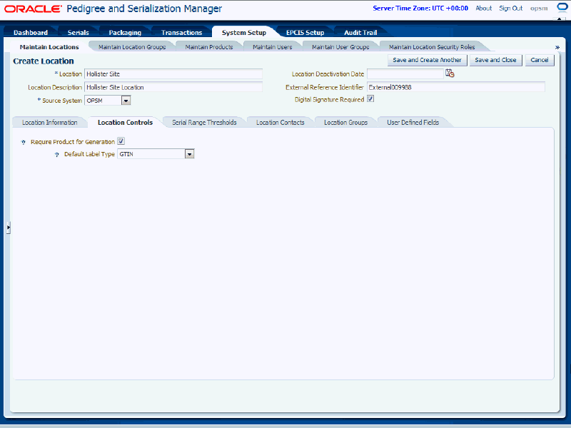

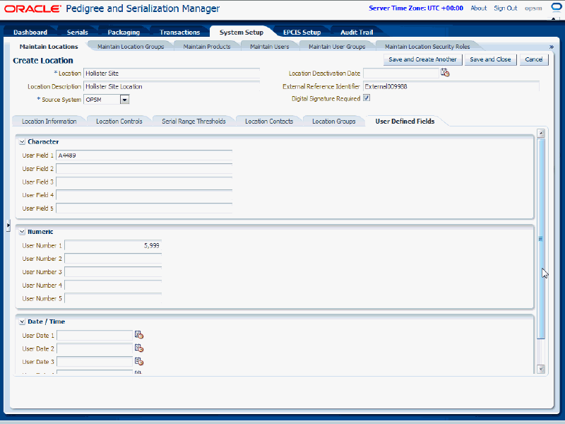

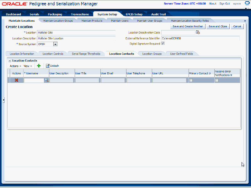

The Create Location page appears.
Enter the following information:
| Location | Enter the location. |
| Source System | Select the Source System that this location is associated with. Source systems are user-defined using PAS_SOURCE_SYSTEM Lookup Type. |
| Location Deactivation Date | (Optional) Enter the date the location will be deactivated. If a location has been deactivated, the system does not generate new serials for the location. Previously generated serials for the location (when it was active) are transacted as normal. |
| External Reference Identifier | (Optional) Enter an external reference identifier for the location. The external reference identifier is used to identify the entity from the external system that is identified as a location in OPSM. If using the page interface between Oracle E-Business Suite and OPSM, the External Reference Identifier is required. |
| Digital Signature Required check box | (Optional) Select this check box to indicate that a digital signature is required for Pedigrees at this location. |
Select the Location Information sub tab.
| Location Type | (Optional) Select the type of location. Use the type to clarify what this location is used for. Location Types are user-defined using Lookup Type PAS_LOCATION_TYPE. |
| EPC Company Prefix | (Optional) Enter the Electronic Product Code (EPC) Company Prefix for the location. The EPC Company Prefix must be between 6-12 characters in length and contain numeric values. The EPC Company Prefix is required for creation of SGTIN serial types in OPSM. |
| Global Location Number | (Optional) Enter either the Global Location Number (GLN) or the Serialized Global Location Number (SGLN) for the location. |
| Longitude | (Optional) Enter the longitude for the location. Entering longitude and latitude information displays the location on the Location Map located within the Operations Dashboard. |
| Latitude | (Optional) Enter the latitude for the location. Entering longitude and latitude information displays the location on the Location Map located within the Operations Dashboard. |
| State License Number | (Optional) Enter the State License Number for the location. |
| DEA Number | (Optional) Enter the Drug Enforcement Agency (DEA) Number for the location. |
| License State/Region | (Optional) Enter the state or region that the license is associated with. Pedigree uses this information. |
| License Agency | (Optional) Enter the agency that issued the license. Pedigree uses this information. |
Create Location page - Location Information sub tab
Select the Location Controls sub tab.
Select one of the serial creation check boxes for this location:
Select the Require Product for Generation check box if this location requires product identification on non-product specific serial types when serials are generated or imported for this location.
This check box appears selected by default.
Select the Non-Product Specific Serial Type the system uses when generating or importing serials for this location.
Note: The Non-Product Specific Serial Type field does not appear until you clear the Require Product for Generation check box.
Select the Default Label Type for the location.
The system uses this label type when a label type is not provided during the creation of label records for new transactions. The use of this default only occurs for labels that represent the shipping containers on the transactions. The system utilizes the location provided on the transaction to retrieve this Default Label Type value.
Create Location page - Location Controls sub tab
Select the Serial Range Thresholds sub tab.
| Serial Range Critical Threshold | (Optional) Enter the Serial Range Critical Threshold value for the location. Zero appears by default. This is the default critical threshold value for this location's serial ranges. This value appears by default on the serial range when a new range is created. If the remaining serials within a range are less than the Critical Threshold on the serial range, the range is included in the Critical count in the Serial Range Management component of the Operations Dashboard. For information on the Serial Range Management component, see Using the Serial Range Management Component. |
| Serial Range At Risk Threshold | (Optional) Enter the Serial Range At Risk Threshold value for the location. Zero appears by default. This is the default at risk threshold value for this location's serial ranges. This value appears by default on the serial range when a new serial range is created. If the remaining serials within a range are less than the At Risk Threshold and greater than or equal to the critical threshold value, the range is included in the At Risk count in the Serial Range Management component of the Operations Dashboard. For information on the Serial Range Management component, see Using the Serial Range Management Component. |
Create Location page - Serial Range Thresholds sub tab
Select the Location Contacts sub tab.
Create Location page - Location Contacts sub tab
Maintain Location Contacts:
To Create Location Contacts
Select Add Location Contact from the Actions menu or click the Add icon located at the top of the Location Contacts table.
A new row appears in the location contacts table.
| Username | Select the username for the location contact. For information on maintaining users, see Maintaining Users. |
| Description | The description for the user appears by default from the username selected. |
| User Title | The user title for the user appears by default from the username selected. |
| User Email | The user e-mail for the user appears by default from the username selected. |
| User Telephone | The user telephone for the user appears by default from the username selected. |
| User URL | The user URL for the user appears by default from the username selected. |
| Primary Contact check box | Select this check box next to the primary location contact for the location. At least one contact must be marked as the primary contact for the location. The contact marked as primary is the one that displays and prints on the Pedigree document. |
| Receive Error Notifications check box | Select this check box if the system sends notification e-mails for this location if errors are detected on transactions, serial status updates, or transactions that are locked "In Progress" during the Transaction Service and Serial Service web services processing. You can select more than one contact to receive error notifications. For more information on web service error notifications, see Web Service E-Mail Notifications. |
Repeat steps 1-2 until all of the location contacts are defined.
To Delete Location Contacts
Select the location contact in the table that you want to delete.
Select Delete Location Contact in the Actions menu or click the Delete icon in the Actions column of the contacts table.
The system displays a message asking if you are sure you want to delete the location contact.
The location contact is deleted from the system.
Select the Location Groups tab.
Create Location page - Location Groups sub tab
Maintain Location Groups:
To Add Location Groups to a Location
Select Add Location Group from the Actions menu or click the Add Location Group icon located at the top of the Location Groups table.
A new row appears in the location groups table.
Select a location group in the Location Group field.
If you are using location security, you will only be able to select location groups that you have update access to in the Location Security Setup page.
The Location Group Description field appears after you select a location group.
Note: Using the Location Groups tab, you are only creating an association between the location and location group.
Note: Location Groups are defined using the Create Location Group page. For more information on creating location groups, see Maintaining Location Groups.
Repeat steps 1-2 until all of the location groups are added.
To Delete Location Groups from a Location
Select the location group in the table that you want to delete.
Select Delete Location Group in the Actions menu or click the Delete Location Group icon in the Actions column of the location groups table.
The system displays a message asking if you are sure you want to delete this location group and location association.
The location group association to the location is deleted from the system. The location group itself is not deleted.

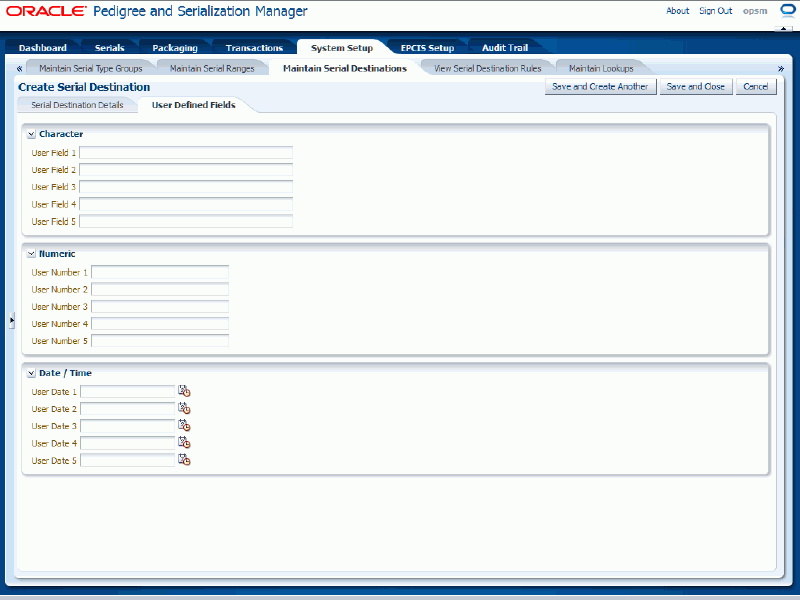

Select the User Defined Fields sub tab.
Enter user-defined data using any of the fields in the Character, Numeric, and Date/Time regions of the page.
Create Location page - User Defined Fields sub tab
Enter search criteria for the locations you want to edit and click the Search button.
If you are using location security, you will only be able to edit locations that you have update access to in the Location Security Setup page.
Select the location in the table that you want to edit.

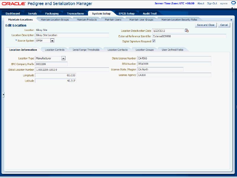

Select Edit in the Actions menu or click the Edit Location icon associated with the location in the Actions column of the results table.
Edit Location page
The Edit Location page appears displaying all of the existing information for the location.
Edit any of the location fields. You can edit any of the fields pertaining to the location.
Enter the date the location becomes inactive in the Location Deactivation Date field.
Note: The Deactivation Date must be in the future. It cannot be the current date.
Edit Location page
Click the Save and Close button to save the changes you made to the location information and to return back to the Maintain Locations page.

Use the Maintain Location Groups page in Oracle Pedigree and Serialization Manager (OPSM) to define and maintain location groups. You can associate one or more locations to a location group. Then when you go to define serial number ranges you can define them by location group versus by individual location. A location group enables you to define a single serial range for multiple locations.
Note: A location can belong to one or more location groups.
If you are using location security, the Maintain Location Groups and Edit Location Group pages are secured based on the location groups and privileges that you are authorized for in the Location Security Setup page. When searching for location groups, you will only be able to search for location groups you have at a minimum read access to in the Location Security Setup page. When editing location groups, you must have update access to the location groups in the Location Security Setup page. When deleting location groups, you must have delete access to the location groups in the Location Security Setup page.
When creating location groups you only need functional security access to the Create Location page. After you create and save the new location group, the system automatically creates the location security setup information for you and the new location group with only read access in the Location Security Setup page. In addition, when associating locations to a location group during the location group creation process, the locations that are available for selection are those that you have update access to in the Location Security Setup page.
Use these procedures to search for, create, edit, and delete location groups:
Prerequisites

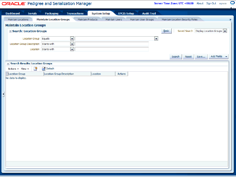

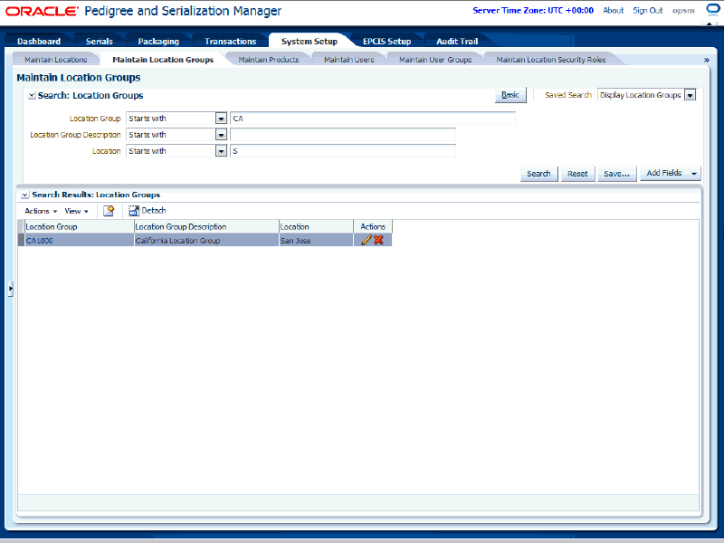

To Search for Location Groups (Basic Search)
Navigate to the Maintain Location Groups page.
Maintain Location Groups page (Basic Search)
The Maintain Location Groups page appears.
In the Search: Location Groups region, enter the search criteria for the location groups using one or more of these fields:
| Location Group | (Optional) Select the location group. If you are using location security, the location groups you can search for are restricted to those that you have at a minimum read access to in the Location Security Setup page. For more information on location security, see Location Security Overview. |
| Location Group Description | (Optional) Enter the description for the location group. |
| Location | (Optional) Enter a location associated with the location group. |
Otherwise, you can click the Search button without entering any search criteria and all available location groups appear.
All of the location groups that match the search criteria appear in the Search Results: Location Groups region in a table format.
If you are using location security, all of the location groups that you have at a minimum read access to in the Location Security Setup page appear.
Click the Advanced button to perform an advanced search.
To Search for Location Groups (Advanced Search)
Click the Advanced button.
Maintain Location Groups page (Advanced Search)
| Location Group | (Optional) Select the field operator and then select the location group. Operators are:
| Location Group Description | (Optional) Select the field operator and then enter the description for the location group. The field operators are the same as that for the Location Group field. |
| Location | (Optional) Select the field operator and then enter a location associated with the location group. The field operators are the same as that for the Location Group field. |
(Optional) To enter additional search criteria fields, click the Add Fields button and select the field you would like to add to the search criteria.
The selected field appears as a search criteria field.
Note: To remove the additional field, click the Remove icon next to the field. The field is removed from the search criteria.
(Optional) Enter search criteria for the additional fields.
Click the Basic button to have the page hide the advanced search criteria fields and re-display the basic search criteria fields.
Note: Clicking the Reset button clears the values in all of the criteria fields.

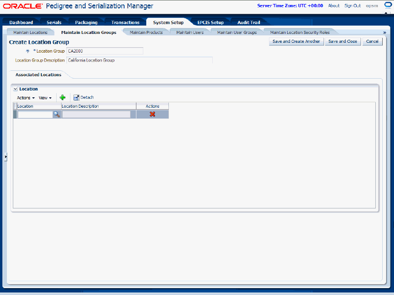

Select Create from the Actions menu or click the Create Location Group icon located at the top of the Search Results: Location Groups region.
If you are using location security, you can create a location group if you have functional security access to the Create Location Group page. After you create and save the new location group, the system automatically creates the location security setup information for you and the location group with only read access in the Location Security Setup page.
The Create Location Group page appears.
| Location Group | Enter the location group. |
Maintain locations for the location group:
To Associate Locations to a Location Group
Select Add from the Actions menu or click the Add Location Association icon located at the top of the Locations region.
A new row appears in the locations table.
| Location | Select a location. Deactivated locations do not appear in the list of available locations. If you are using location security, the locations you can select are restricted to those that you have update access to in the Location Security Setup page. |
| Location Description | The description of the location automatically displays after you select a location. |
Repeat steps 1 through 2 until you have added all of the locations you want to the location group.
Note: Only active locations are available for selection. Any location whose deactivation date is on or prior to the date when you are trying to associate the location do not display.
To Delete Locations from a Location Group
Select the location in the table that you want to delete.
Select Delete from the Actions menu or click the Delete Location Association icon in the Actions column of the locations table.
The location is deleted from the location group.
Click the Save and Close button to save this location group and return back to the Maintain Location Groups page.
Click Save and Create Another button to save this location group and to stay on this page so you can create another location group. The system displays a message that the location group was saved successfully and it clears all of the values in the fields.

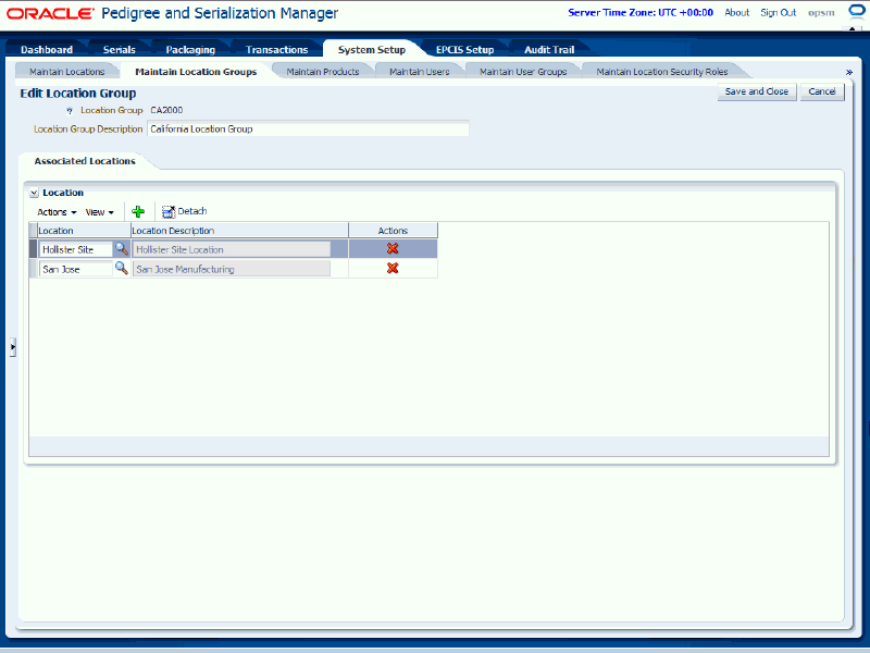

The Edit Location Group page appears displaying all of the existing information for the location group.

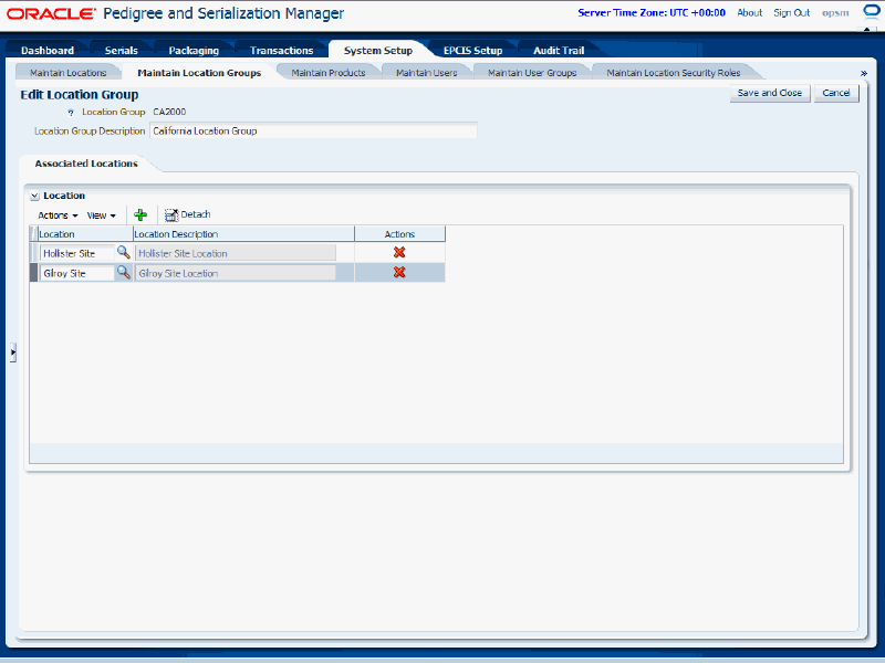

(Optional) Edit the Location field if necessary.
Edit Location Group page (Location field modified)
(Optional) Add additional locations or delete locations if necessary.
Click the Save and Close button to save the changes you made to the location group and to return back to the Maintain Location Groups page.
Enter search criteria for the location groups you want to delete and click the Search button.
If you are using location security, the location groups you can delete are restricted to those that you have delete access to in the Location Security Setup page.
All of the location groups that match the search criteria appear in the Search Results: Location Groups table.
Select Delete in the Actions menu or click the Delete Location Group icon in the Actions column of the results table.
The system displays a message asking if you are sure you want to delete the location group and all of its associated locations.
Note: You cannot delete a location group if it has a serial range associated to it.
The location group and all of its associated locations are deleted from the system.

Select Create from the Actions menu or click the Create icon located at the top of the Search Results: Products region.
If you are using location security, you can create a new product if you have functional access to the Create Product page but you can only associate the product details to a location group or location that you have update access to in the Location Security Setup page.
Create Product page
The Create Product page appears.
| Product Code | Enter the product code. The product code length must match that for the product code type selected. For example, a product code must be 14 digits for a GTIN product code type. |
| Product Code Type | Select the product code type. Product code types are defined using extensible Lookup Type PAS_PRODUCT_CODE_TYPE. OPSM provides several product code types. |
| Product Code Variant | (Optional) Enter the product code variant. NOVARIANT appears by default.
Note: GTIN and NDC product codes can be reused after a specified number of years. The product code variant is used to differentiate between multiple products using the same product code. |
| Product Name | (Optional) Enter the name of the product. |
Select the Regulatory Information sub tab.
Use this sub tab to enter information that is required for regulatory requirements.
| Owning Source System | Select the transactional system that has ownership of the product definition. The System Parameters value for the Owning System Source Default field appears by default. For information on the system parameters, see Maintaining System Parameters. |
| Serialization Control | Select whether serials for this product are externally generated or generated by the OPSM system. Values are:
OPSM Serialized appears by default. If Serial Control is set to OPSM Serialized, serials can be generated by OPSM for this product. When set to Externally Generated, serials can be created in OPSM by either importing the serials or uploading the serials at time of shipment or receipt. The value for Serial Control can be overridden by product and location. |
| Manufacturer | (Optional) Enter the name of the Manufacturer for this product. Manufacturer is required if the Pedigree Required check box is selected. |
| Product Category | (Optional) Select a product category code. For example, painkillers, anti-depressants, anti-anxiety, and so on. Product categories are user defined using Lookup Type PAS_PRODUCT_CATEGORY. |
| Dosage Form | (Optional) Select the form of dosage for the product. For example, tablet, liquid, or capsule. Dosage Form is required if the Pedigree Required check box is selected. Dosage forms are user defined using Lookup Type PAS_DOSAGE_FORM. |
| Container Size | (Optional) Enter the number of units contained in a package of the product. For example, 60 or 100. Container Size is required if the Pedigree Required check box is selected. |
| Container Type | (Optional) Select the type of container for the product. Container types are user defined using Lookup Type PAS_CONTAINER_TYPE. |
| Strength | (Optional) Enter the strength or potency for the product including the unit of measure. For example, 60mg or 25ml. Strength is required if the Pedigree Required check box is selected. |
| Controlled Substance check box | (Optional) Select this check box if this product is a controlled substance. This field is used only for informational purposes. |
| Record Internal Shipments check box | This check box setting appears by default from the Maintain System Parameters page. Select this check box if you want the system to record shipments from internal customers for this product. |
| Record Internal Returns check box | This check box setting appears by default from the Maintain System Parameters page. Select this check box if you want the system to record returns from internal customers for this product. |
| Create Serials for Shipments check box | This check box setting appears by default from the Maintain System Parameters page. Select this check box if the system creates serials in the Oracle Pedigree and Serialization Manager system at the time of shipment. |
| Pedigree Required check box | (Optional) Select this check box if you require a Pedigree to be created upon Shipment of the product. If selected, the system automatically creates a Pedigree for the Shipment transaction. Product Name, Strength, Manufacturer, Dosage Form, and Container Size are required when Pedigree Required is selected. |
| Record Internal Receipts check box | This check box setting appears by default from the Maintain System Parameters page. Select this check box if you want the system to record receipts from internal customers for this product. |
| Create Serials for Receipts check box | This check box setting appears by default from the Maintain System Parameters page. Select this check box if the system creates serials in the Oracle Pedigree and Serialization Manager system at the time of receipt. |
Create Product page - Regulatory Information sub tab

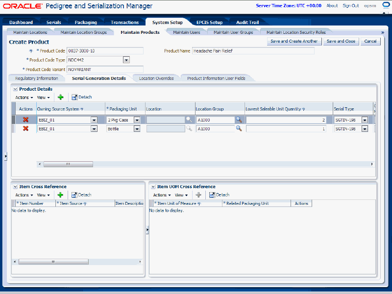

Select the Serial Generation Details sub tab.
The system uses the information specified for this sub tab to generate the serials for the product. Packaging information is included so that the system has the ability to generate serials for multiple levels of packaging based on a request for serials at the lowest saleable unit.
Create Product page - Serial Generation Details sub tab
To add product details, select Add Product Detail from the Actions menu or click the Add Product Detail (“+” plus sign) icon located at the top of the Product Details region.
Note: At least one product detail row must be created for each product code that you define.
Note: You can only create one product detail row for a product code associated with a GTIN product code type.
A new row appears in the Product Details region where you can add the information.
| Owning Source System | Select the transactional system that has ownership of the product detail information. The System Parameters value for the Owning System Source Default field appears by default. For information on the system parameters, see Maintaining System Parameters. |
| Packaging Unit | Select the packaging unit for this product. Packaging units are user defined using Lookup Type PAS_PACKAGE_UNIT. Note: If you are entering packaging units for the product, at least one of the packaging units must represent the products lowest level of detail where lowest saleable unit quantity equal 0 (zero). |
| Location | (Optional) Select the location for the product. You can select either a location or a location group for each product detail row. If you select a location, the Location Group field becomes unavailable for entry. If you are using location security, the locations you can select are restricted to those that you have update access to in the Location Security Setup page. For more information on location security, see Location Security Overview. |
| Location Group | (Optional) Select the location group for the product. You can select either a location or a location group for each product detail row. If you select a location group, the Location field becomes unavailable for entry. If you are using location security, the location groups you can select are restricted to those that you have update access to n the Location Security Setup page. For more information on location security, see Location Security Overview. |
| Lowest Saleable Unit Quantity | (Optional) Enter the total number of the lowest saleable units contained in this packaging unit. Zero appears by default. You cannot enter a negative value. For example, a 10 package box (packaging unit) holds 10 saleable units, a 5 package case (packaging unit) holds 50 saleable units, and so on. The 5 package case contains 5 10 package boxes, which accounts for the 50 saleable units. A syringe (packaging unit) is the lowest saleable unit, it does not have any saleable units packed within it so it's represented by a zero in this field. |
| Serial Type | Select the type of serial that is generated. The System Parameters value for the Serial Type Default field appears by default. For information on the system parameters, see Maintaining System Parameters. |
| Custom Serial Method | (Optional) Select the custom serial method to be used when generating the serial numbers for the product. This field becomes available if you select a custom serial type in the Serial Type field. OPSM delivers predefined serial types in the Lookup Type PAS_SERIAL_TYPES but you can add additional custom serial types to this lookup type. |
| EPC Company Prefix | (Optional) Enter the Electronic Product Code (EPC) company prefix assigned to the product. When serials are generated in OPSM, the EPC company prefix within the SGTIN-96 AND SGTIN-198 serials is verified against this EPC company prefix to ensure that they are correct. |
| NDC (National Drug Code) Number | (Optional) Enter the NDC number for the product. The NDC number cannot be more than 20 characters. |
| GTIN | (Optional) Enter the Global Trade Identification Number (GTIN) assigned to the product. GTIN is required for SGTIN serial types or serial types that are associated to a serial type group where the Product Unit Identifier Formula is set to GTIN. For products associated with a GTIN product code type, the system populates the GTIN with the value in the Product Code field and it cannot be changed. |
| EPC Filter Value | (Optional) Enter the EPC (Electronic Product Code) filter value that represents the packaging level for the product. EPC Filter Value is required for SGTIN serial types. |
| Product Unit Identifier | Displays the product unit identifier associated with the serial type group. |
| Overage | (Optional) Enter how many additional serials can be generated above the quantity/percent requested. Zero appears by default. You cannot enter a negative value. The Overage Type determines whether you enter a quantity or a percentage. |
| Overage Type | (Optional) Select the type. Types are:
| Use Serial Ranges check box | (Optional) Select this check box if you want the system to use a specific range when generating serials. The System Parameters value for the Use Serial Ranges Default check box field appears by default. For information on the system parameters, see Maintaining System Parameters. |
| Label Print Format | (Optional) Select the print label format for the product and packaging unit. |
| User Field 1 through 15 | (Optional) Enter user-defined data using any of these fields. |
| User Number 1 through 5 | (Optional) Enter user-defined data using any of these fields. |
| User Date 1 through 5 | (Optional) Enter user-defined data using any of these fields. |
To add item cross-references, select Add Product Item from the Actions menu or click the Add Product Item (“+” plus sign) icon located at the top of the Item Cross Reference region.
Item cross-reference information is where you can specify the mapping from one or more transactional system items to a product.
A new row appears in the Item Cross Reference region where you can add the information.
| Item Number | Enter the item number. |
| Item Source | Select the item source (transactional system) from which this item originates. |
| Item Description | (Optional) Enter the description for the item. |
Note: The item cross-reference rows are related to the item UOM cross-references rows. When you select an item in the Item Cross Reference region the associated row appears in the Item UOM Cross Reference region if a cross-reference UOM has been entered. Otherwise, you can create the cross-reference UOM row for the item cross-reference.
Important: You must enter an Item UOM cross-reference record if you plan to reference the product using the transaction system item number when searching for serials or transactions, generating serials, or recording transactions in OPSM.

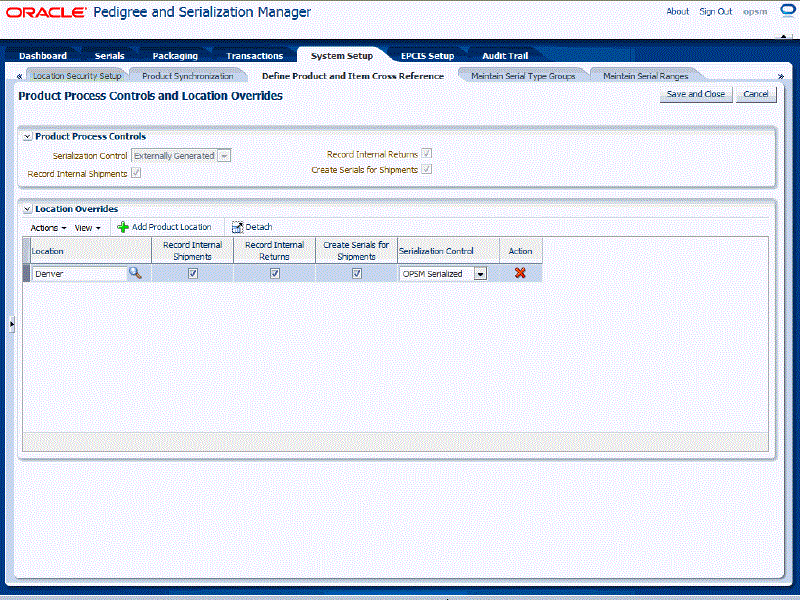

Select the Location Overrides sub tab.
Use this tab to provide override information for locations. The override parameters at the location level override those specified at the product level.
Create Product page - Location Overrides sub tab
To add location overrides, select Add Product Location from the Actions menu or click the Add Product Location (“+” plus sign) icon located at the top of the Location Overrides region.
A new row appears in the Location Overrides region where you can add the information.
| Location | Select the location. If you are using location security, the locations you can select are restricted to those that you have update access to in the Location Security Setup page. For more information on location security, see Location Security Overview. |
| Record Internal Shipments check box | (Optional) Select this check box if you want the system to record shipments to internal customers for this product at this location. |
| Record Internal Returns check box | (Optional) Select this check box if you want the system to record returns to internal customers for this product at this location. |
| Record Internal Receipts check box | (Optional) Select this check box if you want the system to record receipts to internal customers for this product at this location. |
| Create Serials for Shipments check box | (Optional) Select this check box if the system creates serials in the Oracle Pedigree and Serialization Manager system at the time of shipment at this location. If serials are not sent in with the Shipment transaction, the system issues an exception. |
| Create Serials for Receipts check box | (Optional) Select this check box if the system creates serials in the Oracle Pedigree and Serialization Manager system at the time of receipt at this location. If serials are not sent in with the Receipts transaction, the system issues an exception. |
| Serialization Control | (Optional) Select if the serials for this location are externally generated or OPSM serialized. |
