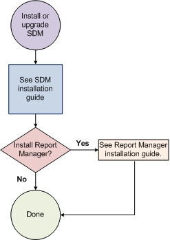

  3. Read and understand this guide to install SDM for the first time or when you upgrade SDM from a previous version. You must do the SDM installation before you can install Oracle Communications Report Manager. Refer to the flow diagram below for more information:
    Figure 1-1 Installing or upgrading SDM with Report Manager
    The figure presents a flow diagram for installing or upgrading SDM with Report Manager where you must first see the SDM install guide to install SDM first, then decide whether to install Report Manager. If yes, then you must see the Report Manager Installation guide.
