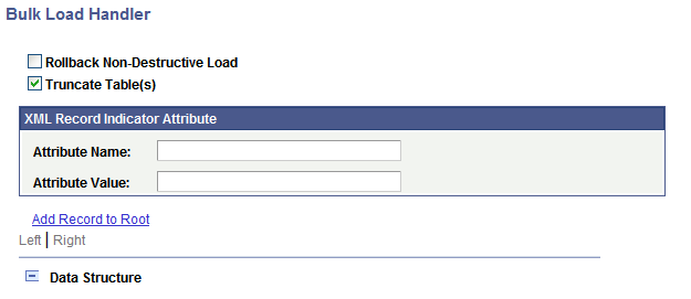

The Bulk Load Handler page (IB_SERVICEHDL5_SEC) features a Rollback Non-Destructive Load option that you can set to enable transaction rollback.
Image: Bulk Load Handler page
This example illlustrates the Bulk Load Handler page. The example shows the page when the service operation contains a nonrowset-based message.
The previous example shows the Bulk Load Handler page that displays when the service operation contains a nonrowset-based message.
If the service operation contains a rowset-based message, the page does not display the XML attribute fields or the data tree structure controls.
This example illlustrates the Bulk Load Handler page. The example shows the page when the service operation contains a rowset-based message.

Use the XML Record Indicator Attribute check box on the Bulk Load Handler page to distinguish and specify records and fields on incoming XML content of nonrowset-based messages.
This example illustrates a partial view of the Bulk Load Handler page. The example shows the XML Record Indicator Attribute section of the page that you use to specify an attribute name and value for nonrowset-based messages.
When you specify an attribute name and value, the system recognizes content with that name and value as a record. Content placed in the message after that attribute name/value pair is considered child data.
When the service operation contains a nonrowset-based message, you must specify an attribute name and attribute value. If you do not supply values for these fields, an error message appears. These fields are optional when the service operation contains a rowset-based message.
