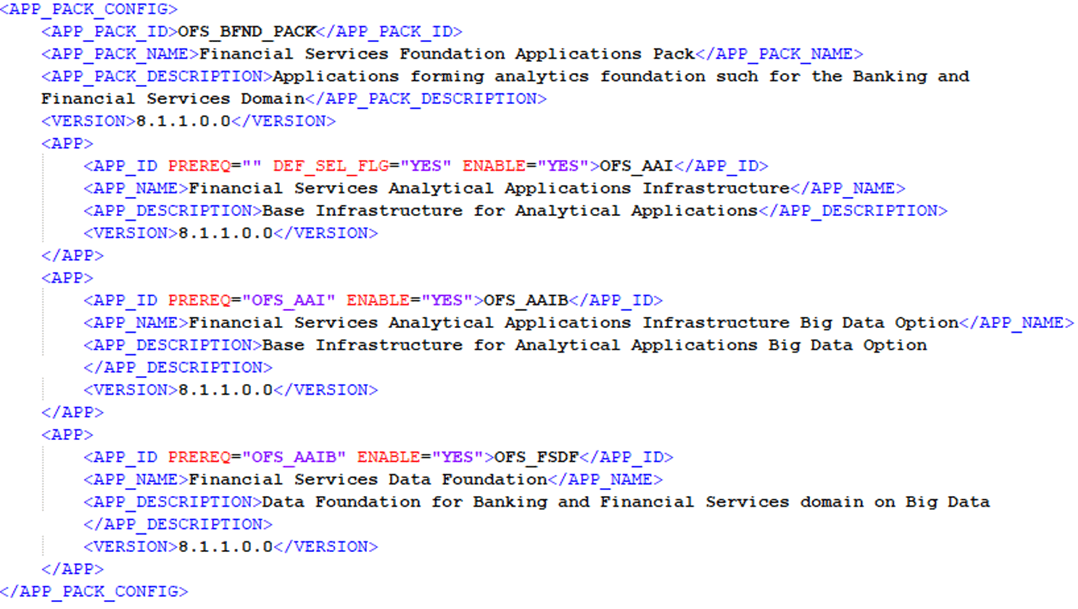

Update the OFS_BFND_PACK.xml file to enable the existing installed Application Packs.
To configure the OFS_BFND_PACK.xml file, follow these steps:
1. Navigate to the OFS_BFND_PACK/conf/ directory.
2. Rename the file OFS_BFND_PACK.xml to OFS_BFND_PACK.xml.template.
3. Open the OFS_BFND_PACK.xml file in a text editor.
4. Update the OFS_BFND_PACK.xml file in the text editor as mentioned in the following table only for the specified parameter.
NOTE:
For the Big Data mode of installation, enable the option as YES for the APP_ID parameter with the value OFS_AAIB as illustrated in the sample.
Figure 42: Sample OFS_BFND_PACK.xml File

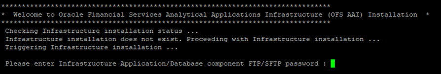

4. Enter the OFSAA Processing Tier FTP or SFTP password value and proceed, when prompted in the command prompt.
Figure 43: OFSAA Processing Tier FTP or SFTP Password Prompt
NOTE:
Enter the password to access the Product Staging or Metadata repository directory FTPSHARE in the application server.

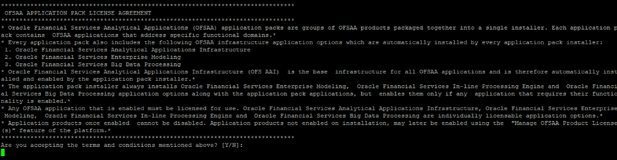

5. The process displays the OFSAA License. Enter Y and proceed.

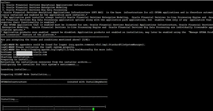

6. The installer installs the OFSAAAI application.
Figure 45: OFS AAAI Silent Mode Installation

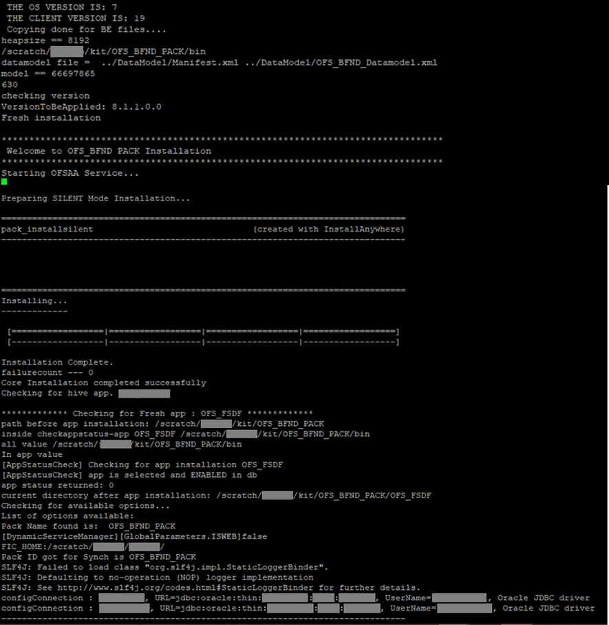

7. After OFSAAAI is installed, the OFSDF Application Pack installation begins.
Figure 46: OFSDF Application Pack Installation

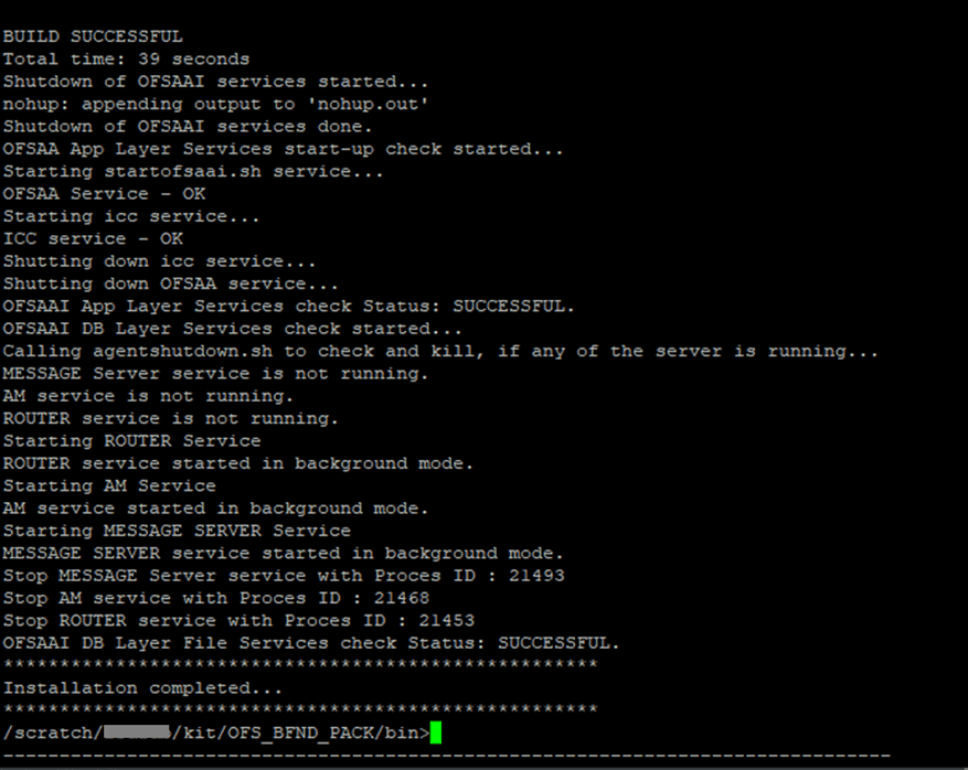

8. The following message is displayed in the console:
Installation completed?
9. The OFSAA Infrastructure installation performs a post-install health check automatically on the successful installation of the product.

Update the OFS_BFND_PACK.xml file to enable only the existing installed Application Packs.
4. Update the OFS_BFND_PACK.xml file as mentioned in the following table only for the specified parameter.
NOTE:
Figure 48: Sample OFS_BFND_PACK.xml File

4. Enter the OFSAA Processing Tier FTP/SFTP password value and proceed, when prompted in the command prompt.
Figure 49: OFSAA Processing Tier FTP/SFTP Password Prompt
NOTE:
Figure 51: OFS AAAI Silent Mode Installation
Figure 52: OFSDF Application Pack Installation
