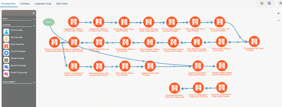

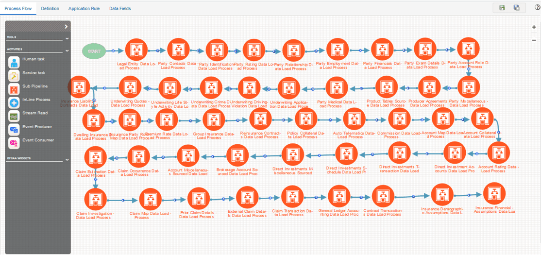

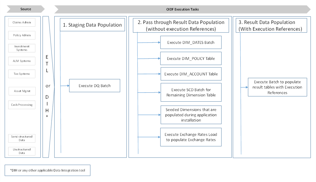

This representative data flow diagram of the Data Foundation application illustrates its data flow stages, input and output types, output usage, and the processes that populate results.
Figure 8: Representative data flow diagram of the Data Foundation application
Title: Description of the representative data flow diagram of the Data Foundation application follows - Description: This illustration shows the representative data flow diagram of the Data Foundation application. The explanation follows this illustration.
The data flow process can be categorized into two main categories. They are:
1.     Populating Stage Tables
In this process, data is populated into the Data Foundation Stage master tables and Stage tables using these sub-processes:
a.     Run Custom ETL or DIH.
b.     Execute Data Quality batches.
2.     For more information about loading Stage tables, see the section Loading OFSAA Staging Tables.
3.     Populating Result Tables
4.     In this process, data is populated in Dimension and Result tables using Stage tables. The sequence of sub-processes is:
a.     Dimension Loading Process:
i.       Populate the DIM_DATES table.
ii.     Seeded Dimensions that are populated during the installation process.
iii.   Populate DIM_ACCOUNT and DIM_POLICY tables.
iv.   Execute other SCD batches to populate corresponding Dimensions.
v.     Load key Dimensions using AMHM.
b.     Loading data into the Result tables using the T2T batch execution process.
These Result tables are used by other Analytical Applications to create reports. Some of the applications are listed here:
·        IFRS17
·        Solvency II
·        Customer Insight

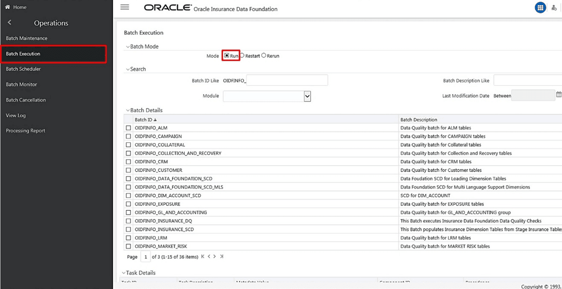

1.     Navigate to the Batch Execution page.
From OFSAA Home, select Oracle Insurance Data Foundation, select Operations, and then select Batch Execution.
2.     Select the Batch ID.
The Batch Execution page is displayed.
Figure 9: Navigate to the Batch Execution page
Title: Description of the navigation to the Batch Execution page follows - Description: This illustration shows the navigation to the Batch Execution page. The Batch Execution page consists of Batch Mode, Search, Batch Details, and Task Details sections. Perform the actions mentioned in the steps that follow this illustration.
a.     In the Batch Mode section, select the Run option.
b.     In the Batch Details section, search and select the required Batch ID.
Figure 10: Select the Batch ID
Title: Description of selecting the Batch ID follows - Description: This illustration shows selecting the Batch ID. There are different Batch IDs for different types of Dimension tables. See the steps that follow this illustration for more information.
    For the DIM_ACCOUNT table, select the Batch ID <INFODOM>_DIM_ACCOUNT_SCD.
    For the DIM_POLICY table, select the Batch ID <INFODOM>_INSURANCE_SCD and include only DIM_POLICY related Stage table tasks.
    For all other Dimension tables, select the Batch ID <INFODOM>_DATA_FOUNDATION_SCD.
The Task Details section lists the tasks corresponding to the selected Batch ID. The list consists of all the Stage tables that are mapped to Dimension tables.

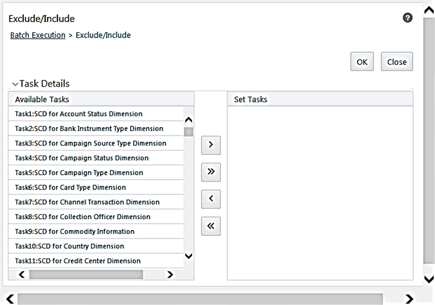

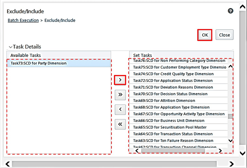

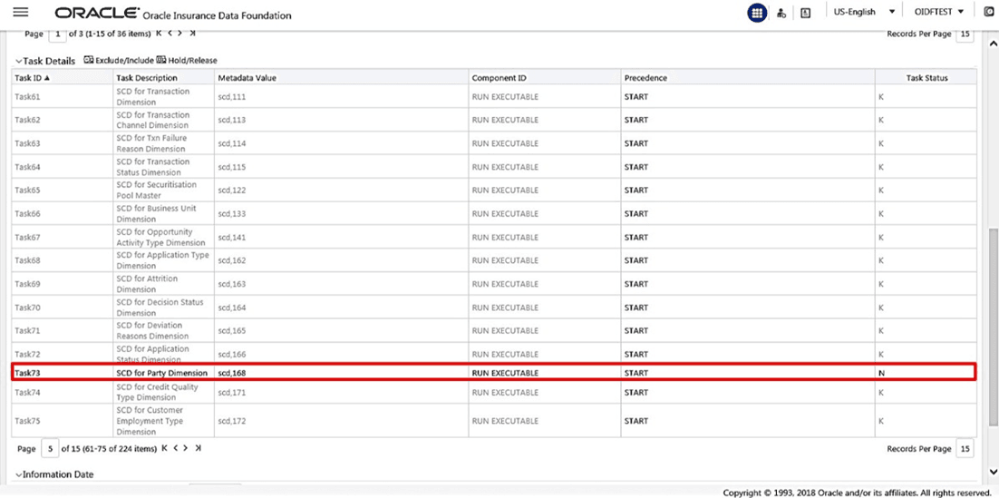

3.     Exclude or include tasks from or into the SCD batch.
Figure 11: Select the task Exclude/Include option
Title: Description of excluding or including tasks from or into the SCD batch follows - Description: This illustration shows how to exclude or include tasks from or into the SCD batch. For the selected Batch ID, corresponding Task details are listed. Select the Exclude/Include icon to exclude or include a task from or into the required SCD batch.
a.     Make a note of the Metadata Value (SCD map reference number) and the Task ID for the required Dimension table.
NOTE
To populate the Dimension table from its corresponding Stage Master table, use SCD packaged in OIDF with the respective Map Reference Number.
b.     To exclude or include a task from or into the required SCD batch, in the Task Details section, click the Exclude/Include icon.
c.     The Task Mapping – Exclude/Include page is displayed.
Figure 12: The task Exclude/Include page
Title: Description of the task Exclude/Include page follows - Description: This illustration shows the task Exclude/Include page for the selected Batch ID. This page consists of Available Tasks and Set Tasks sections, move to right and move to left arrows, and OK and Close buttons.
d.     Include or exclude the tasks.
In the Task Details section, select the tasks that must be excluded from the batch execution procedure, and click > to move those tasks from the Available Tasks section to the Set Tasks section. The Available Tasks list consists of tasks that are available for the execution of Dimension table.
Figure 13: Exclude the Tasks
Title: Description of excluding the tasks follows - Description: This illustration shows how to exclude tasks for the selected Batch ID from an available list of tasks. In the Available Tasks section, select the tasks that needs to be excluded from the SCD batch and move them to the Set Tasks section. Click OK to save the selection.
e.     Confirm the task inclusion or exclusion.
Figure 14: The selected task is listed in the Task Details section
Title: Description of the selected task list in the Task Details section follows - Description: This illustration shows the selected task list in the Task Details section. The Task Status of the included (highlighted) task is N, and this task is executed during the batch execution. The excluded task(s) are displayed in the Grey color with Task Status as K.
i.       To save the changes, click OK. The following warning message is displayed: If you exclude a task, it will be skipped when executing the batch but, the precedence will not be altered. Do you want to exclude the selected task(s)?
ii.     To proceed, click OK. The Task Details list consists only of the tasks present in the Available Tasks list. For example, in the following screenshot, the included (highlighted) task, of which the Task Status is N, and this task is executed during the batch execution. The excluded task(s) are displayed in the Grey color with Task Status as K.

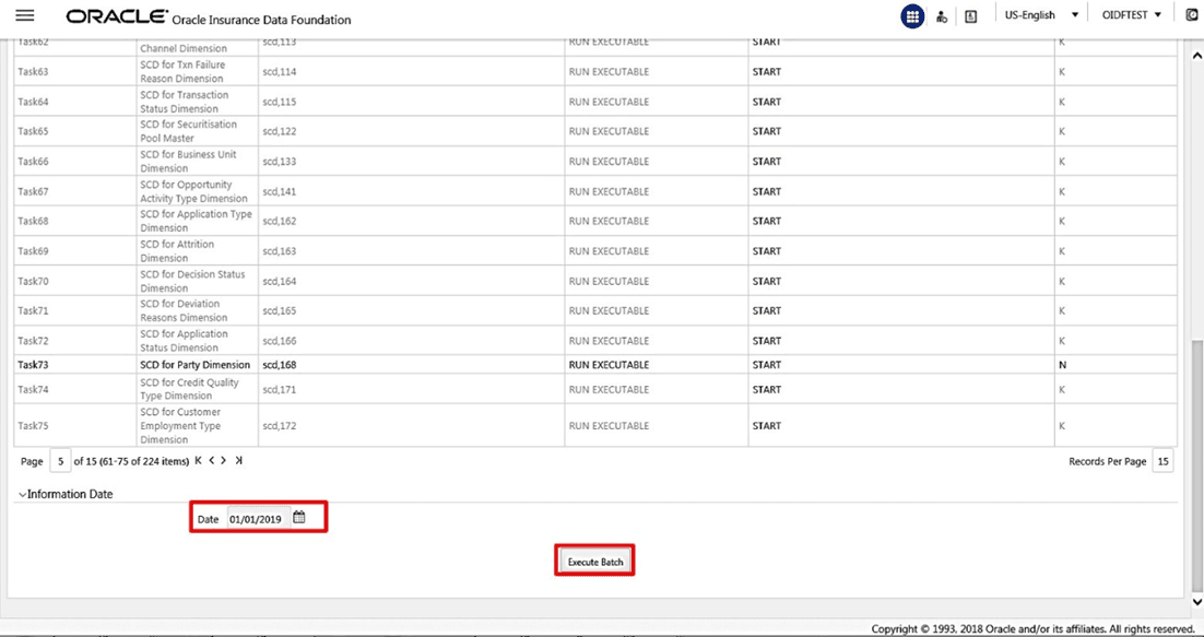

4.     Select the FIC_MIS date.
In the Information Date section, click the calendar icon and select the required date. This date is the FIC_MIS date populated in the DIM_DATES table.
Figure 15: Select the FIC_MIS date and click Execute Batch
Title: Description of selecting the FIC_MIS date and executing the SCD Batch illustration follows - Description: This illustration shows selecting the FIC_MIS date and executing the SCD Batch.
5.     Execute the SCD batch.
Click Execute Batch to run the selected SCD batch with one of the following selected task:
§       For the DIM_ACCOUNT table, execute the Batch ID <INFODOM>_DIM_ACCOUNT_SCD.
§       For the DIM_POLICY table, execute the Batch ID <INFODOM>_INSURANCE_SCD and include only DIM_POLICY related Stage table tasks.
§       For all other Dimension tables, execute the Batch ID <INFODOM>_DATA_FOUNDATION_SCD.
6.     Confirm the SCD batch execution.
a.     The following pop-up message is displayed: Do you want to execute the batch for MIS Date <MIS_Date>. To execute the batch, click OK.
b.     The following acknowledgment message is displayed: Batch triggered successfully. The Batch Run Identification is: <Batch Run ID>. Click OK to continue. The SCD batch is executed. As a result, data is populated in the target Dimension table.

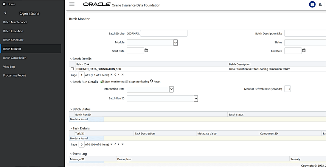

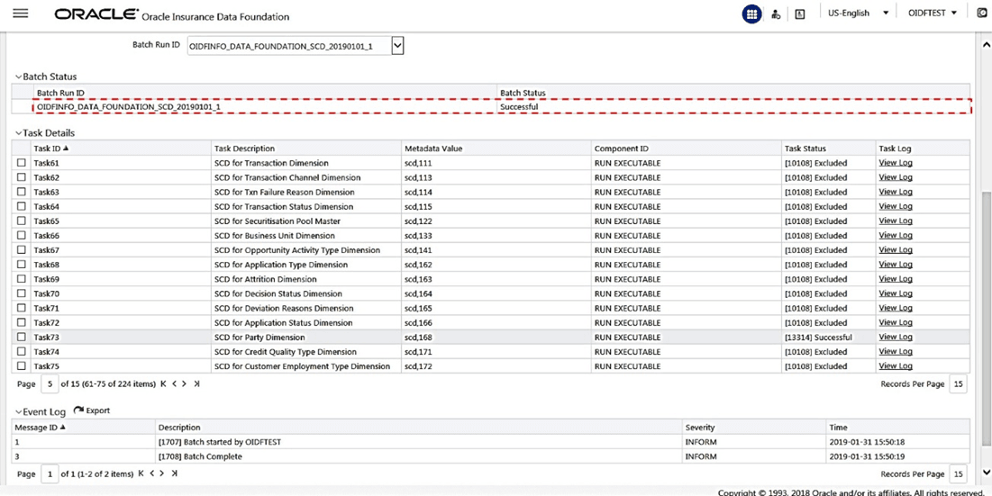

Check the Execution Status of the SCD Batch

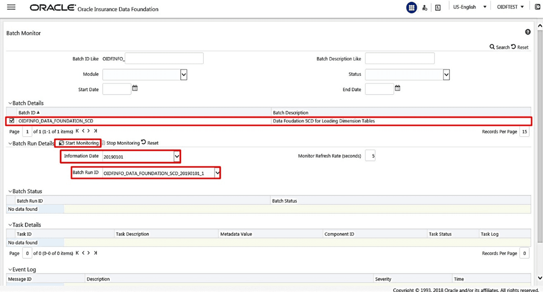

To check the execution status of the SCD batch, follow these steps:
1.     Navigate to the Batch Monitor page.
From OFSAA Home, select Oracle Insurance Data Foundation, select Operations, and then select Batch Monitor.
Figure 16: Navigate to the Batch Monitor page
Title: Description of the navigation to the Batch Monitor page follows - Description: This illustration shows the navigation to the Batch Monitor page. This page consists of the Batch Details, Batch Status, Task Details, and Event Log sections. Perform the actions mentioned in the steps that follow this illustration.
2.     Select the Batch ID <INFODOM>_DATA_FOUNDATION_SCD.
The Batch Monitor page appears on the right-hand side. In the Batch Details section, select the Batch ID that was executed during the Execute the SCD Batch step, that is, select the <INFODOM>_DATA_FOUNDATION_SCD Batch ID.
3.     Select the FIC_MIS Date and Batch Run ID.
Figure 17: Select the Batch ID, FIC_MIS Date, and Batch Run ID
Title: Description of selecting the Batch ID, FIC_MIS Date, and Batch Run ID follows - Description: This illustration shows selecting the Batch ID, FIC_MIS Date, and Batch Run ID details. Then select the Start Monitoring icon to begin the Batch monitoring process.
a.     In the Batch, Run Details section, click the Information Date box and select the required FIC_MIS Date. The SCD batch was executed on this date.
b.     Then click the Batch Run ID box and select the required value.
c.     Click the Start Monitoring icon.

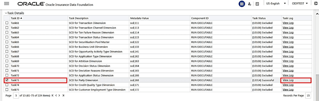

4.     Check the Batch status.
Figure 18: Batch execution status
Title: Description of the Batch execution status follows - Description: This illustration shows the Batch execution status in the form of a message. More information is provided in the paragraph that follows this illustration.
In the Batch Monitor page, the Batch Status, Task Details, and Event Log sections are displayed in addition to the existing details.
The following are the types of Status messages:
§       Not Started
§       Ongoing
§       Failure
§       Successful
When a Batch Status is indicated as Successful, valid data is populated in the Dimension table.

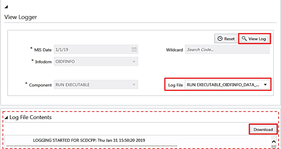

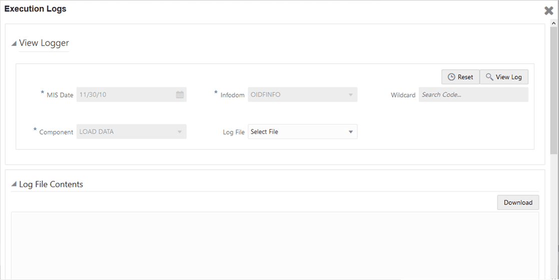

Verify Log Files and Check Error Messages
Use one of these two methods to access the SCD batch execution log files to view the complete log generated during the SCD batch execution:
·        View and download the log files from the application UI.

View and Download the Log Files from the Application UI
To view and download the log files from the application UI, follow these steps:
1.     In the Task Details section, select the task that was executed and click View Log.
Figure 19: Select View Log for the Task that was included in the Batch execution
Title: Description of selecting View Log for the Task that was included in the Batch execution follows - Description: This illustration shows selecting View Log for the Task that was included in the Batch execution.
2.     Select and view the log file.
The View Logger page is displayed.
Figure 20: Verify the log file content in the View Logger page
Title: Description of verifying the log file content in the View Logger page follows - Description: This illustration shows verifying the log file content in the View Logger page. Perform the actions mentioned in the steps that follow this illustration.
In the Log File box, select the required file, and then click View Log. The complete log information is displayed in the Log File Contents section.
Two types of log files are generated:
§       SCDCPP.log
§       FICGEN.log
3.     To download a copy of the log file content to the system, click Download.

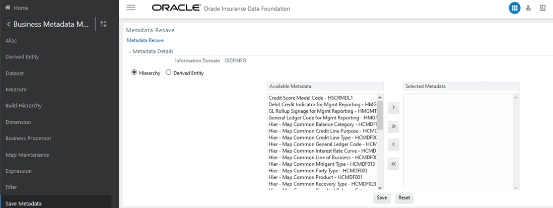

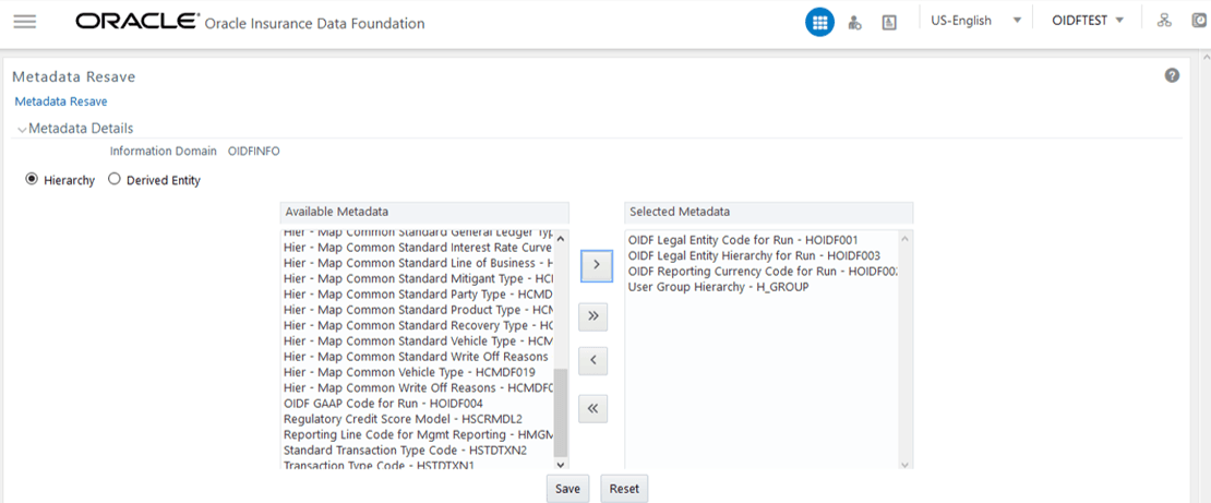

To resave the hierarchies, follow these steps:
1.     From OFSAA Home, select Oracle Insurance Data Foundation, select Unified Analytical Metadata, select Business Metadata Management, and then select Save Metadata. The Metadata Resave page is displayed.
Figure 21: Navigate to the Metadata Resave page
Title: Description of navigating to the Metadata Resave page follows - Description: This illustration shows navigation to the Metadata Resave page. This page consists of the Metadata Details section, and Available Metadata and Selected Metadata lists, and Save and Reset buttons. Perform the actions mentioned in the steps that follow this illustration.
2.     In the Metadata Resave page, to load values for the Reporting Currency parameter and the Legal Entity parameter, select the following hierarchies:
§       Legal Entity Code for Run (HOIDF001)
§       Reporting Currency Code for Run (HOIDF002)
§       Legal Entity Hierarchy for Run (HOIDF003)
§       User Group Hierarchy (H_GROUP)

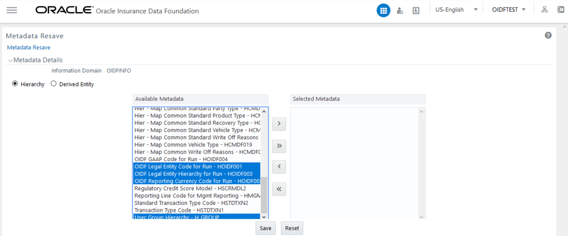

Move the selected hierarchies from Available Metadata to Selected Metadata.
Figure 22: Select the Legal Entity and Reporting Currency hierarchies
Title: Description of selecting the Legal Entity and Reporting Currency hierarchies follows - Description: This illustration shows selecting the Legal Entity and Reporting Currency hierarchies to load values into those hierarchies.
3.     To save the selection, click Save. Or to reset the details and start-over, click Reset.
Figure 23: Save the selected hierarchies
Title: Description of saving the selected hierarchies follows - Description: This illustration shows moving the selected hierarchies from the Available Metadata list to the Selected Metadata list. Then select Save to save the selection. Or select Reset to reset the details and start-over.

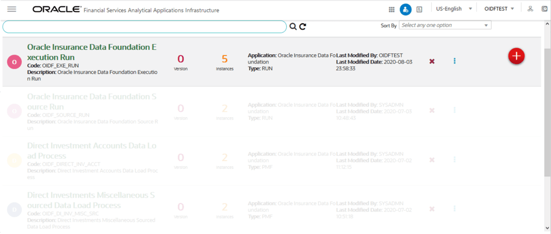

1.     From OFSAA Home, select Oracle Insurance Data Foundation, click Administration Title: Administrator icon - Description: Administrator icon. In the Information Domain list, select the information domain required for OIDF, and then click the Process Modelling Framework tile.
A submenu is displayed. Click Process Modeller to access the Process Modeler page.
§       In the following illustration, the Oracle Insurance Data Foundation Sourced Run process is shown.
Figure 24: Process Modeler page with Oracle Insurance Data Foundation Sourced Run Process
Title: Description of the Process Modeler page with Oracle Insurance Data Foundation Sourced Run process follows - Description: This illustration shows the Process Modeler page with Oracle Insurance Data Foundation Sourced Run process.
§       In the following illustration, the Oracle Insurance Data Foundation Execution Run process is shown.
Figure 25: Process Modeler page with Oracle Insurance Data Foundation Execution Run Process
Title: Description of the Process Modeler page with Oracle Insurance Data Foundation Execution Run process follows - Description: This illustration shows the Process Modeler page with Oracle Insurance Data Foundation Execution Run process.
2.     Select the Oracle Insurance Data Foundation Sourced Run process. The corresponding process flow is displayed in a page. This process flow is designed using the drawing canvas with the Tools, Activities, and OFSAA Widgets components available in the floating toolbar and with Sub Pipeline (subprocess) activity as the base. Each Sub Pipeline activity represents each of the Data Load process in the OIDF Sourced Run, and Average Balances process. The Sub Pipeline activities are executed in a series.
§       The following illustration is for the Oracle Insurance Data Foundation Sourced Run process.

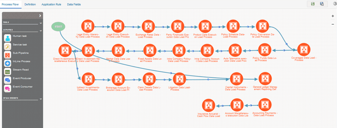

Figure 26: Oracle Insurance Data Foundation Sourced Run Process Flow
Title: Description of the Oracle Insurance Data Foundation Sourced Run Process Flow follows - Description: This illustration shows the Oracle Insurance Data Foundation Sourced Run Process Flow. Each Sub Pipeline represents a data load process in this application. These Sub Pipeline activities are executed in a series.
§       The following illustration is for the Oracle Insurance Data Foundation Execution Run process.
Figure 27: Oracle Insurance Data Foundation Execution Run Process Flow
Title: Description of the Oracle Insurance Data Foundation Executed Run Process Flow follows - Description: This illustration shows the Oracle Insurance Data Foundation Sourced Run Process Flow. Each Sub Pipeline represents a data load process in this application. These Sub Pipeline activities are executed in a series.

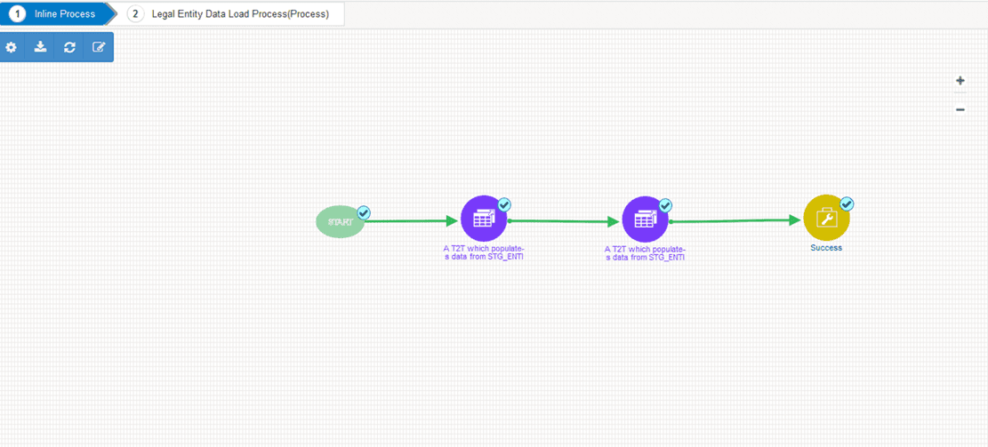

3.     Double-click a Sub Pipeline activity to see the details related to its Sub Process Details.
Figure 28: Oracle Insurance Data Foundation Sourced Run Process with Sub Process Details
Title: Description of the Oracle Insurance Data Foundation Sourced Run Process with Sub Process details follows - Description: This illustration shows the Oracle Insurance Data Foundation Sourced Run Process with Sub Process details.
Figure 29: Oracle Insurance Data Foundation Execution Run Process with Sub Process Details
Title: Description of the Oracle Insurance Data Foundation Execution Run Process with Sub Process details follows - Description: This illustration shows the Oracle Insurance Data Foundation Execution Run Process with Sub Process details.

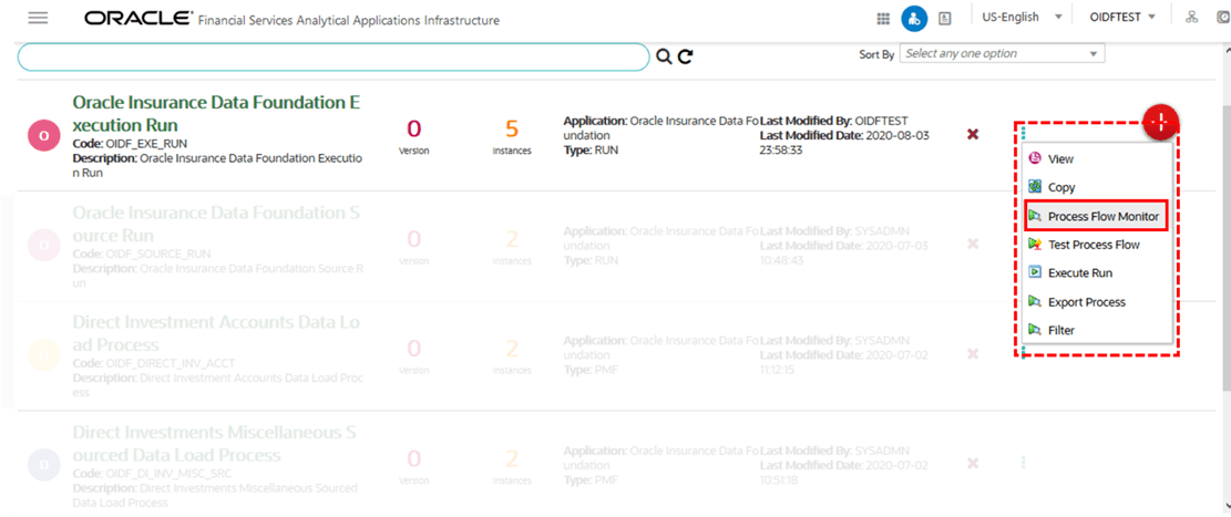

5.     In the Process Modeler page, click Title: More icon - Description: More icon corresponding to the Balance Computation Management Ledger Run process that must be executed. Click Execute Run. A Job ID is created in the Process Monitor page for each Sub Pipeline (subprocess) and every time a process is executed.
Figure 36: OIDF Sourced Run Process - Select Execute Run
Title: Description of selecting the Execute Run in the OIDF Sourced Run Process follows - Description: This illustration shows the selection of the Execute Run in the Oracle Insurance Data Foundation Sourced Run Process.
Figure 37: OIDF Execution Run Process - Select Execute Run
Title: Description of selecting the Execute Run in the OIDF Execution Run Process follows - Description: This illustration shows the selection of the Execute Run in the Oracle Insurance Data Foundation Execution Run Process.

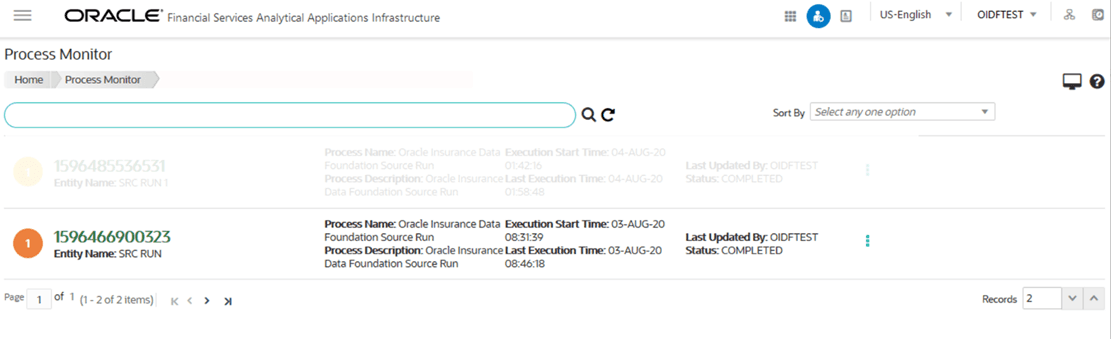

To verify the Run execution status of the Oracle Insurance Data Foundation Sourced Run process (or the Oracle Insurance Data Foundation Execution Run process), follow these steps:
1.     To open the Process Monitor page, in the Process Modeler page, click Title: Process Monitor icon - Description: Process Monitor icon or select Process Flow Monitor on Title: More icon - Description: More icon.
Figure 39: OIDF Sourced Run Process – Select Process Flow Monitor
Title: Description of selecting Process Flow Monitor in the OIDF Sourced Run Process follows - Description: This illustration shows selecting Process Flow Monitor in the Oracle Insurance Data Foundation Sourced Run Process.
Figure 40: OIDF Execution Run Process – Select Process Flow Monitor
Title: Description of selecting Process Flow Monitor in the OIDF Execution Run Process follows - Description: This illustration shows selecting Process Flow Monitor in the Oracle Insurance Data Foundation Execution Run Process.

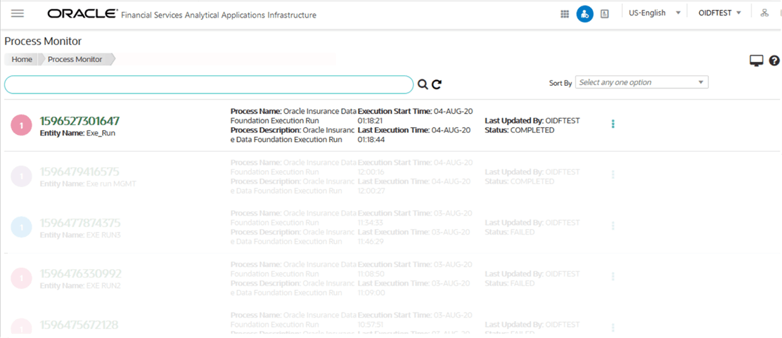

2.     The Process Monitor page opens displaying all the Run instances corresponding to the Balance Computation Management Ledger process. In the Process Monitor page, for the required Run pipeline (process) that was executed, search the Run instance by Job ID, or by the Process Name Oracle Insurance Data Foundation Sourced Run (or Oracle Insurance Data Foundation Execution Run), and select the Run process instance.
Figure 41: OIDF Sourced Run Process – Process Monitor Page – Select Job ID
Title: Description of selecting the Job ID in the Process Monitor page for the OIDF Sourced Run Process follows - Description: This illustration shows selecting the Job ID in the Process Monitor page for the Oracle Insurance Data Foundation Sourced Run Process.
Figure 42: OIDF Execution Run Process – Process Monitor Page – Select Job ID
Title: Description of selecting the Job ID in the Process Monitor page for the OIDF Execution Run Process follows - Description: This illustration shows selecting the Job ID in the Process Monitor page for the Oracle Insurance Data Foundation Execution Run Process.

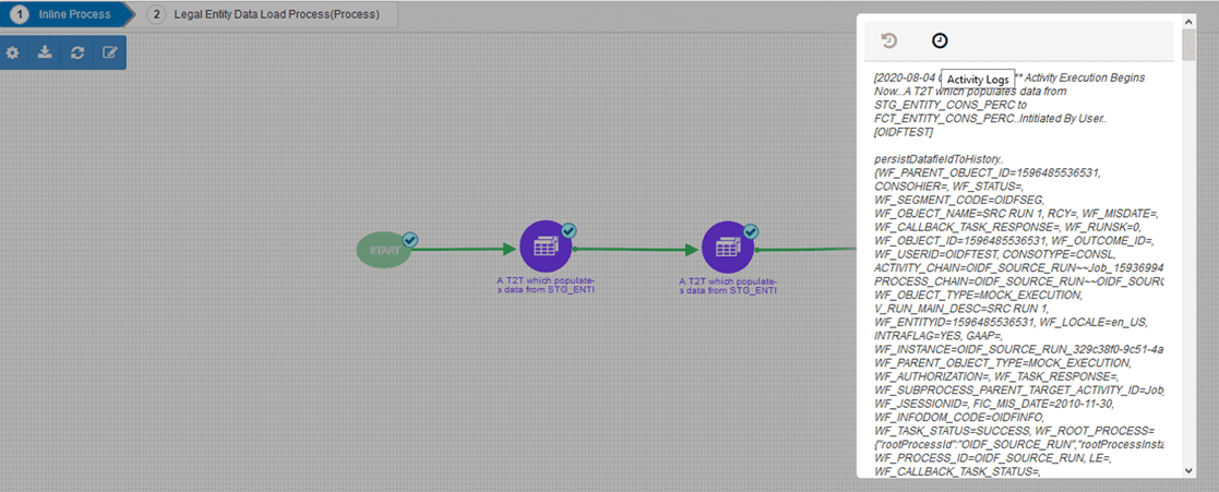

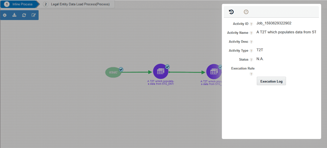

d.     To verify the execution status for a Sub Pipeline, double-click the Sub Pipeline. The execution status related to the Sub Pipeline is displayed. In this illustration, the Legal Entity Data Load Process sub pipeline is used.
Figure 45: OIDF Sourced (Execution) Run Process – Run Execution Status of the Sub Pipeline
Title: Description of the Run Execution Status of the Sub Pipeline of the OIDF Sourced or Execution Run Process - Description: This illustration shows the Run execution status of the Sub Pipeline of the Oracle Insurance Data Foundation Sourced or Execution Run Process. The tick mark indicates that the Sub Process is successfully executed.
i.       To verify the execution log of a T2T in the Sub Pipeline, double-click the required T2T widget. A page is displayed containing the Activity Definition and Activity Logs details. In the Activity Definition tab, click the Execution Log.
Figure 46: Activity Definition and Activity Logs details for T2T Run Execution in the OIDF Sourced (or Execution) Run Process
Title: Description of the Activity Definition and Activity Logs details of a T2T in Sub Pipeline follows - Description: This illustration shows the Activity Definition and Activity Logs details of a T2T in Sub Pipeline. This is displayed for both OIDF Sourced Run and OIDF Execution Run Process in the Run Execution Status of a T2T in Sub Pipeline. Select Execution Log.

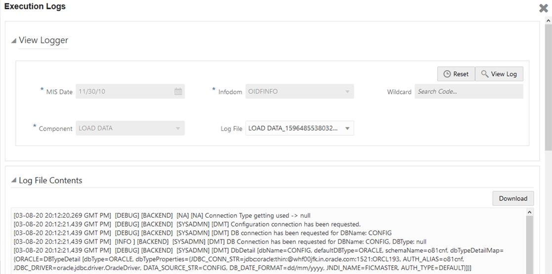

ii.     The Execution Logs page is displayed. Select the required Log File in the list and click View Log.
Figure 47: Execution Logs page c in the OIDF Sourced (Execution) Run Process
Title: Description of the Execution Logs page in the OIDF Sourced or Execution Run Process follows - Description: This illustration shows the Execution Logs page in the OIDF Sourced or Execution Run Process. Select the required Log File in the list and click View Log. The log details are displayed in the Log File Contents section. To download a copy of the log details, click Download
iii.   The log details are displayed in the Log File Contents section. To download a copy of the log details, click Download.
Figure 48: Execution Logs page of a T2T with information in the OIDF Sourced (Execution) Run Process
Title: Description of the Execution Logs page with information in the OIDF Sourced or Execution Run Process follows - Description: This illustration shows the Execution Logs page with log information in the OIDF Sourced or Execution Run Process.
The following two types of log files are generated:
    T2T.log
    T2TCPP.log
e.     In the Sub Pipeline Run Execution Status page, to see the activity log corresponding to the executed T2T, clickTitle: Activity Logs icon - Description: Activity Logs icon.
Figure 49: Activity Logs of a T2T in OIDF Sourced (Execution) Run Process
Title: Description of the Activity Logs of a T2T in OIDF Sourced or Execution Run Process follows - Description: This illustration shows the Activity Logs of a T2T in OIDF Sourced or Execution Run Process.
For information about the complete functioning of the PMF, see the Oracle Financial Services Analytical Applications Infrastructure Process Modelling Framework Orchestration Guide Release 8.1.0.0.0.
To design and execute a custom Oracle Insurance Data Foundation Sourced Run process, see the Configure and Manage Custom Pipelines for OIDF Functions section.
To check the error messages, see the log file present in the ftpshare/logs/<Run_Date>/<infodom>/LOAD DATA directory for any T2T.
Post T2T Process
When the T2T process is complete, data is populated in the Result tables.
