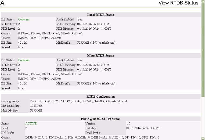

  3. From the menu, select RTDB>View RTDB Status to display status information about the RTDBs.
    Figure 4-5 shows an example.
    Figure 4-5 RTDB Status
    RTDB Status
  4. If the RTDB birthdays for both the local RTDB and the mate RTDB are the same, you can copy the mate’s RTDB to the local RTDB.
    If the RTDB birthdays are not the same, go to step 5.

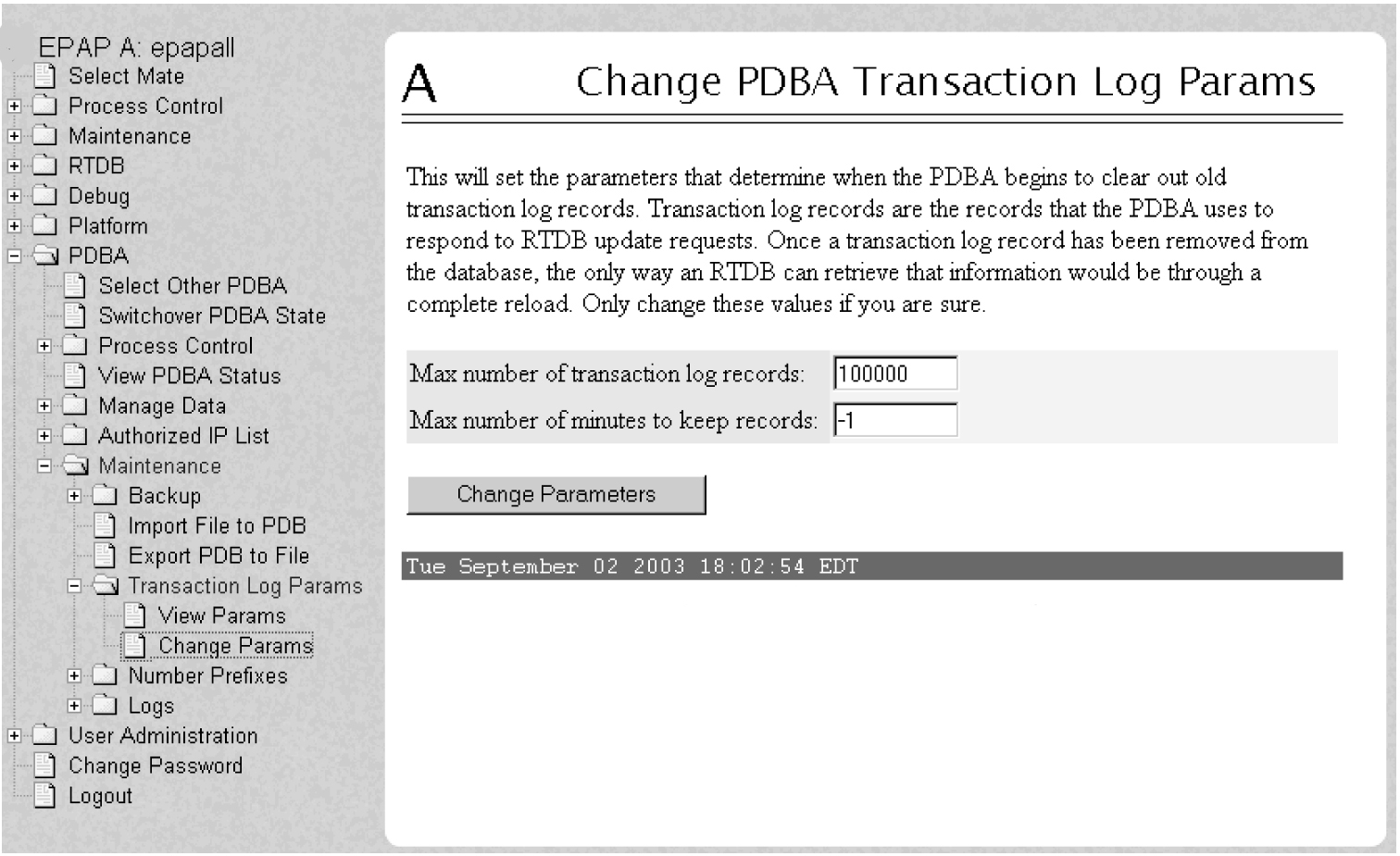

  10. If you wish to increase the size of the transaction logs, select PDBA> Maintenance > Transaction Log Params > Change Params as shown in Figure 4-7.
    Figure 4-7 Changing Transaction Log Parameters
