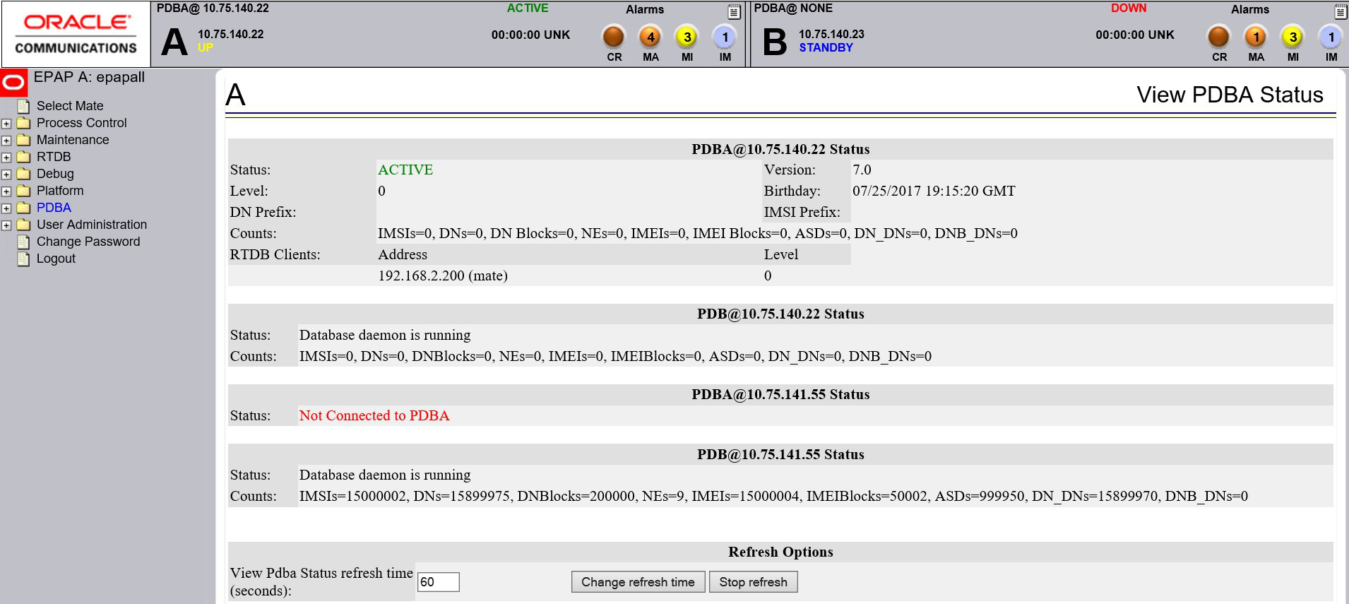

  2. Check the banner information above the menu for the PDBA status.
    1. If neither PDBA status is DOWN, go to 3.
    2. If status of one of the PDBAs is DOWN, continue with 4.
    Figure 4-8 shows an example in which the PDBA on EPAP B is DOWN.
    Figure 4-8 PDBA Down
    PDBA Down

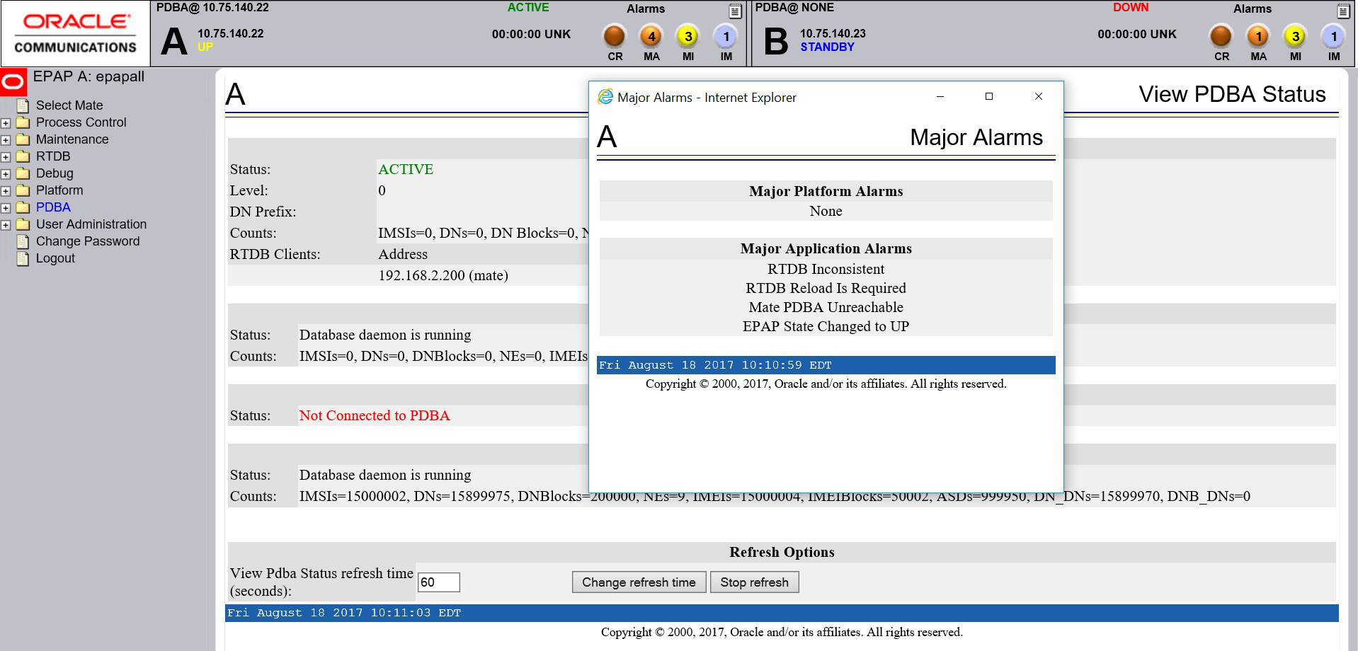

  3. View Tool Tips to verify the alarm and to verify that you are logged into the EPAP whose PDBA is DOWN.
    Figure 4-9 Alarms Details
    Alarms Details
    If it necessary to switch to the other PDBA, select PDBA>Select Other PDBA.
